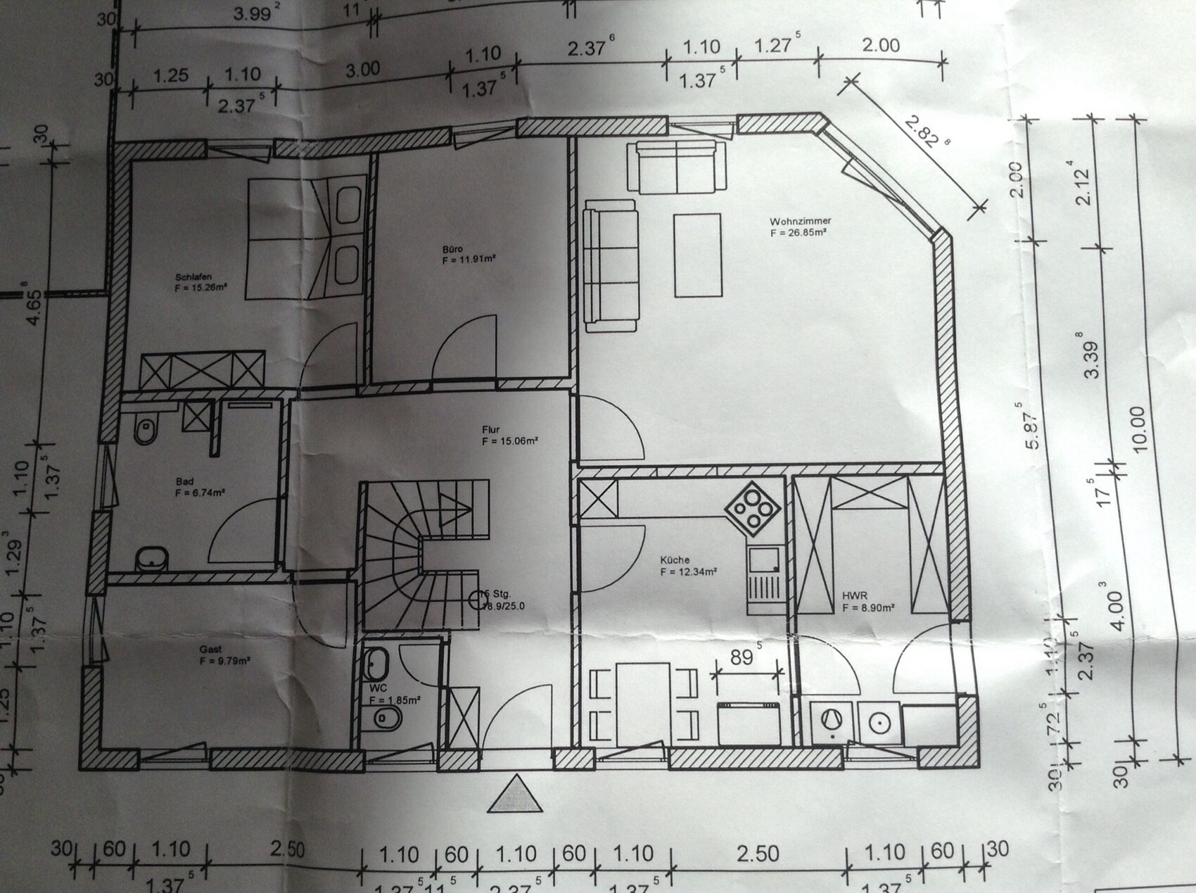

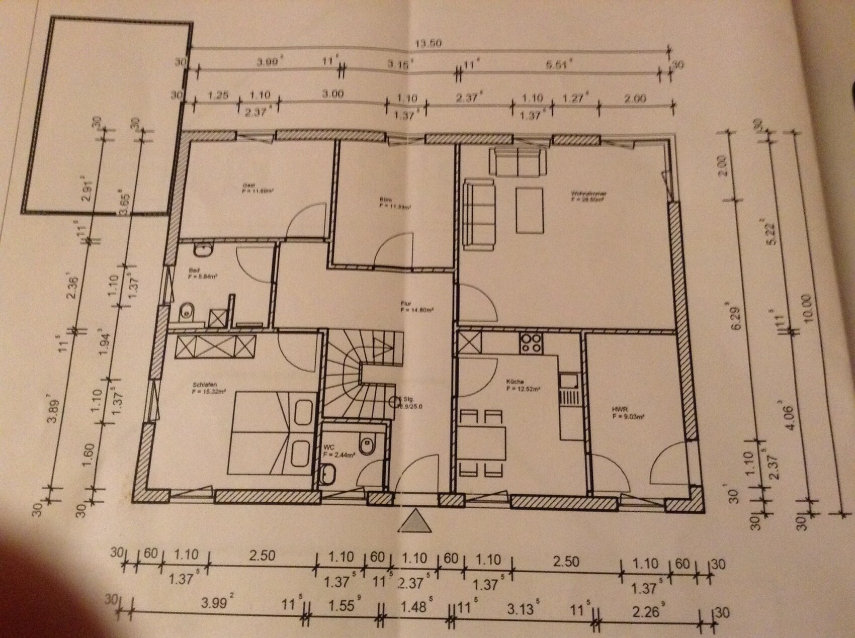

We received a floor plan from the general contractor that we are basically satisfied with. However, we don’t like the position of the bungalow on the plot. We think the house is placed too centrally, which results in a lot of garden space wasted on the south side. We would like to move the house further north (3m (10 feet) from the boundary). But then the double garage no longer fits. Therefore, we need your help.
Maybe the floor plan needs to be changed after all?

About the floor plan... a first impression... I like the small hallway area, but a closer look suggests that all rooms are probably smaller than the desired sizes.
Unfortunately, more detailed measurements are missing.
I would also position the fireplace more toward the living area, behind the hallway door.
I would leave out the vestibule door, as it only makes everything feel cramped.
The utility room will likely also house the building services equipment... this room particularly needs careful review to ensure everything planned will fit and that there is enough space to move through.
In the floor plan, the house is set back about four meters (13 feet) behind the garage front, but in the site plan it is only about two meters (6.5 feet), which would eliminate the window in the guest room. For a 3-meter (10 feet) setback from the property line, it could even be approximately 1 to 1.5 meters (3 to 5 feet) in front of the garage front (which would also mean no window for the bedroom).
What do you expect us to do to resolve this?

Let’s start from the outside. Let the garage extend slightly at the back and add a back door with an external power outlet facing the lawn mower parking area. We’ll also mount the satellite dish on a galvanized pole attached to the garage. If it ever needs maintenance, no one has to go onto the roof. This way, the building naturally ends up closer to the street.
Inside, we separate the parents’ playroom from the children’s and guest areas and move it to where the single children’s room is now. Then we try to place the kitchen and utility room together on the north side, since the utility room—with washing machine, pantry, sink, and similar—belongs next to the kitchen. Countless farm buildings prove this right. The utility room will be on the outside. I consider a double garage a waste of space and money. A second car should be able to park outside in front; the utility room will have a back door for visitors with dirty shoes. I’m attaching our non-rectangular 110 layout. You can imagine adjusting it with an angle, since you want two children’s rooms plus a guest room, so you’ll need one more room than we have. Karsten.
Alternative bedrooms on the north side, nicely cool.
