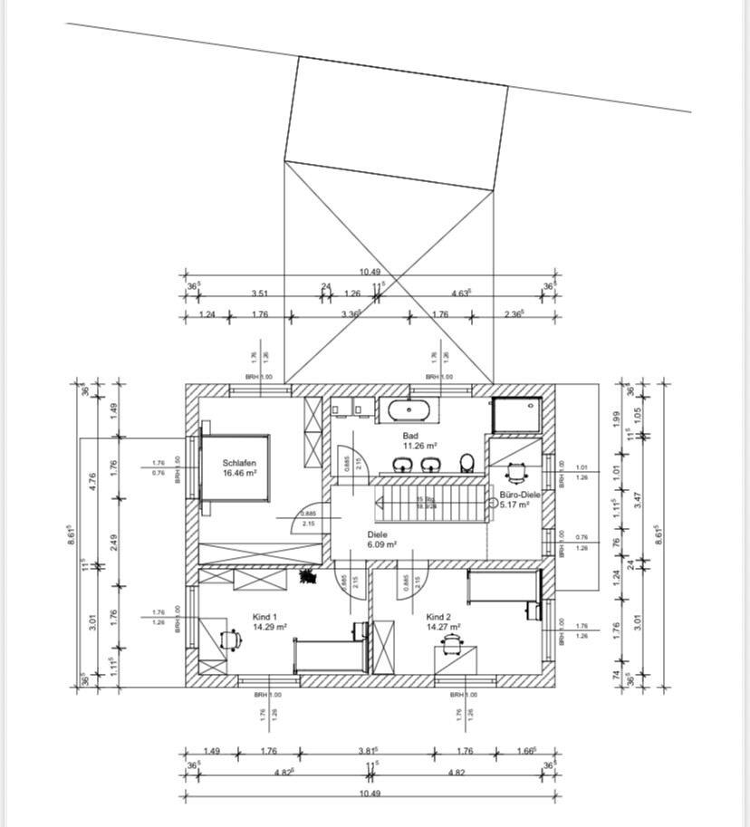

The upstairs bathroom is somewhat elongated due to the narrow building footprint and straight staircase. The washing machine and dryer are shown upstairs and are planned to be there. There are also connections in the utility room. Otherwise, the space upstairs or downstairs will be used for storage.

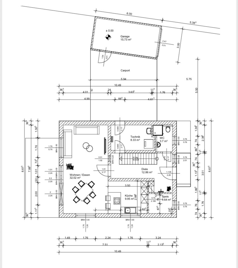

Space requirements for stairs: Straight staircases in small houses are always criticized here. A single-flight straight staircase has to be affordable for a house, and a “small” house can’t afford this. To risk repeating myself: this shape of staircase is first of all a bottleneck for any floor plan and requires (similarly to symmetry, but together even more) about twelve meters (39 feet) of house width on every affected floor (in the attic, therefore, approximately between the 2m lines). Develop a good staircase from the upper exit going backward; this way it will most reliably find place and shape.
I see here a plot that fans out (and its building envelope does this as well, but the floor plan does not). So the complained-about too-narrow bathroom could be avoided. What is the nonsense of ignoring phase 1 and starting right away with “designs” that are just as useless as the others (and this could continue in the forty-seventh iteration)?

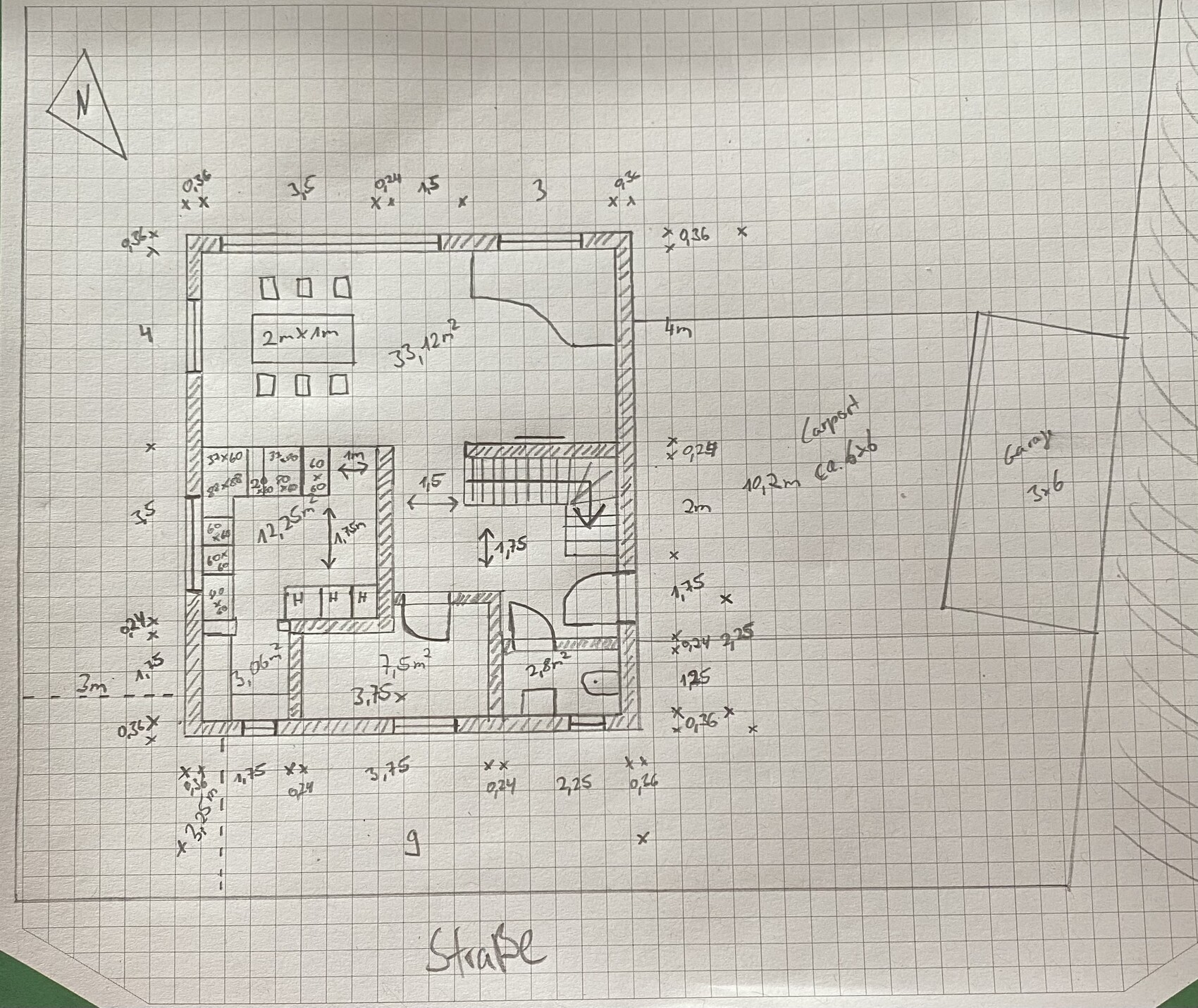

Milka01058 Jul 2025 10:16So, I just took some time to think everything through again. I still like the floor plan.
However, I tried to incorporate your suggestions into a different layout. I drew it myself, just so you know.
For now, I only drew the ground floor. My question is: does the floor plan work like this?
The entrance area is only 1.75 meters (5.7 feet) wide, and right after entering the wall appears at 2.25 meters (7.4 feet). It might feel a bit cramped, especially combined with the staircase.
I also looked at other posts and included a rotated staircase to separate the entrance area from the dirty zone.
Does anyone have experience with a layout where the stairs are immediately visible on the right upon entering? Does it feel tight? Or could that even be turned into a great coat and shoe storage area? Because I currently lack a proper cloakroom in the floor plan.
The hallway does not really offer any additional space for furniture or storage.
The guest toilet is small but should be feasible. I have not drawn anything in the utility room yet; that should be checked later for actual feasibility.
The passage to the living/dining area is only 1.5 meters (4.9 feet) wide and also serves as the access to or from the staircase. Does that work? According to the configurator, I drew the staircase as 3 by 2 meters (10 by 6.5 feet) with 15 steps, a tread depth of 25.2 cm (9.9 inches) and a riser height of 18.9 cm (7.4 inches). I would really appreciate your feedback on this as well.
The kitchen is now larger, 3.5 by 3.5 meters (11.5 by 11.5 feet). The pantry remains because I want a storage room!
I would only give that up for a bigger utility room if the utility room does not work as it is.
Otherwise, the table with chairs and the sofa we own and plan to keep are drawn with the correct dimensions.
The house now has overall dimensions of 10.2 by 9 meters (33.5 by 29.5 feet).
The previous floor plan was 10.49 by 8.74 meters (34.4 by 28.7 feet), so the same footprint is maintained.
All interior walls are 24 cm (9.4 inches) thick. Some might be changed to 11 cm (4.3 inches) thickness. In the end, this would only enlarge some rooms a bit, so I planned for the worst case.
A north arrow is included. I hope I considered everything and am open to criticism. Thanks!

wiltshire8 Jul 2025 10:32Without seeing the upper floor, I can’t properly assess this.
It’s great that you included the kitchen in the plan. A 1m (3 ft 3 in) walkway would be too narrow for me. The smaller the kitchen, the more important it is to get help from an experienced kitchen designer.
Thinking radically: the partition wall between the hallway and kitchen is dispensable. Consider how it would be to have more countertop space instead of that wall. The whole kitchen feels more open.
If I understand correctly, the utility room becomes slightly smaller, and the "mudroom" function for entering with a wet dog or boots is lost in the new design.
I still prefer the first design, but I wasn’t really a strong critic anyway.
