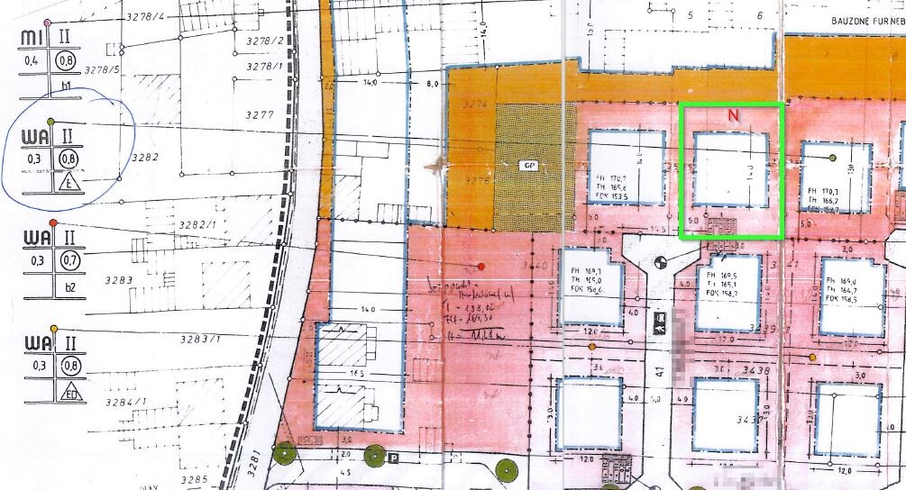

Plot size 477 m² (5,134 ft²)
Slope No
Site coverage ratio 0.3
Floor area ratio 0.8
Building envelope, building line and boundary 14 x 14 meters (46 x 46 feet)
Setbacks South/North 5 m (16 ft); East/West 2.50 m (8 ft)

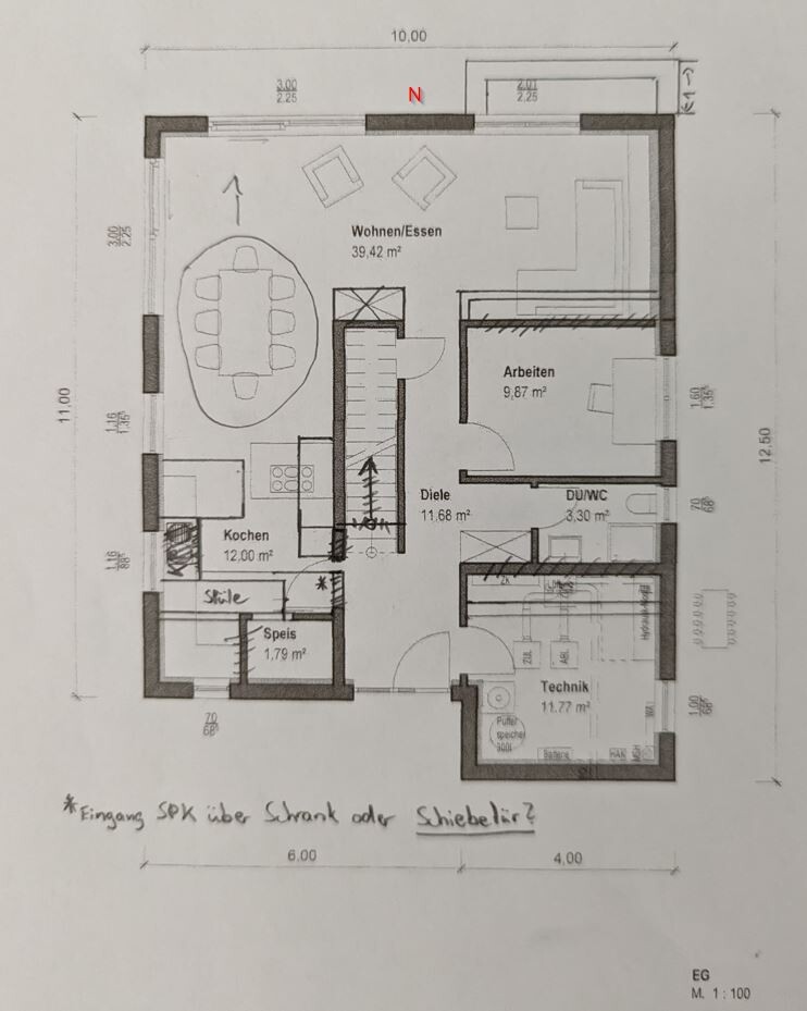

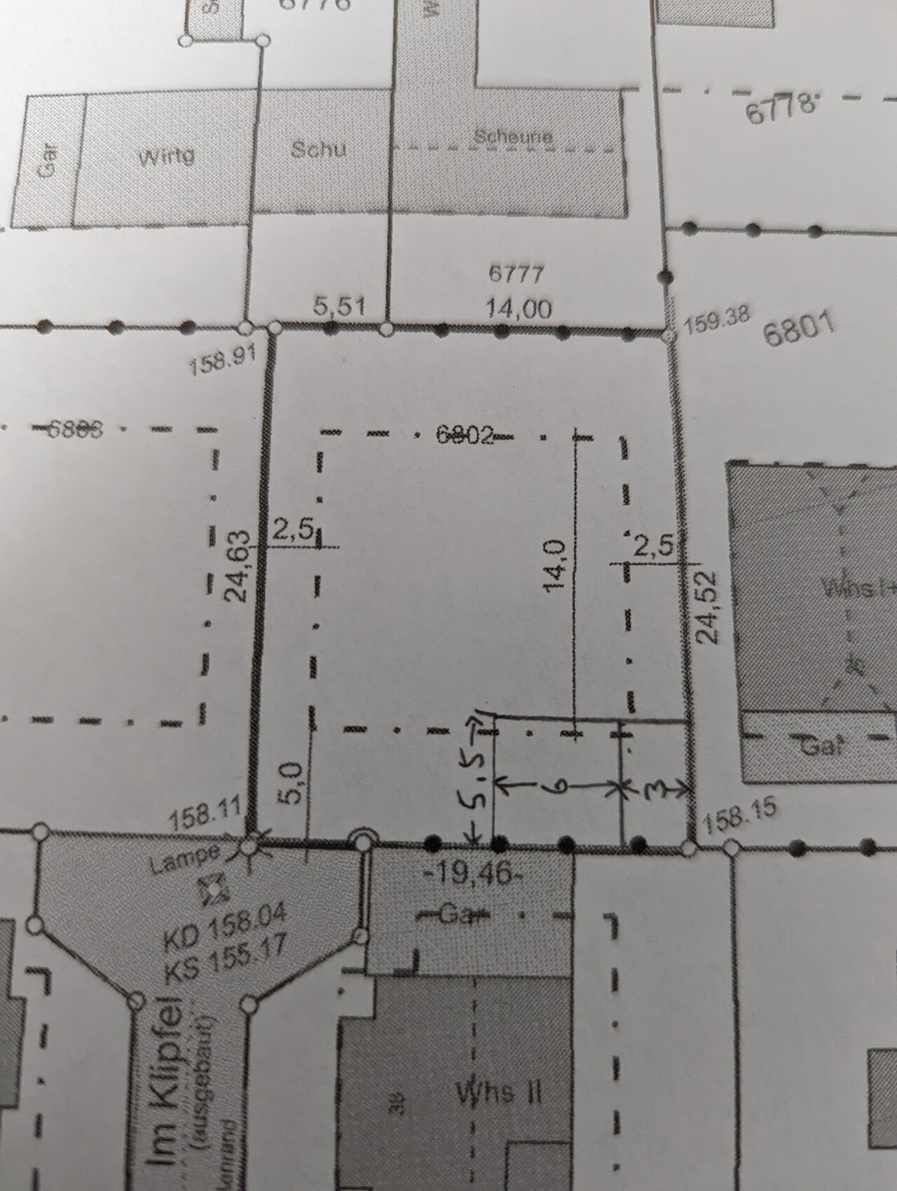

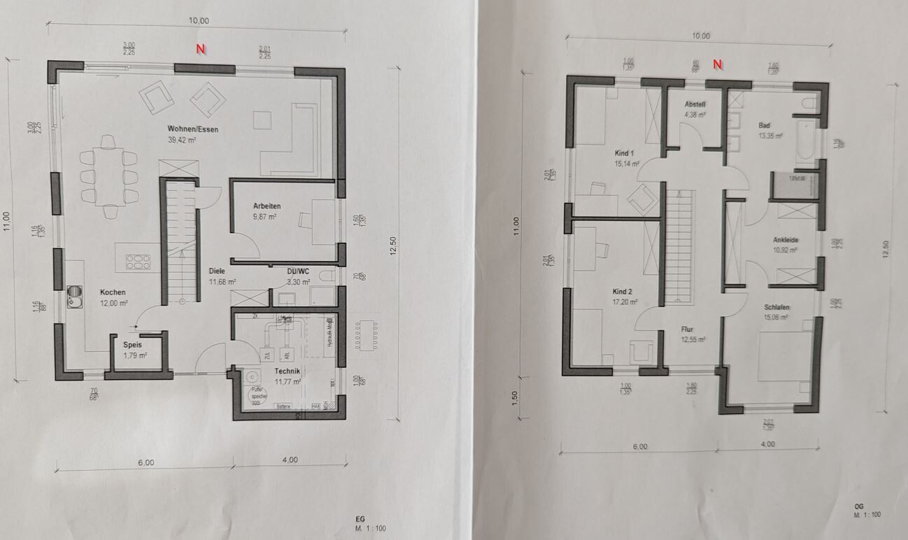

The carport is planned as a double carport on the south side adjoining the recess of the utility room. It is intended to be 5.5 m (18 ft) wide x 9 m (30 ft) long, including a storage room with a length of 3 m (10 ft). Is the planned width sufficient for two cars side by side assuming no SUVs? We plan to use a station wagon like a Skoda Superb and a small car such as a Mercedes A-Class or Toyota Leaf.
The carport positioning is planned as follows:
The house itself would be pushed fully to the eastern building boundary to maximize the western garden area.
The current floor plan from the architect looks like this:
We have already considered some optimizations.

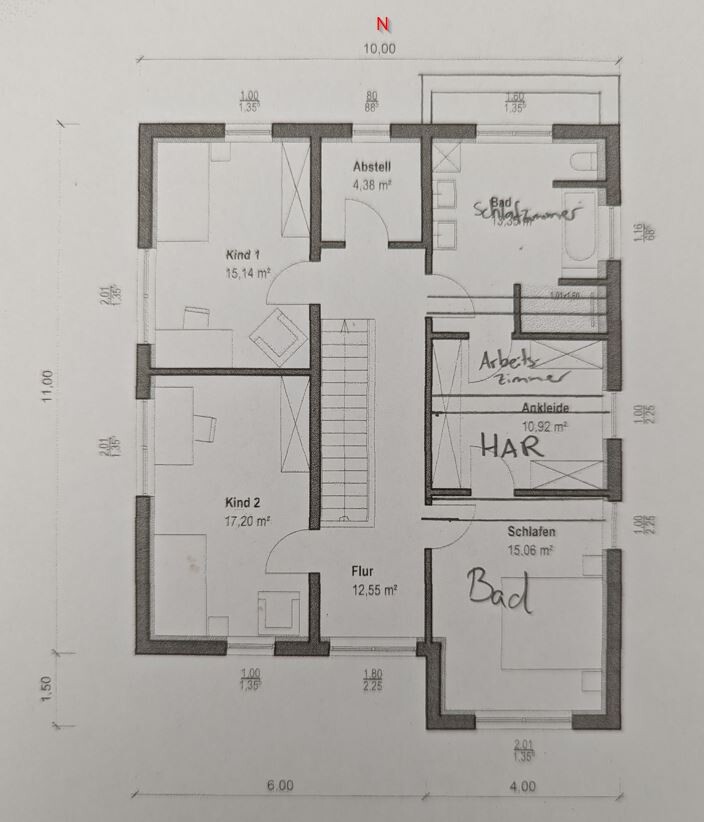

Central to our considerations is adding a second recess on the north side where the living room is, measuring 1 m (3.3 ft) long and 4 m (13 ft) wide, and including a laundry room on the upper floor to house washer and dryer.
This would allow reducing the size of the utility room on the ground floor significantly. We would shorten the utility room by 0.7 m (2.3 ft), leaving about 9 m² (97 ft²). The freed-up space would benefit the guest WC, guest room, and living room.
In the kitchen, we would like to extend the pantry fully along the wall and place the kitchen before it. We have tried to mark our ideas on the floor plan:
Is the kitchen large enough for a household of 3 to 4 people? An island solution will probably be difficult to realize, right?
Upstairs, the gained space from the recess would be used for the laundry room. In the plan shown below, we placed the study next to the laundry room; however, we have reconsidered and now prefer to position the work corner where the storage space currently is. The work corner doesn’t need much space, primarily just a desk about 1.60 m (5.2 ft) wide. If there is room for a small cabinet, that’s nice but not essential. Where we marked the study, we would instead plan a walk-in closet. Unfortunately, we have not found a better location for the work corner. We also considered moving it near the children’s rooms, but then the child bedrooms would probably become rather small (about 12–13 m² / 130–140 ft²). These will definitely be adjusted to the same size regardless.
Maybe you have some ideas.
The windows on the ground and upper floor are not finalized yet; these are currently placeholders.
We welcome all comments 🙂.

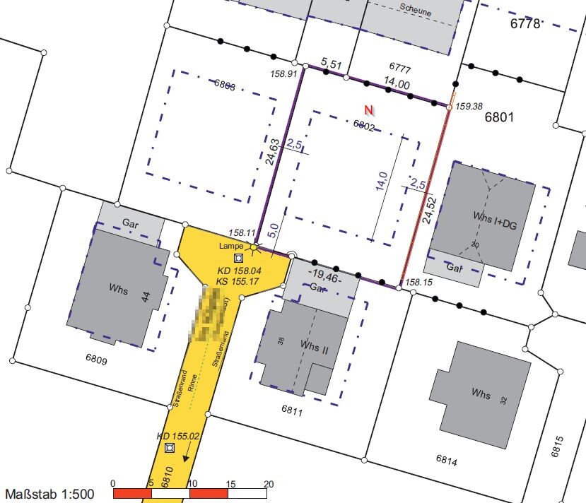

SandyBlack6 Jun 2022 23:11K a t j a schrieb:
Yes, if I were planning my dream house for half a million, somehow yes. But it’s always relative. In a house with a footprint of 9x8 meters (30x26 feet), it would be perfectly reasonable. But not at your size. Also, the width should not be considered independently from the length of the room. The tunnel feeling when entering the room feels uncomfortable and also wastes space. I understand that argument. We’ll have to reconsider it.
K a t j a schrieb:
Calling the strips of land on the left and right side of the house a garden – okay, you’d have 6.5 meters (21 feet) if you build far to the east. That’s not nothing, but I wouldn’t plan a terrace there. Whatever the neighbor says, I would assume that a house could be built to the west. Well, honestly, we planned a corner terrace in the west/north corner. We know that 6.5 meters (21 feet) is not much. But we don’t see a way to create a significantly wider garden — except to the north. Although even there, the maximum will probably be around 8 to 9 meters (26 to 30 feet). So the garden will be rather long than wide — not ideal, but as I said, we don’t really see another option.
K a t j a schrieb:
Did I miss something? Sorry, I made a mistake. I meant there is always shade in the north and sun in the west until late in the evening.
K a t j a schrieb:
Yes, it’s problematic in the hallway if Mom and Dad constantly have to step around the Matchbox cars. What for? Scrolling on the phone is fine, but I don’t see how you can fit a slot car track in there. That’s true.
K a t j a schrieb:
Of course, a west-facing garden would be nicer. The question is, when does a garden start and where does a strip of greenery end? If the western part of the plot remains undeveloped for a while, you could consider planning a terrace there. Basically, I would assume the terrace will end up in the north – simply because the space right next to the garden fence with 2.5 meters (8 feet) to the neighbor wouldn’t be very private once something is built there.
To be more specific: I would always plan my house so that the contiguous garden area is as large as possible, to have a nice green space around the terrace and maximum distance to all neighbors. But I admit that with 477 square meters (5130 square feet) and a north orientation, this is debatable. 😀 Our plot isn’t large. We always struggle with the fact that it won’t be very private. But on the other hand, if I look at new developments, it can be even worse there 😉. If we had 6.5 meters (21 feet) of garden to the west and a terrace 3 meters (10 feet) wide, for example, there would still be 3.5 meters (11 feet) of distance to the neighbor’s fence. Not great, but honestly, if the terrace is only to the north, we would really miss the sun.
SandyBlack6 Jun 2022 23:17ypg schrieb:
Personally, I would probably build on the eastern side and make full use of the 14-meter (46 feet) length more or less. But wouldn’t that mean the garden would be on the west and north sides?
Or completely to the north in a transverse layout. Then make the house as narrow as possible. You really have to put a lot of passion into the planning! You probably won’t be happy with a standard design on the fly. Could you please explain what you mean by that? Where would you place the driveway then?
There is a related thread by @Samsonite who has almost the same issue with a similar orientation. Thanks for the tip, I’ll check that out.
SandyBlack schrieb:
and in the west, there is sun until late in the evening.
If there is a house there, there is exactly zero sun. The sun sets in the west and is low on the horizon – don’t forget.S
SandyBlack6 Jun 2022 23:47That’s true. A house would block a lot of sunlight. However, there is generally little sun in the north, and creating a garden on the south side is challenging due to the two parking spaces we want to have side by side.
Here is a user report about having a north-facing garden.
I grew up in a house with a north or north-northeast-facing garden (the ridge roughly aligned west-east, just slightly rotated). The first about 4 meters (13 feet) from the house actually receive no sunlight. After that, it depends on the season, but in summer, there is usually constant sunlight behind that. First because the sun is so high in the sky, and then because it moves westward past the house. I believe there is a short period when the house actually blocks the sun. The clear advantage of a north-facing terrace is definitely that you can avoid unwanted shading.
Of course, it also always depends on the neighboring buildings. If there is a house blocking the west side, obviously no sunlight will get through there.
