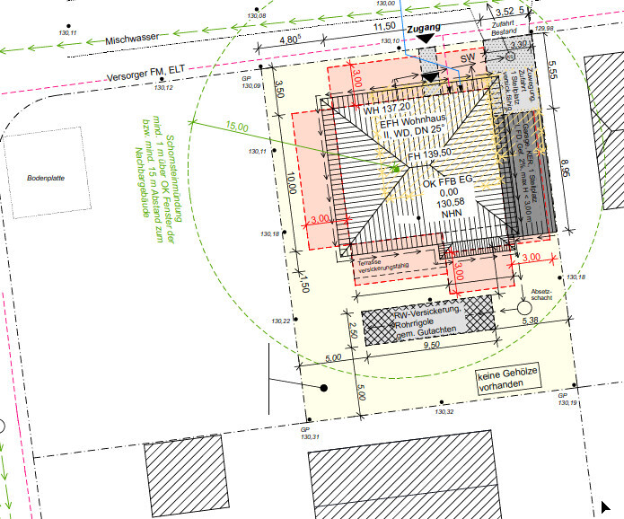

Yes, of course, it depends on how much budget is really available, but with an investment of this size, I would expect a bit more personal input. Some fundamental questions should be clarified first. The first one is immediately: why is the garage located on the west side? Blocking out the evening sun is quite unusual. What does the plot look like? Are there mandatory reasons in the zoning plan / building permit regulations, etc.?

The first question is immediately why the garage is on the west side.Originally, the garage was planned on the east side. Only recently did we think that the view to the east is better than to the west. But fundamentally, it’s not mandatory. kaho674 schrieb:
What is the plot like?See attachment kaho674 schrieb:
