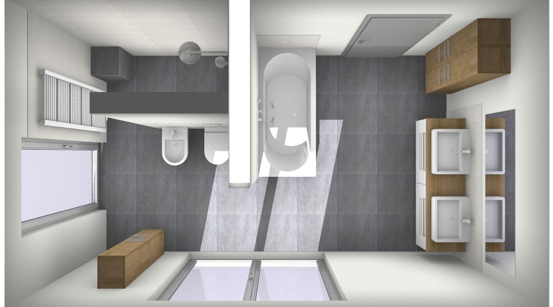

Now I am completely frustrated. My previous changes thanks to your input: mirror the house, upstairs: child's room now facing south, bedroom facing north. But no continuous walk-in closet. Maybe one that provides access to the bathroom. Well, the upstairs can still be improved. But what about the ground floor? I am thinking of placing the kitchen unit on the right wall of the mirrored current living room, then the island, and finally the dining table. The current kitchen will become a cozy lounge room. We already have a TV but have no time or desire to sit in front of it. The fireplace stays where it is. The hallway still isn’t attractive and I have no plan for it yet.
haydee schrieb:
Any progress?The appointment with the architect is on Wednesday. Today, we visited the bathroom showroom and received a beautiful bathroom design. We really like it. We’re also going to the kitchen showroom today to have both versions visualized. Honestly, I can’t really imagine 2D plans in 3D. Similar topics
