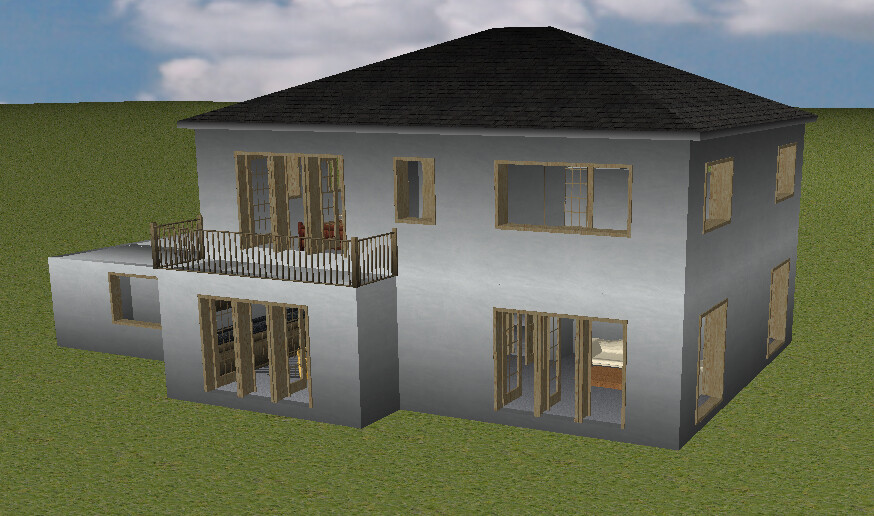

In my opinion, the situation would improve significantly if the dining bay window is widened to 5.2 m (17 feet). This likely wouldn’t be a dealbreaker for the budget. Additionally, the windows should be adjusted, the utility room enlarged, and the guest WC and guest room optimized. The layout could then look something like this:
It should be noted that this would be a true eat-in kitchen—meaning a kitchen with a dining table integrated, without a kitchen island or extra features. Personally, I like that. It can be very cozy, but you have to want it. In return, the living area is more spacious. I shifted the living room doors forward a bit to at least create a small cozy corner. However, placing a TV there is difficult—though according to the original poster, that’s not important…?!
If it were mine, I would put cooking and dining at the front and the relaxing corner toward the upper right, which is what most people here seem to prefer. Fundamentally, it’s questionable whether the terrace facing southeast is a smart choice. Wouldn’t you expect more of a southwest orientation?
The upper floor needs to be revised. The typical and already shown option would be to have the children’s bedrooms facing south, as already sketched here:
Whether exactly in this form is still open for discussion.
But if you’re going to build such a bay anyway, I think it makes sense to use it as a balcony for the bedroom. Shaking out the beds outdoors or hanging them over the railing is a nice added benefit. This way, the son would also have a view of the street:
Currently, the exterior views are truly a disaster. Granted, it’s tricky in some places. But a little more symmetry wouldn’t hurt a townhouse. Here are the elevations based on the above suggestion:

I really like this! There is space for a built-in closet in the dirty area of the hallway, followed by a nice, clean hallway. It’s a pity there are no floor area details, but it doesn’t look as large as before and appears more square. You’ve reserved space for a large wardrobe in the guest room, which is great! The idea of widening the bay window is also brilliant, and I like the niche for the kitchen island as well.
On the upper floor, the walk-through wardrobe bothers me a bit. Everything else is a great solution. Unfortunately, we can’t afford a balcony, which was estimated to cost 10,000.
