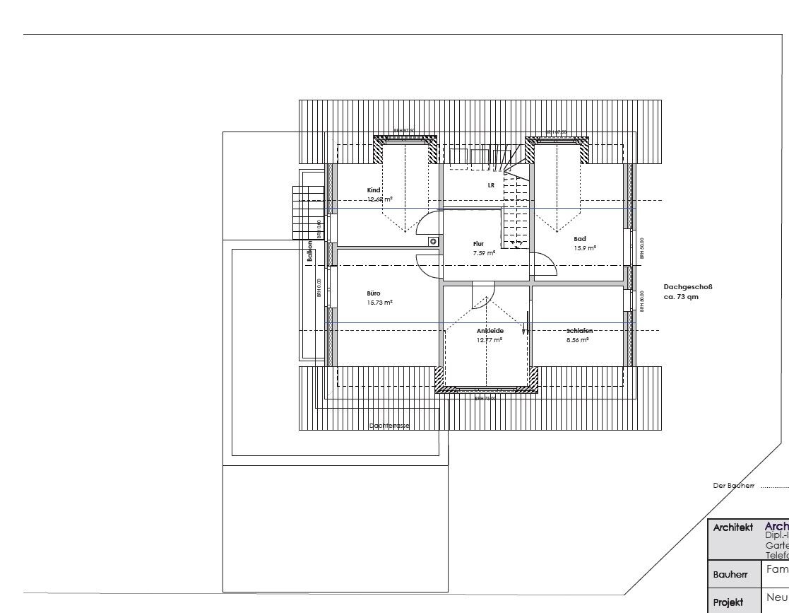

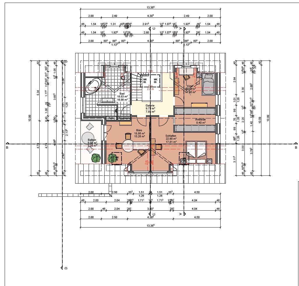

Guido198020 Aug 2019 22:29Currently, there are two options to choose from in the house design:
Option A with an internal/covered balcony at the expense of the living space in the attic
Option B with an external, uncovered balcony
Which option would you prefer, and what are the advantages and disadvantages? (This question is not about room layout or anything else, solely about the balcony design)

thank you very much for your suggestions.
The floor plan requires that the balcony is positioned in front of the office. Since I work from home a lot, the goal is to be able to use the balcony for working as well.
This would generally argue in favor of a covered balcony, as it offers more protection from wind (blowing leaves, wind noise during phone calls) and the shading allows better conditions for working on a laptop.
Also, you are not so exposed to view.
The terrace is less suitable for this because the walk to the office would be longer, and there will likely be more activity on the terrace than on the “secluded” balcony area.
On the other hand, sacrificing living space to gain a balcony is not ideal and, in my opinion, outdated.
The advantage of the exterior balcony is that you can use the full attic floor as living space and the balcony could be used for sunbathing; however, in practice, this will probably not happen often since the terrace is preferable for that.
Then you have to ask whether the balcony is necessary at all if it can only be used to a limited extent for working and otherwise has no real purpose, because due to its dimensions, it cannot serve as shading or roofing for the terrace below either.
How would you roughly estimate the cost or potential savings for an exterior balcony including railings?
Leaving out the ground floor is not an option because too much living space would be lost. Also, with the two-sided terrace orientation to the south and west, there is a good chance to find a shady spot. Alternatively, a roof, awning, or parasol!
