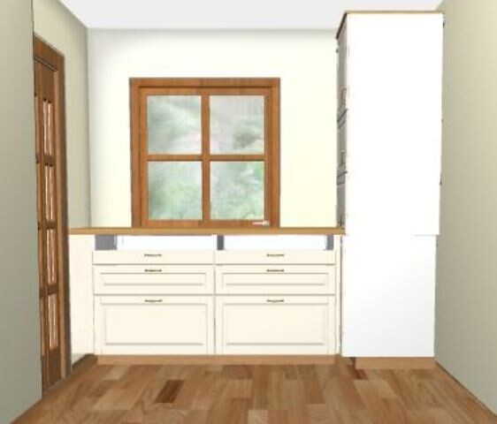

Under the window, the height to the bottom edge of the windowsill is about 83cm (33 inches).
Because there is a door on the left, I only have 57cm (22 inches) rough structural depth. The old door frame will be removed.
We will install a sliding door. The passage inside will be plastered generously, allowing me to gain a few centimeters (inches) of depth on the window side.
There, starting from the right, I want to install a filler panel to maintain clearance on the left side for opening the sliding doors. Then, two 80x60cm (31x24 inches) base cabinet carcasses will follow.
About 17cm (7 inches) of clearance will remain in the left corner for a filler panel.
We want to reduce the height of the carcasses by 10cm (4 inches) and, if possible, also reduce the depth.
The countertop depth will also be reduced (hence the 10cm (4 inches) gap shown in the image).
At the corner door, the sliding door finish will be integrated into the countertop, minimizing any overhang into the door opening.
I want to install drawers in the carcasses.
IKEA offers Maximera drawers in depths of 37cm (15 inches), 45cm (18 inches), and 60cm (24 inches). I would prefer the 60cm (24 inches) deep ones.

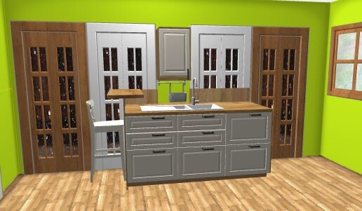

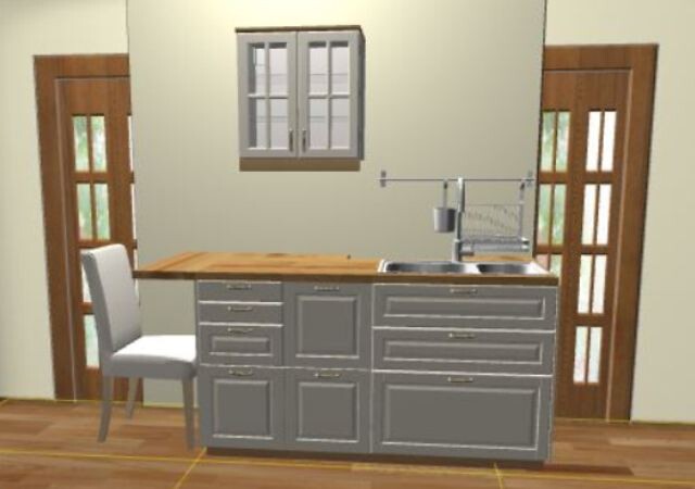

A brief look at the sink island:
The partition wall hides the sliding doors. There is space in the middle to reach the plumbing as desired.
The island will be 80cm (31 inches) deep. Beside the regular cabinets, narrow cabinets will be installed on each side – 20x60cm (8x24 inches) on the left and 20x40cm (8x16 inches) on the right, shortened to fit.
