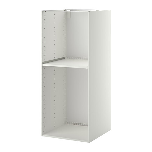

Hi,
is it possible to fit this washing machine
into a similar
cabinet, so that a refrigerator could be placed on top and the washing machine below?
The same question applies to this cabinet
could you fit an oven, a microwave AND a dishwasher from IKEA in the lower section?
My new kitchen is unfortunately quite narrow and the washing machine has to be in the kitchen because of the only water connection. However, if it were possible to arrange all these appliances inside two tall cabinets, that would help me a lot.
into a similar

robi_aus_ffm3 Sep 2015 02:22What you could also do, of course...
if you have the washing machine below with a worktop, build this cabinet on top of it and fix it to the wall.
Without feet.
Place the refrigerator there, and make sure to consider ventilation at the bottom (for example, like in one of my pictures in the thermo cabinet). You will also need to attach another shelf from a standard cabinet on top and cut out ventilation at the top, then it fits. Just an idea...
You could do the same with the dishwasher and install the oven and microwave in the cabinet above in a similar way.
Best regards, robi
Without feet.
Best regards, robi
