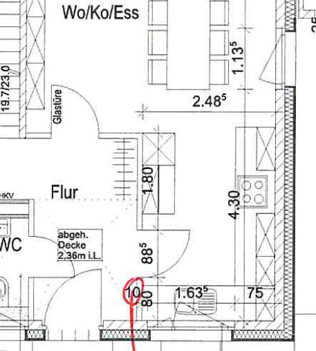

I was just writing a post out of boredom on the train, but I don't have the original plan with me right now. The door is planned to open in the opposite direction:
2D floor plan of an open living, kitchen, and dining area with hallway
(the number 10 in brackets is irrelevant; they mentioned that a 15cm (6 inches) wall thickness might be needed, but apparently not)
Disadvantage: it could be annoying in the kitchen. Advantage: less awkwardness in the hallway.
Ideally, I would prefer a sliding door recessed into the partition wall. But well, the standard door option is clearly much cheaper for us (and maybe the other option would have complicated the electrical planning?). If it ends up being really annoying, we’ll either remove the door or replace it eventually with a folding sliding door or something like that.
18 Jun 2023 14:57
A sliding door in a partition wall takes up a lot of space. In a hallway, gaining 20cm (8 inches) or less makes a significant difference.
A sliding door is also not always easy to open or close, whereas a hinged door can be simply pushed shut.
In most cases where a sliding door is planned, I would advise against it. Most people choose them because they are trendy… just like recessed ceiling lights. A sliding door can make sense, but only if it is designed according to the access points.
mayglow18 Jun 2023 15:09
A sliding door in a partition wall takes up a lot of space. Gaining 20 cm (8 inches) or less in a hallway can make a big difference.
I meant something that is recessed into the drywall partition, instead of sliding in front of the wall. That way, you barely lose any wall space in the hallway, and usually the drywall partitions don’t have to be significantly thicker (these systems are available starting at 10 cm (4 inches) wall thickness). But yes, it’s not a perfect solution and would definitely be more expensive than the standard door our builder offers anyway. (I only looked it up quickly for a first impression, didn’t request any quotes.) So, we considered it but eventually dropped the idea. Having the door slide in front of the wall was not an option for me either.

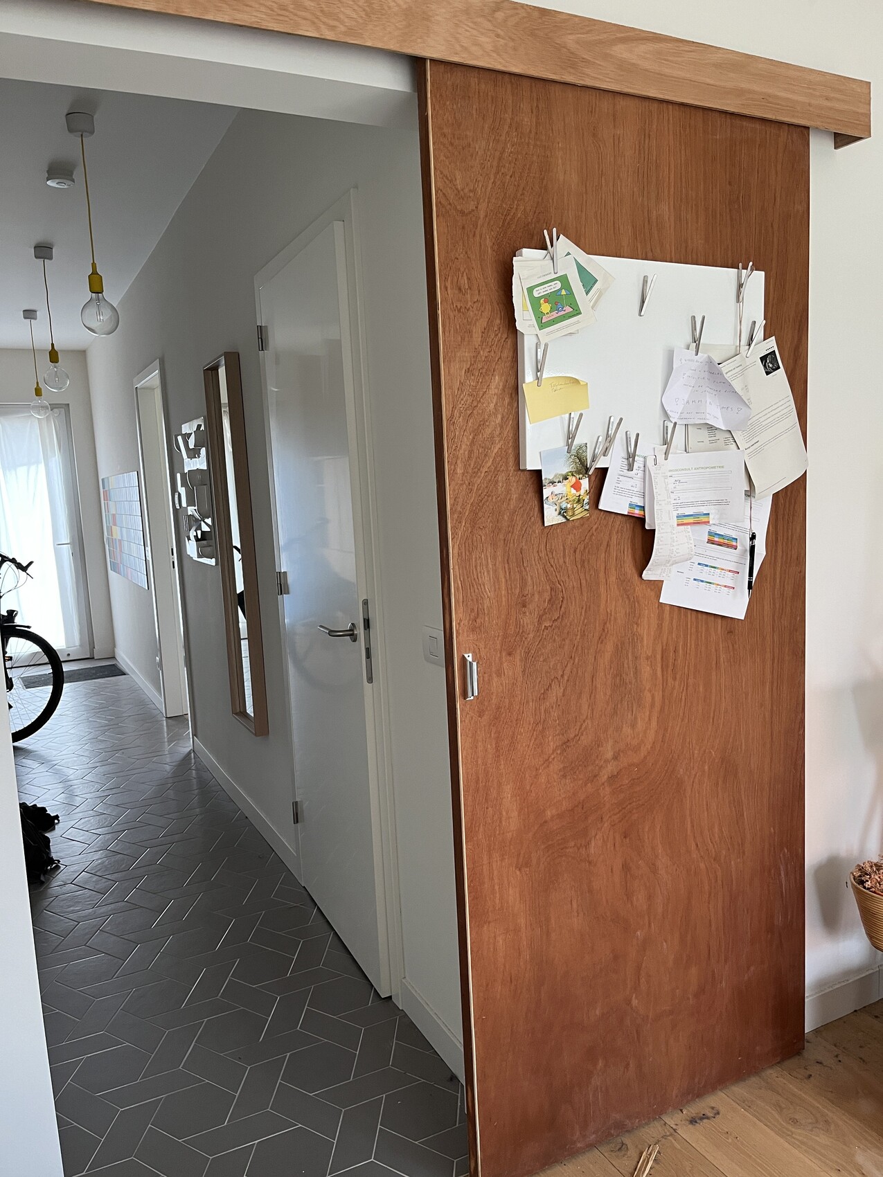

Bertram100
18 Jun 2023 15:17
If a sliding door in front of the wall isn’t an option, then a hinged door is the alternative. Personally, I would much prefer a sliding door over the current plan you have. But of course, that’s a matter of personal taste.
My sliding door actually cost more than a hinged door, but not by much. I had it installed afterwards at my own expense by a carpenter.
This is what it looks like from my dining area. There are nicer options, but I don’t find it bad either.
Bright hallway with gray tiled floor, wooden wall with a pinboard full of notes; bicycle on the left.
18 Jun 2023 15:56
mayglow schrieb:
I meant something that is recessed into the drywall instead of running in front of the wall.
But then you need two of those for a "recessed" one.
mayglow schrieb:
the drywall also doesn’t get significantly thicker (there are versions starting from 10cm wall thickness)
… with the door panel in between and clearance for the guide.
That adds about 20cm (8 inches) more to the space usage.
And a surface-mounted system also takes up space. It not only adds the door panel thickness but also the guide thickness on top. In our case, with the one shown by @Bertram100, it is exactly 9cm (3.5 inches). That would be noticeable in the wardrobe.
mayglow18 Jun 2023 16:13
But you need two of those for a “recessed” one.
I don’t quite understand. I thought that you simply replace part of the stud frame, which you would normally use for drywall partitions, with the door’s recessed frame, and then just cover it with drywall as usual. But maybe my understanding is wrong.
I quickly googled a manufacturer, and that’s how it sounded (the source is Wingburg’s website, but there are others as well).
Sliding door frame for drywall partitions made from UW/CW profiles, easy installation and drywall application.
I mean, if other elements were planned inside the wall (like wiring, insulation, etc.), then the minimum thickness (specified as CW profile 75 mm (3 inches), single drywall layer = 10 cm (4 inches) wall thickness) probably won’t be enough, and maybe one would really have to build a double structure, or something like that. But at least my understanding was that this isn’t necessarily the case.
As I said, it’s not really relevant for us now (but maybe it is for others).
