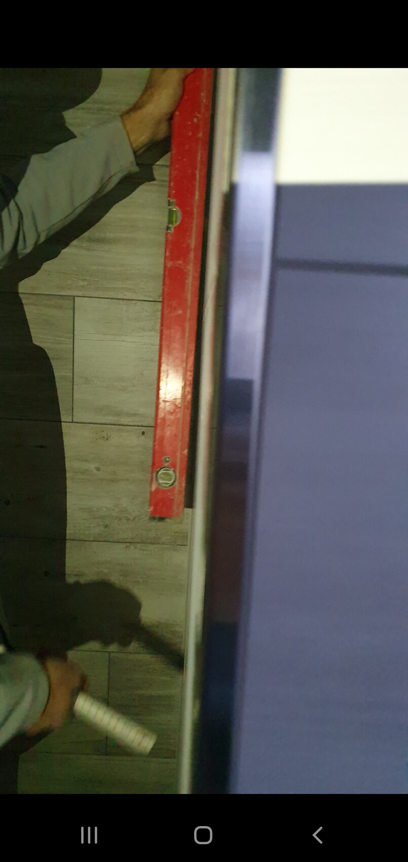

after the tiling work was completed, we walked through the house and were a bit surprised by some issues.
Now we are not sure if we are just being picky or if the work was really done carelessly. Are these defects fixable and should they be raised with the tiler?
These corner cubes are mostly installed at an angle.
One rail in the photos is also slightly twisted. The grout joints are not parallel in a few places.
And in the last photo, isn’t an internal corner supposed to be mitered?
See photos

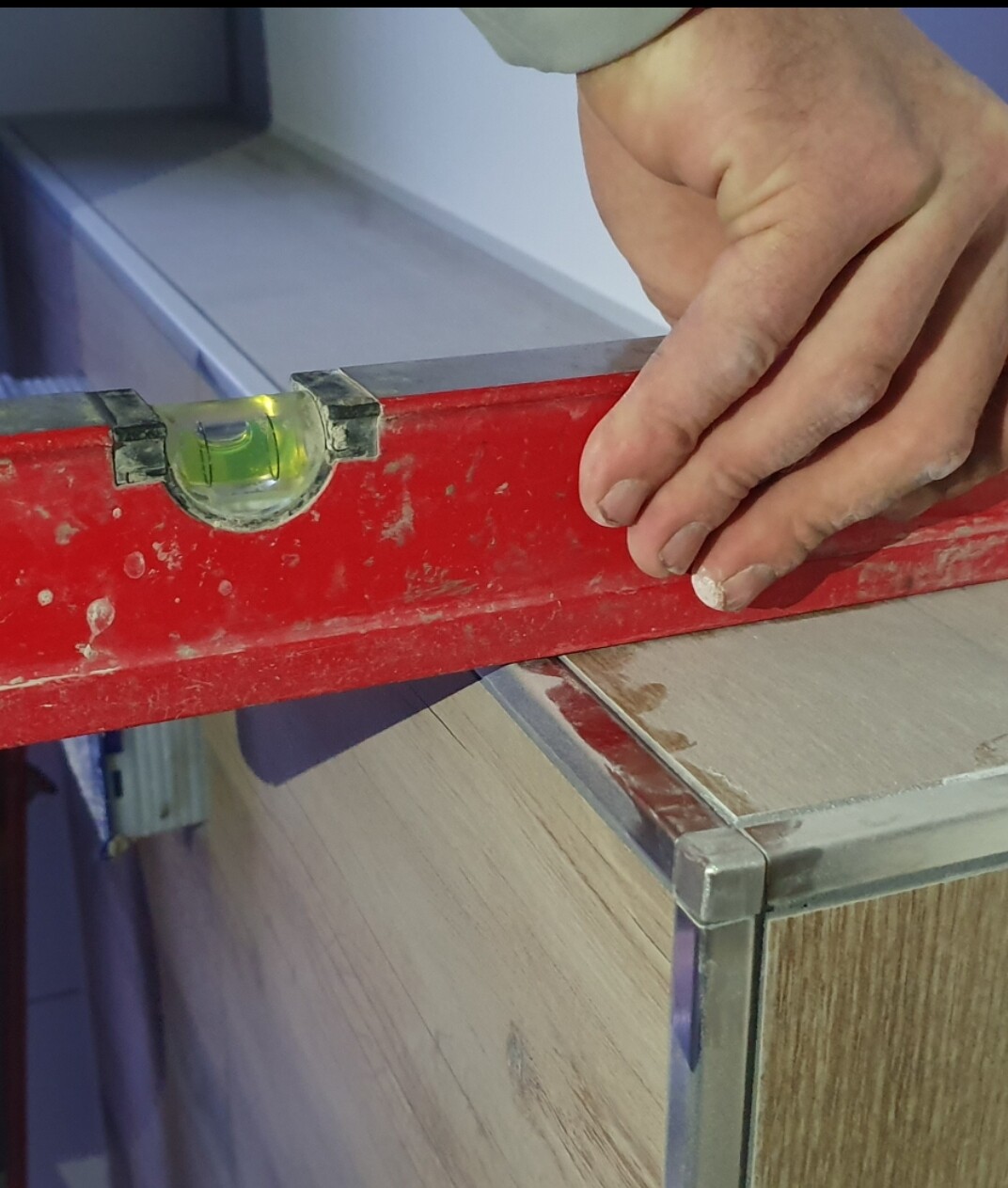

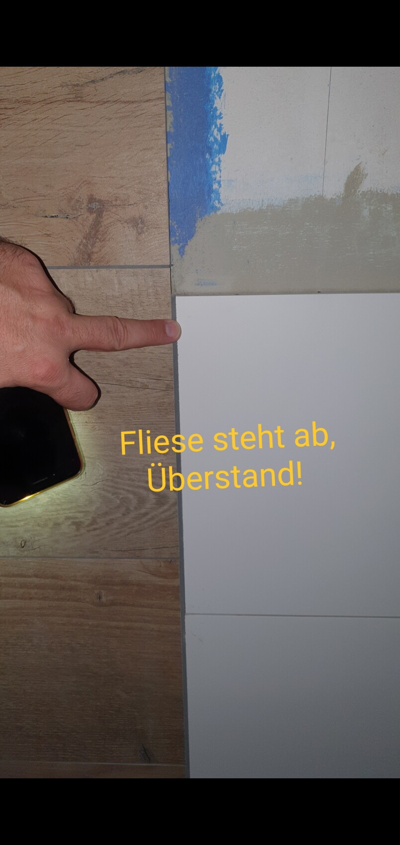

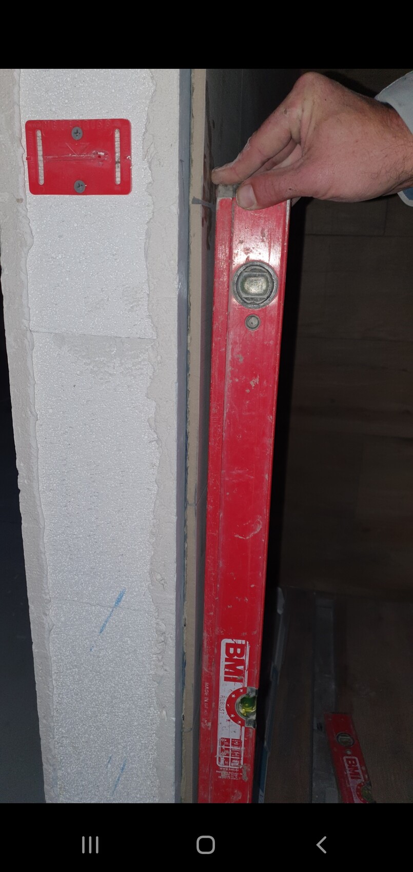

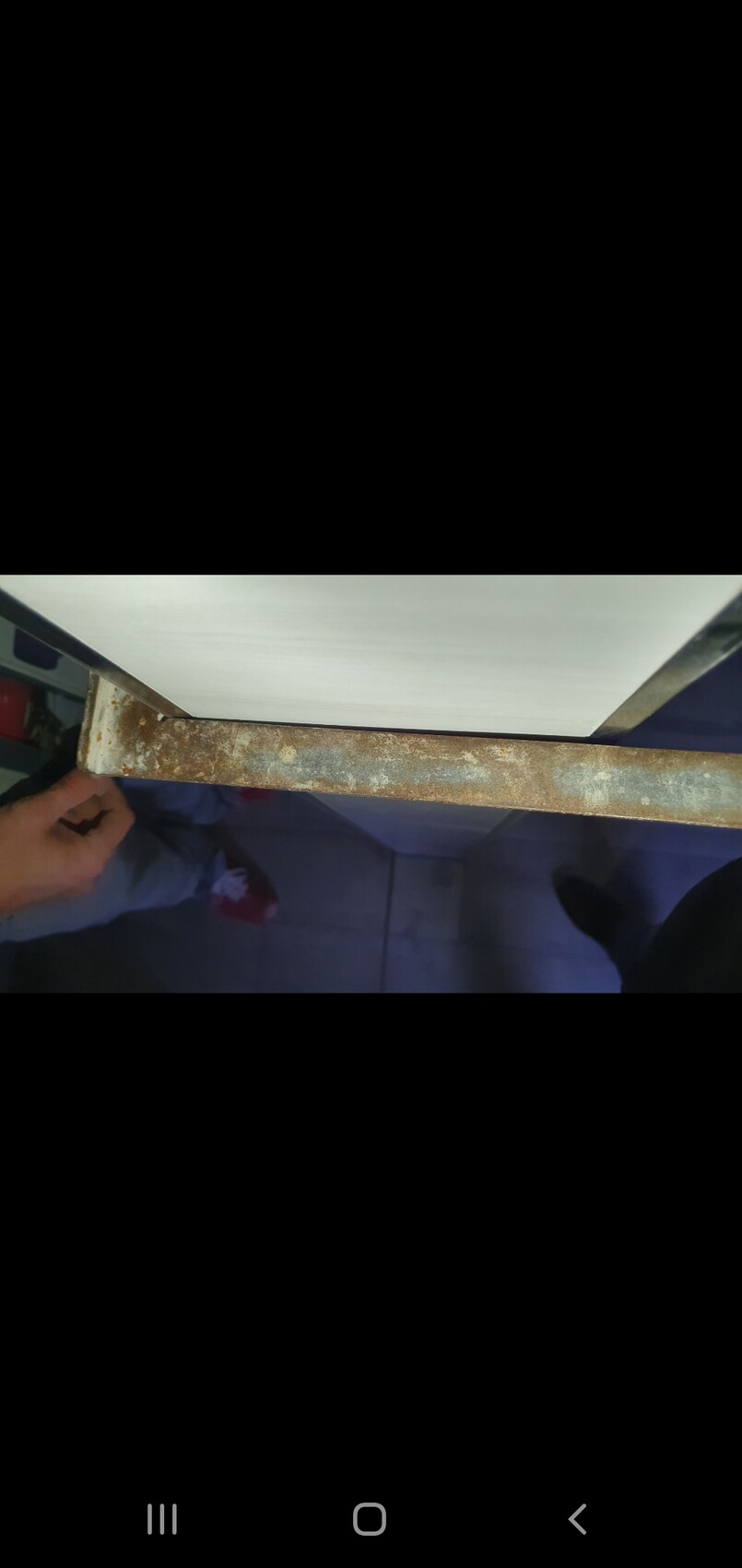

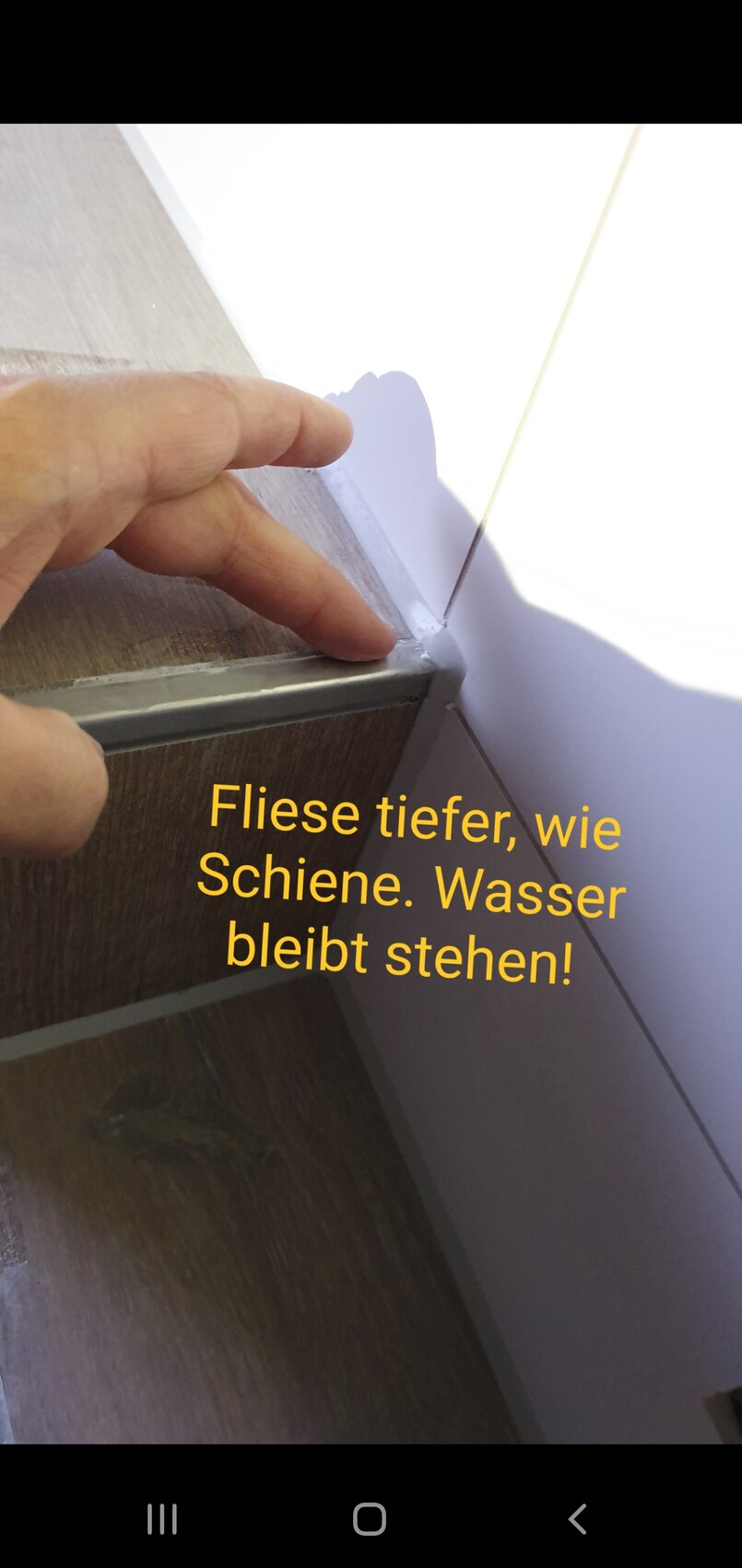

And here are a few more defects found by another tiler who took a look.
A hand pointing at a protruding tile at the transition from wooden floor to wall.
A hand holding a red spirit level vertically against a door frame during construction work.
Close-up: fingers on the edge of a wooden cabinet with metal runner, light background.

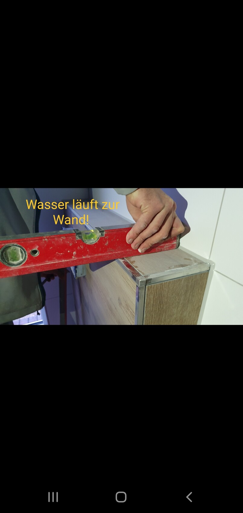

Hand holding a silver metal edge next to a tile joint; yellow text: water remains pooled.
Rusty metal edge of a white panel; close-up from above with a hand on the edge.
Incomplete shelf: open water connections, water running towards the wall.
Bathroom wall with tiles; note: shelf improperly installed, water runs toward the wall.

Bookstar
15 Oct 2019 21:53
Water flows toward the wall, and then there are pictures of the toilet and washbasin??
This is problematic in the shower and should be corrected.
LarsRud15 Oct 2019 22:06
The walk-in shower is positioned in such a way that water might possibly get onto this shelf.
I think the surface should simply slope away from the wall rather than towards it, or at least be level. This applies to any shelf in the bathroom, including a shelf by the washbasin, right?
Close-up: Hand holding a red spirit level checking the levelness of a wooden board.
Bookstar
15 Oct 2019 22:23
Strictly speaking, you are right, it is a defect. However, it only becomes a problem in the shower. In my opinion, it would be excessive to have everything checked.
