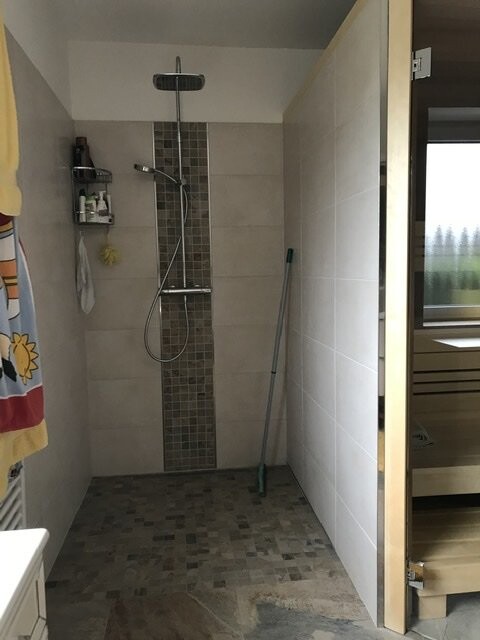

Nida35a27 Sep 2020 10:51
Large-format flooring can be very slippery when wet, so consider using mosaic tiles for the floor.
