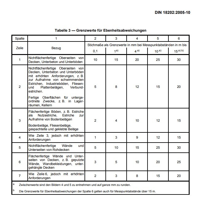

What are the acceptable tolerances regarding a leaning wall? Is it already "too leaning" in the pictures or not?
danixf
16 Oct 2019 15:28
Yosan schrieb:
What are the typical tolerances for an uneven wall? Based on these pictures, is this already "too uneven" or still acceptable?
DIN 18202:2005-10 Tabelle 3 mit Grenzwerten für Ebenheitsabweichungen.
