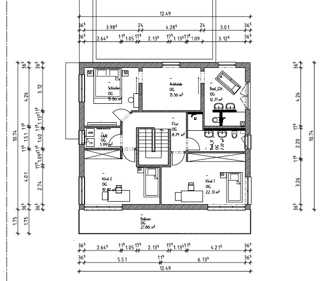

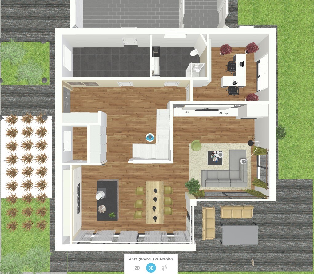

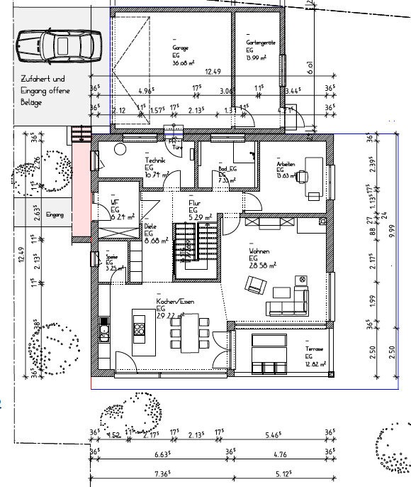

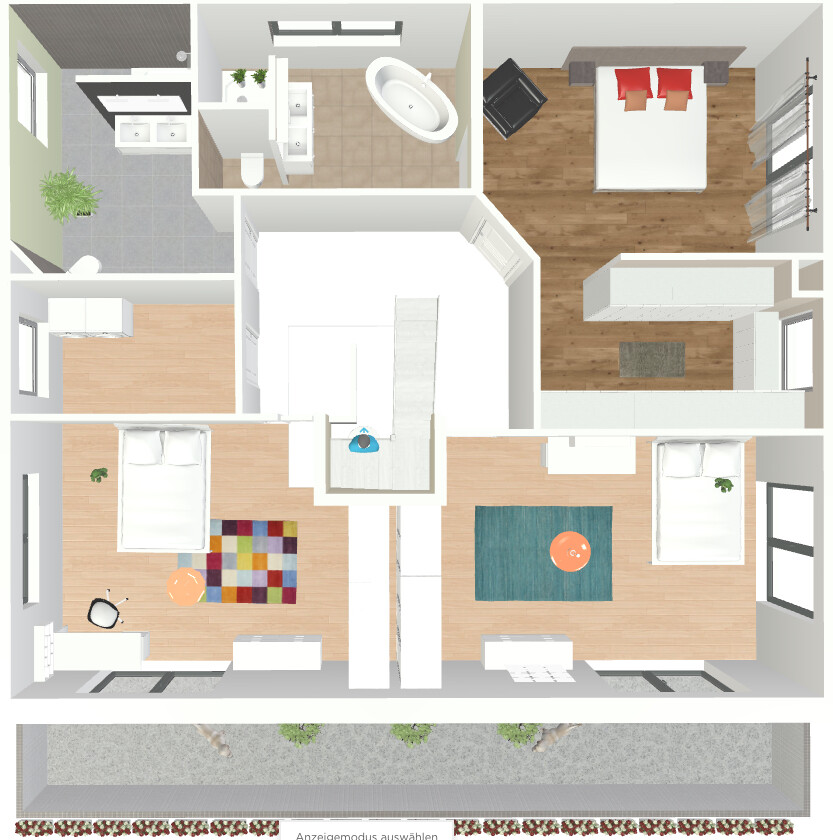

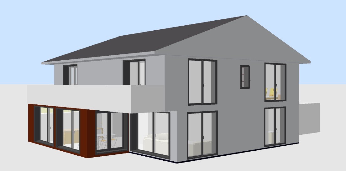

I’d like to return to my "never ending story." Over the holidays, I sketched the plans using Sweet Home 3D and Homebyme to get a better feel for them. Additionally, I consulted one architect and two draftsmen and showed them the original plans. The only feedback I received was that everything fits well and looks good. Maybe I’m just being overly critical.
However, I am still bothered by the dark corridor on the upper floor and the corridor width of 1.15m (3.8 feet) on the upper floor. Could anyone give me some advice on how to improve this? In my attached drawings, I widened the corridor to 1.30m (4.3 feet), but it still seems quite narrow to me.
In the attached plans, I also modified the staircase because the narrow and unfortunately only access in the ground floor to the kitchen and living room seems too tight with the landing staircase.
As you can see, I’m currently quite frustrated.
Grundriss eines Hauses: Küche mit Insel, Essbereich, Wohnzimmer, Arbeitszimmer, Bad, Flur, Garten.
Grundriss einer Wohnung mit zwei Schlafzimmern, Bad, Küche und Wohnzimmer.
Modernes zweistöckiges Haus mit großen Glasfronten, grauer Fassade und Balkonanbau.

It is difficult to have a meaningful discussion with these dollhouse-like pictures. Do you also have proper floor plans with dimensions? I am particularly interested in the staircase first.

Hello, on page 8 you can find the original drawings. Unfortunately, I am not at home right now to upload the images again.

But I only have 6! pages [emoji23]
Edit: and no, I don’t see a floor plan that could fit the upper floor either.

Was able to copy it over.
Floor plan of a single-family house: ground floor with garage, kitchen, dining area, living room, bathroom, study.
Floor plan of the upper floor: bedroom, walk-in closet, bathroom, hallway, two children’s rooms, balcony.
3 Jan 2018 10:59
The bathroom seems too narrow for a T-shape.
Basically, I would reduce one meter (3 feet) from the middle of the house, which would save a significant amount of costs without making anything too small.
