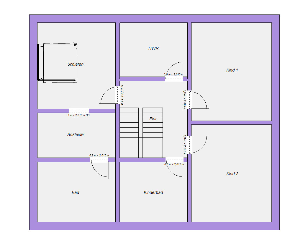

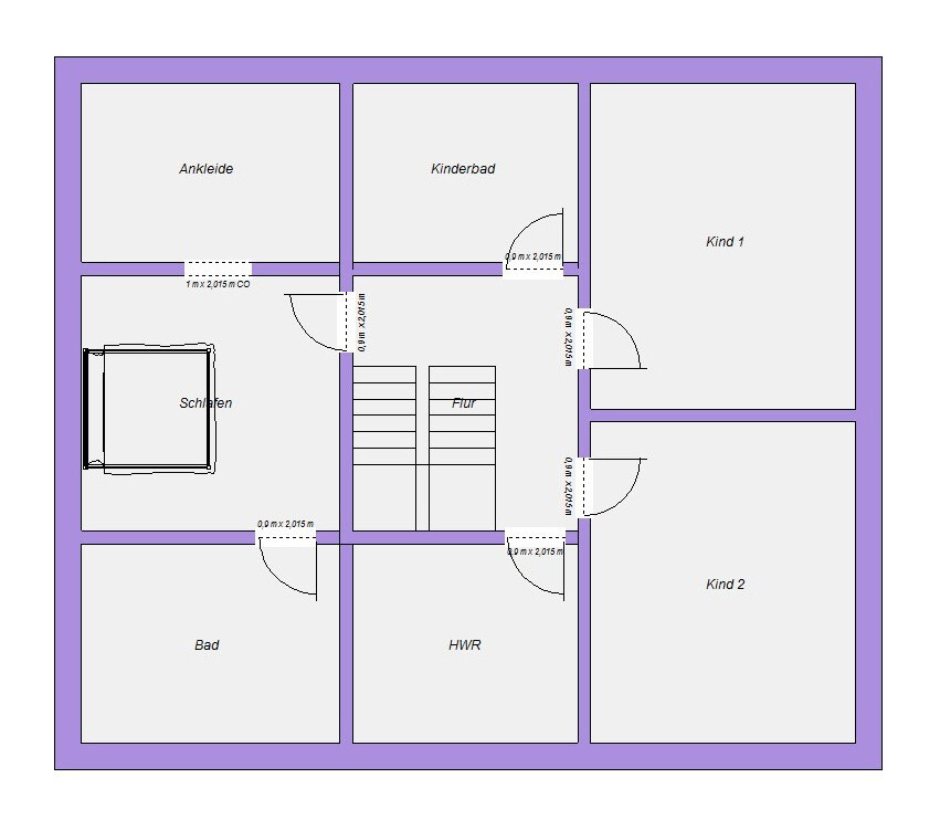

kaho67414 Oct 2017 07:55
I also think the discussion about walk-through rooms is somewhat exaggerated.
Attached is an alternative layout. However, I have to say that I haven’t considered the rooms below or the location. I’m now relaxed about the former, and I haven’t gathered any information about the location so far.
Grundriss eines Hauses mit Treppe: Schlafen, Bad, Flur, HWR, Ankleide, Kind 1, Kind 2, Kinderbad.
Obergeschoss-Grundriss mit Schlafen, Ankleide, Bad, HWR, Flur, Treppe, Kind 1, Kind 2, Kinderbad.
kaho67414 Oct 2017 08:09
Oh, I just noticed the children's room faces the south side – so I only have 1 out of 2 points there.
