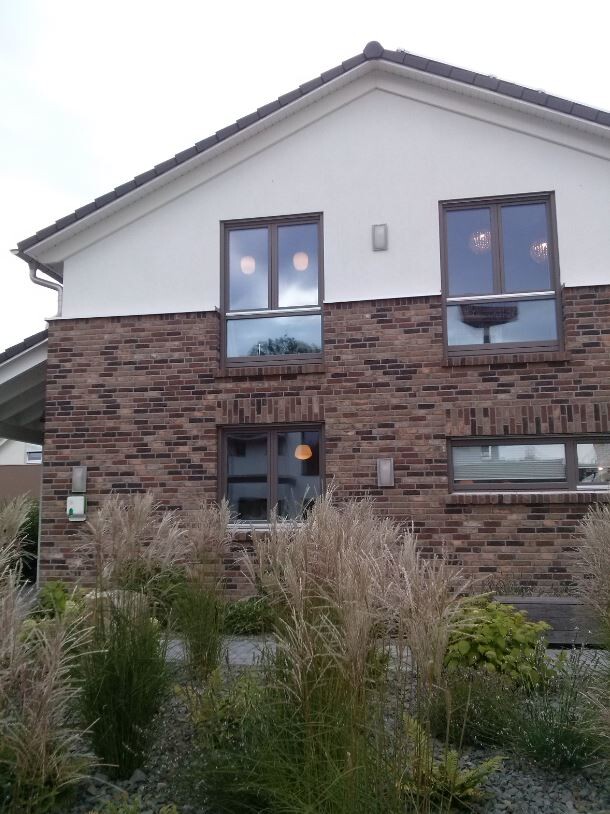

The house is supposed to have partial brick cladding... or it’s not 100% decided yet. Why? Then you’ll have to make several compromises in the wall construction if the facing bricks should not protrude.
Uh— you’ve already seen that I incorporated your second design from post #15.

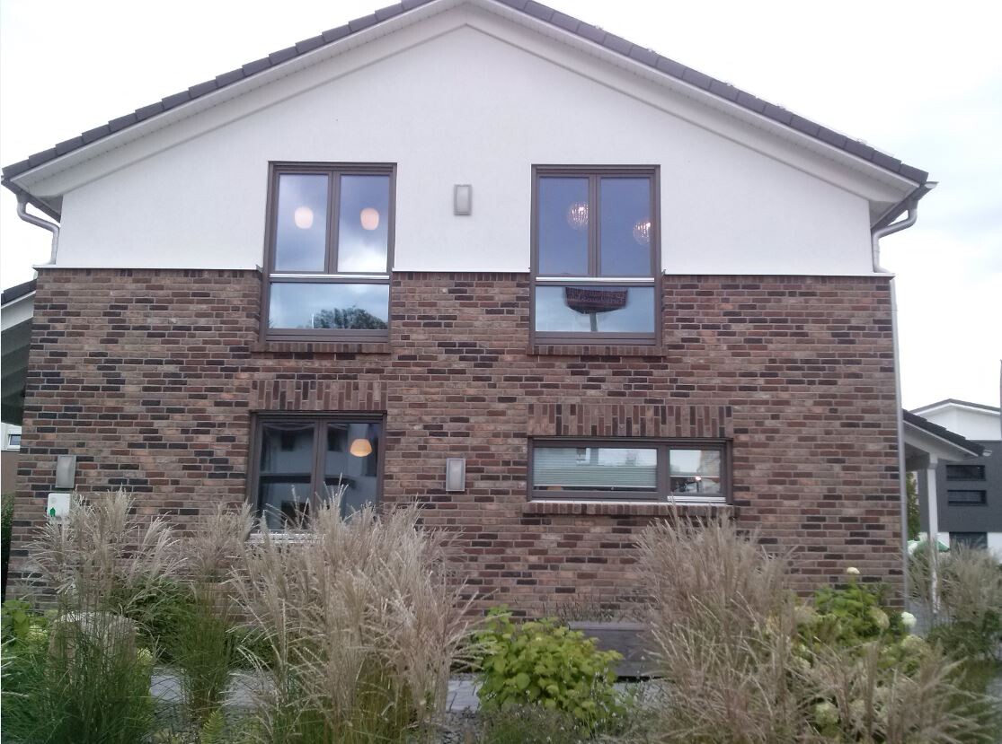

The attachment shows how the exterior wall could look.
PS: I hadn’t even noticed the design before.
Bauexperte16 Sep 2015 13:08djon25 schrieb:
Attached is an example of how the exterior wall could look. Is the image free to use? Otherwise, I will unfortunately have to delete it.
Regards, Bauexperte
Bauexperte schrieb:
Is the image free to use? Otherwise, I will have to delete it.
Regards, BauexpertePlease delete it, I have uploaded 2 photos from my phone...
