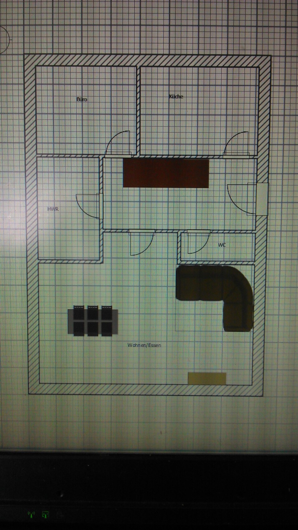

Kisska8618 Sep 2015 13:06
If you want to keep the kitchen and living room separate anyway, I would plan something like this.... This is just a quick sketch for now...
Floor plan of an apartment: office, kitchen, utility room, restroom, and living area with dining table and sofa

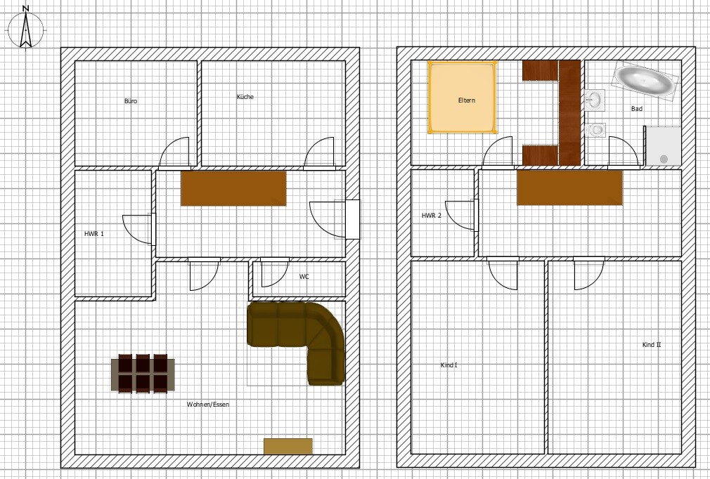

Kisska8618 Sep 2015 13:22
Here is a decent picture.
The exterior dimensions should be suitable... If you find it interesting, I can provide additional measurements, but it should work at least to this extent, and I think the layout is nicer, both for the living room and the children's bedrooms.
Two-story floor plan: left side office, kitchen, living area; right side master bedroom, bathroom, 2 children's bedrooms.
