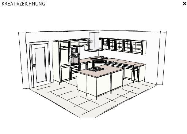

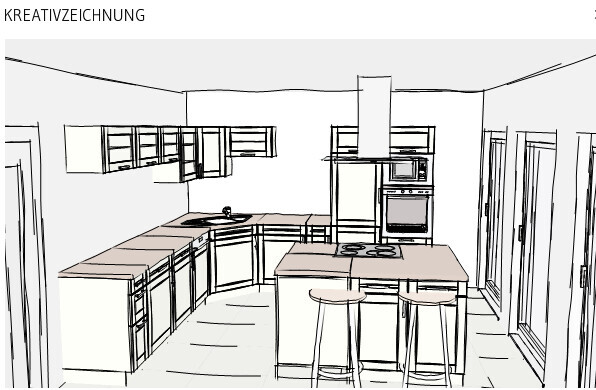

I have attached the floor plan with the kitchen island variants. It’s a bit rough with pencil marks but the result of extended considerations.

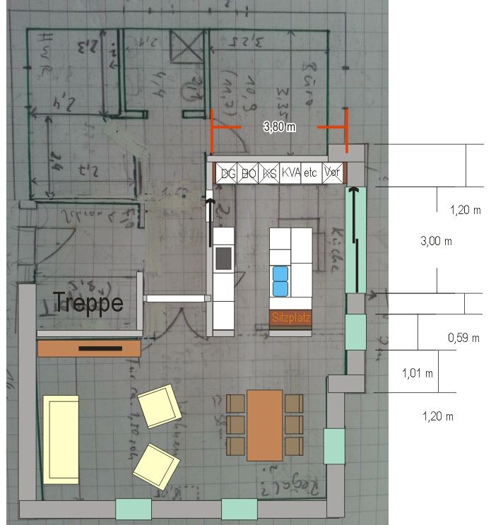

I was being creative earlier and here are two versions based on the original layout.
With 3.8m (12.5 ft) and the island at a 90-degree angle to the windows (favorite because you look into the rooms and along the windows)
0.6m (2 ft) kitchen counter, 1.1m (3.6 ft) clearance, 0.6m (2 ft) window clearance (fixed, only for cleaning) = 1.5m (5 ft) island.
If the hallway is made narrower, you could gain another 0.3m (1 ft) in the kitchen. Then you'd be at 4.1m (13.5 ft).
Other version:
Long in front of the windows... you had some critical comments about that.
The advantage would be using the room length and having more clearance in width.
We added a wall panel so the kitchen can be closed off (glass and door installed, also retrofittable) and maybe could be used for some storage.
P.S. I personally don’t like a tall fridge or oven next to the door, so that would have to be reconsidered.
I just wanted to get a sense of how it would generally look.

So.. I don’t know where you get the 410 cm (13 ft 6 in) room width for the kitchen from. Your island layouts with a room width of 325 cm (10 ft 8 in) won’t work.
And yes, the 6 square meters (65 sq ft) refer to the space in front of and behind the partition wall.

Good morning,
It’s not 325 but 380 up to the window, plus a maximum of 30 cm (12 inches).
We have also considered different house layouts, with an office (kitchen facing the street) or kitchen (living room with an L shape) in the northeast. That’s not really our preference, given the elongated plot.
The living room should definitely run along the garden at the back.
A redesign would only be possible if you forgo both outer windows upstairs and make the gable smaller. That’s quite common; we had that initially, but the development plan is quite restrictive.
What do you think about the sliding door?
