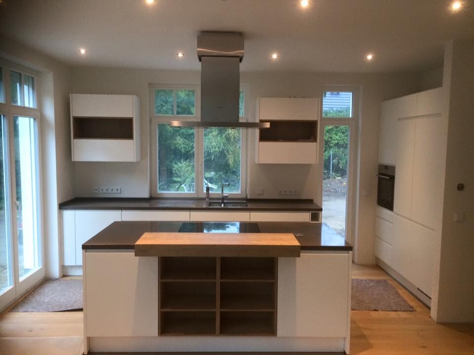

after planning the house and the windows, we were also concerned during the kitchen planning about whether having too many windows, especially floor-to-ceiling ones, would overly restrict the kitchen layout. There was quite a bit of criticism about the kitchen floor plan here in the forum.
However, I think, and am a bit proud to present, a kitchen with relatively many window fronts, some of which are floor-to-ceiling.

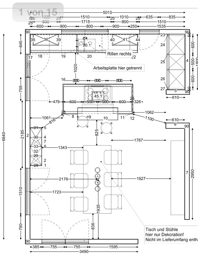

A 33 sqm (355 sq ft) kitchen and dining room.
OK – I assume you combined the kitchen and dining room. In our case, the living room is "traditionally" combined with the dining area. Additionally, there is a kitchen table for 5 people in the kitchen itself (the children are not supposed to eat in the play and living area).
Yes, we actually decided on a somewhat non-traditional layout: dining and kitchen combined, living area separate. We also spent a long time considering whether and how to do it this way.
The previously planned separate kitchen with a separate dining table was replaced in favor of a kitchen island and a larger open space.
