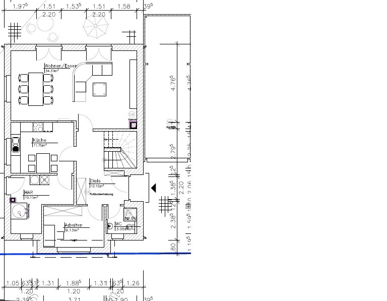

Plot size: 420m² (4520 sq ft)
Orientation: North
Building envelope, setback line, and boundary: 3m (10 ft) distance from the street, 14.5m (48 ft) wide and 29m (95 ft) deep
Gable roof with 20° pitch
2 floors
Number of people: 2 + (2 children planned)
Office: Home office
Guests per year: 6
Living area: 150 sqm (1615 sq ft)
Enclosed architecture
Modern construction style
Fireplace
Garage
Designer: Planner from a construction company
Points we are not satisfied with yet:
- Guest toilet is too large (no shower needed in it)
- Utility room should also be used for storage; heating system: gas, solar, or photovoltaic – is 10m² (108 sq ft) sufficient?
- We would like a sliding door in the kitchen, but
- We don’t know where to place the fireplace
- We would like a partition wall in the upstairs bathroom to separate the shower and toilet… but something still feels off
- We are considering installing a glass door in the kitchen to bring more light into the hallway
We would appreciate your opinions or ideas.

I see it the same way as others: the kitchen is too small and impractical with all the doors. Besides, if I were building a house, I wouldn’t want to just “manage” with a small kitchen, but rather have it properly designed.
The same applies to the shower. Even though LEDs are nice, I wouldn’t plan a shower that ends up in darkness.

I would still redesign the ground floor and try to address the criticisms and your own main issues (bathroom without shower, proper wardrobe, less awkward utility room, kitchen with usable seating area)I agree...
If we were satisfied, I wouldn’t be asking for ideas or opinions. So, thank you very much!
I had drawn a similar floor plan myself, but in my version the kitchen is larger and there is no sliding door.
I somehow mixed up the posts and replaced your attachment with mine; of course, that shouldn’t happen. Sorry about that!
Please upload it again.

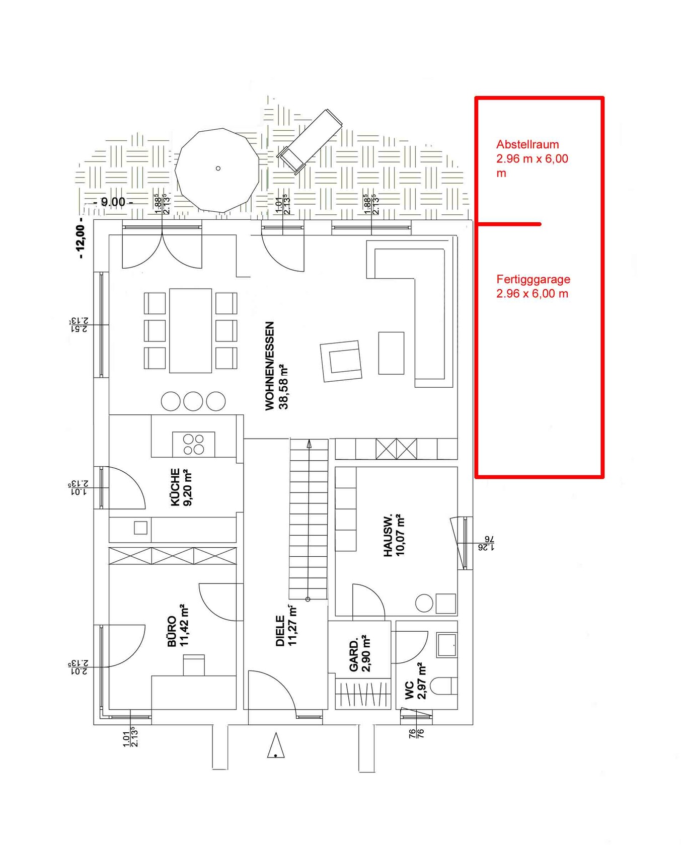

Bauexperte16 Sep 2015 12:04Hello,
This is probably related to the specifications of the development plan. Often, a garage cannot exceed the building envelope by more than 3.00 m (10 feet). In my opinion, your planner has drawn it accordingly; still, I have seen better designs.

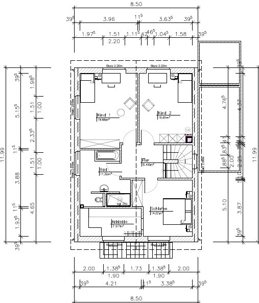

I am currently working on a similar project; however, with dimensions of 9.00 x 12.00 m (30 x 40 feet) and also with a north-facing plot. Attached you will find an example of the ground floor with a projecting entrance canopy; this could easily be designed as a bay window instead, incorporating the rooms behind it into the bay. If the width is uniformly reduced by about 0.50 m (20 inches), the design should still work without significant limitations for the rooms; additional storage space for the kitchen could be created under the staircase. On the associated upper floor, the children's rooms are located on the west side; the bathroom is above the utility room, and there is even space for an open area. The west orientation is chosen so the children get more sunlight.
Is the building supposed to be clad with brickwork, or do the elevations feature a wood façade?
Regards, Bauexperte

Regards, Bauexperte Thank you very much for the floor plan. I actually like it quite a bit. Is there a closet to the right of the stairs, or is that in the living room?
The house will be partially brick-clad, but this is not yet 100% finalized.
