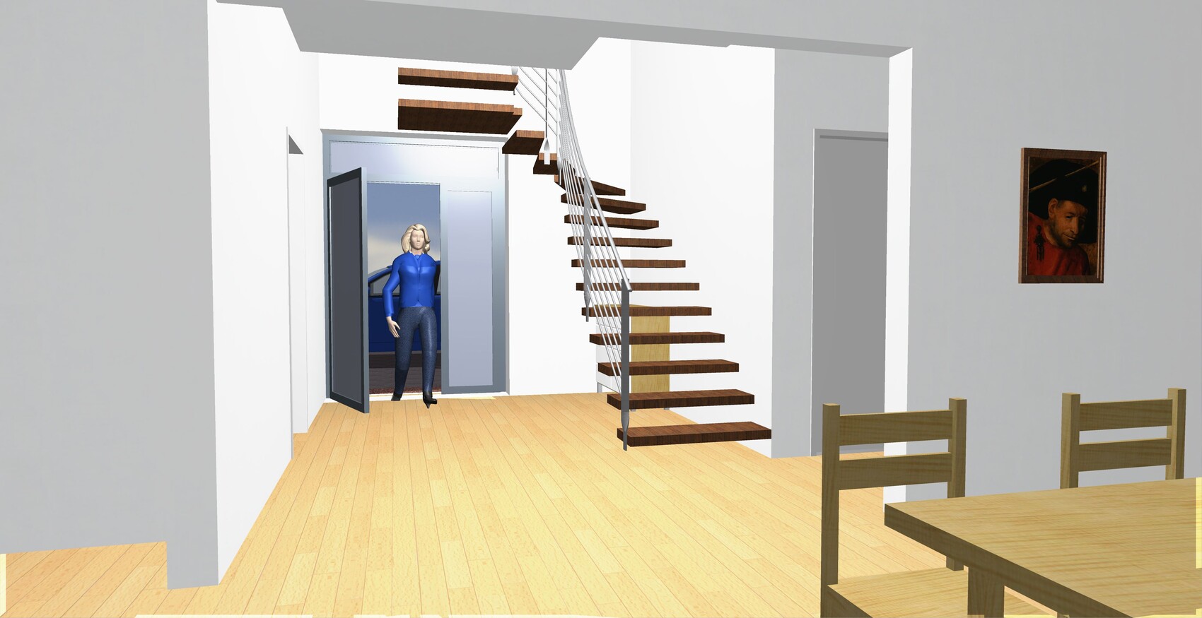

Are you really sure about the double-leaf living room door? Usually, one side remains closed most of the time, while the other side stays open and tends to get in the way.
In our house, we opted for a wide, open passage without a door for this reason...

chaosandi4 May 2014 11:59Hey Dirk,
Thanks for your reply.
The roof windows are planned for the children’s bathroom on the top floor, and possibly also for the parents’ and the larger children’s bedroom because of better natural lighting.
The total area will be around 320 sqm (3,444 sq ft). Ground floor about 120 sqm (1,292 sq ft), upper floor 100 sqm (1,076 sq ft), basement 100 sqm (1,076 sq ft). These are just rough estimates. In the end, it could also be 300 or 330 sqm (3,229 or 3,552 sq ft).
The bedroom layout happened like that; it wasn’t my choice. If I moved the washbasin corner into the bedroom, I would have more space in the bathroom, but it would also result in a less pleasant view when entering the bedroom. I’m still undecided about that.
The staircase on the right, next to the utility room, leads down to the basement. I didn’t want to have them aligned vertically because, as I said, I want to keep the basement out of everyday sight and use (work-related). There will be a door in front of this staircase.
Regarding the door to the living room, I could also imagine having a fixed glass panel. You are probably right about your point concerning usability.
To be honest, I would find it too open... see the picture.
Regards, Andi
