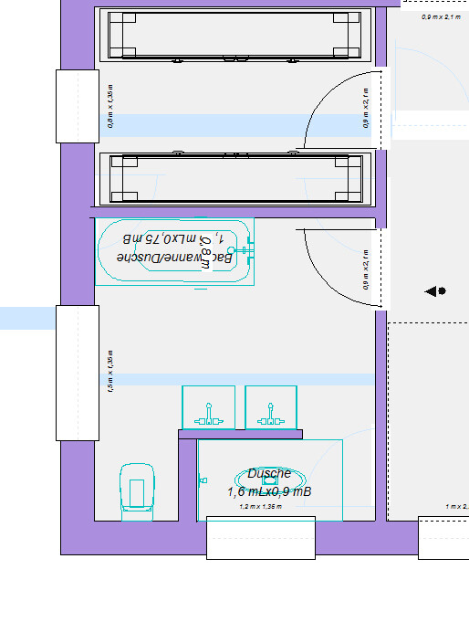

kaho67418 Jan 2020 10:53
Your priorities are your own, but I would always leave that dead corner next to the bathroom sink to you as the planner of this fiasco when it comes to cleaning.
hegi___ schrieb:
Because of water splashes, I prefer an L-shape. Your layout doesn’t provide that.
Why? That’s not true at all:

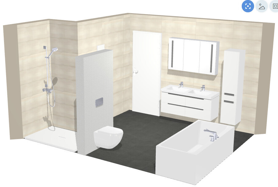

hegi___ schrieb:
I’m still open to discussion regarding the bathroom.
A walk-in shower without an enclosure measuring 1 x 1.5 m (3.3 x 4.9 ft) is a must.
To avoid water splashes, I prefer an L-shaped layout, which your design doesn’t provide.
I don’t necessarily need a window above the toilet, but I could imagine a clerestory window there.
I like the floor plan Katja attached again in post 151 better. It meets your shower requirements, and you also gain more storage space in the dressing room. Additionally, in your draft, the access to the shower is very narrow. It’s worth considering that one might still live there at an older age, so the entrance should be wide enough to allow passage with a walker.

kaho674 schrieb:
Your priorities are respected, but I would always leave the cleaning of that dead corner next to the bathroom sink to you as the planner of this fiasco.
[ATTACH alt="Bad.jpg"]42084[/ATTACH]
As I said, I don’t see any dead corners in my original plan. Provided the bathtub could also be placed on the other side.
But will you always be the one to remove mold from the window gaps?
I don’t want a window in the wet area. It would also have to be frosted glass unless I want every passerby to see my girlfriend’s breasts.

kaho67418 Jan 2020 13:54
hegi___ schrieb:
But do you always come and remove the mold from the window seals?
I wouldn’t want a window in the wet area.
We have a window in the shower in another house and haven’t had any problems. But maybe that’s just luck? I don’t know.
hegi___ schrieb:
It should also be made of frosted glass if you don’t want every passerby to see my girlfriend’s breasts.
Why shouldn’t anyone see them?
truce18 Jan 2020 14:20
I think kaho’s design is nice. The toilet wouldn’t be directly in the line of sight.
