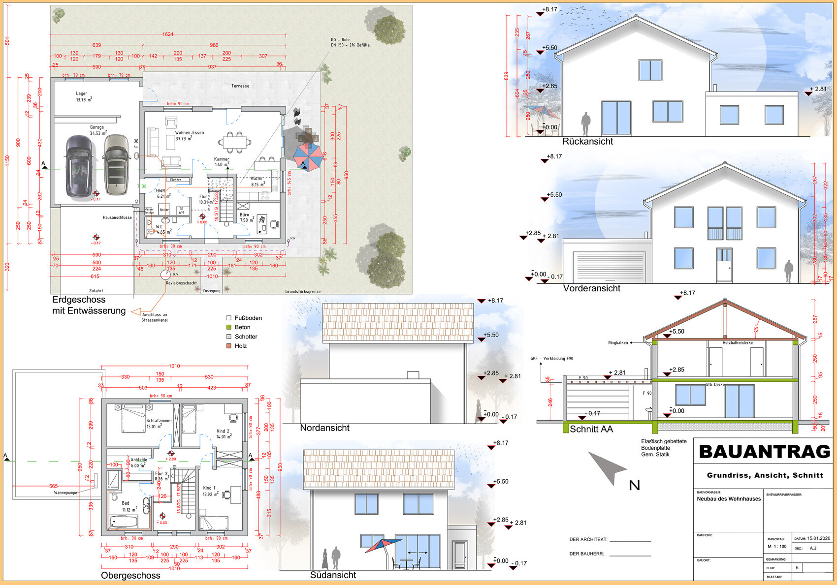

I have now received the final plan.
Next, I will design the mechanical ventilation system for the ground floor so the structural engineer can start.
The column in the gallery will be removed. Either the structural engineer will find a clever solution, or we will use a truss roof.
Architekturplan eines Einfamilienhauses: Grundriss, Front-/Rückansicht, Schnitte und Gelände.
kaho67416 Jan 2020 15:31
Would you like to reconsider the windows? The rear view isn’t very appealing, and the walk-in closet doesn’t have to be completely dark, right?
There is a dead corner next to the sink. Maybe you should move the bathtub all the way to the right side according to the plan?
