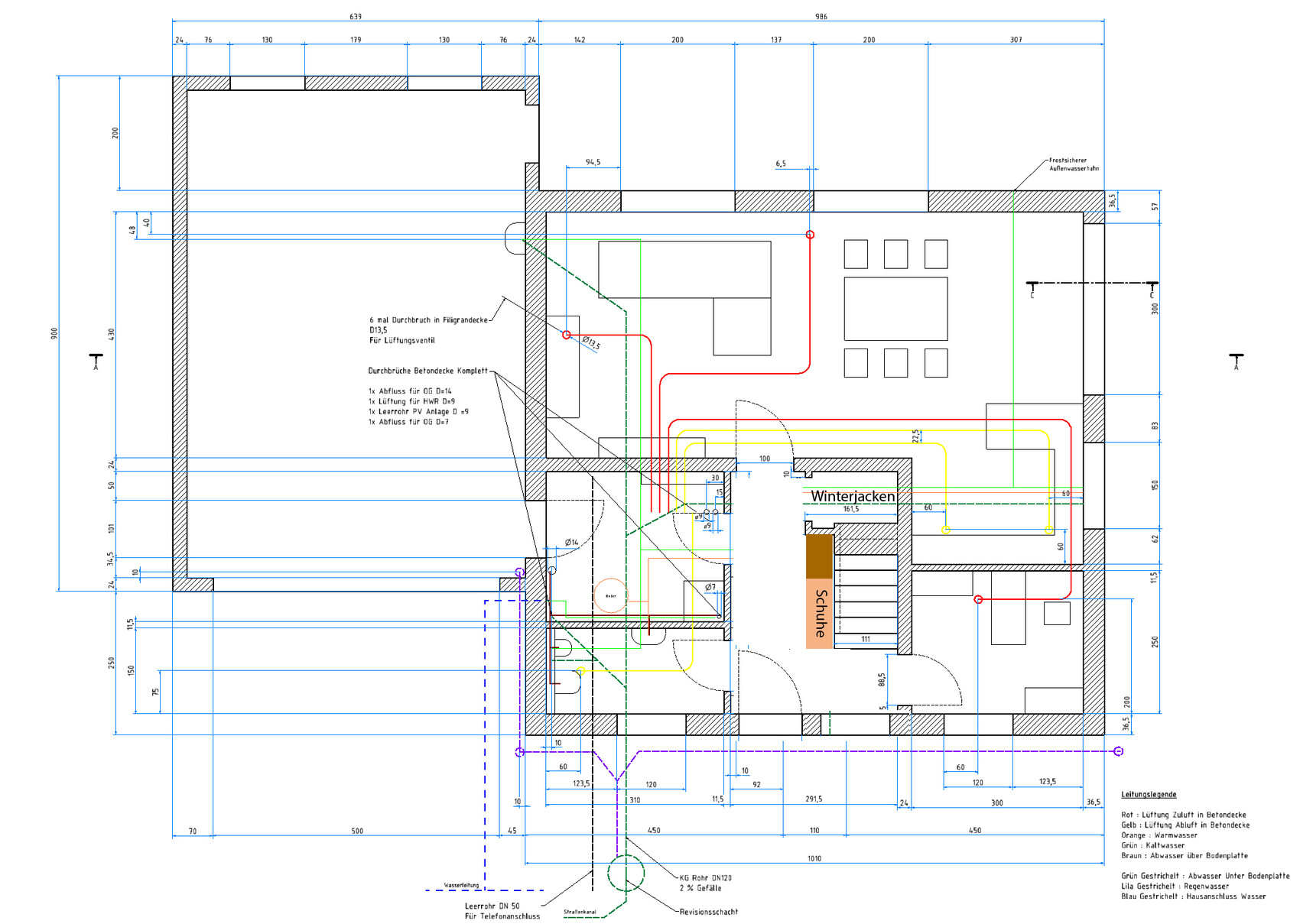

ᐅ Single-Family Home Floor Plan Design, 130-140 m²
Created on: 23 Nov 2019 09:35
hegi___
Plot size = 600 m² (6458 sq ft)
Number of floors = 2
Roof type = Gable
2 children’s bedrooms
1 office
1 walk-in closet
1 bedroom
Guest toilet and bathroom
Open-plan kitchen and living area
1 utility room
Double garage with storage area
Found on the internet
Why is the design like it is now?
Plan currently fits best
Utility room and office swapped due to door leading to garage
Dislike the large hallway on the first floor
The footprint of 9.5 x 9.5 m (31 x 31 ft) should be maintained
Layout should be as simple and cost-effective as possible
No unnecessary features
More elegant solutions with less hallway space loss?
Technical drawings: side view, isometric of houses on plot, floor plan with dimensions
Floor plan of upper floor with hallway, master bedroom, walk-in closet, bathroom, and two children’s bedrooms.
House floor plan with terrace; living/dining area, kitchen, office, WC, hallway.

kbt09 schrieb:
Where is the wardrobe for 4 people supposed to go, actually?
hegi___ schrieb:
To the left of the door.
Shoes go on a shelf under the built-in staircase.
The question is more about where you will store all your jackets, coats, and seasonal clothing. You will likely have more than one jacket in use, for example, a simple one for work, a nice coat for the cinema, a raincoat for walks, fleece for gardening, and a sports jacket for outdoor activities. All of this for 1, 2, 3, or 4 people—in the wardrobe. Easily accessible. The same applies to shoes: the muddy pair, the leather pair, the insulated ones, dress shoes, trainers, rubber boots. The kids tend to have more of the first kind, while Mrs. Pömps has ballerinas, flip-flops, ankle boots, tall boots, sneakers...
And you probably own more than one pair, too. Shoes go under the staircase, but the jackets do not...
hegi___
20 Jan 2020 19:50
Yes, it is not ideal, but I don’t see any other option.
kaho67420 Jan 2020 20:06
hegi___ schrieb:
I will now continue with my own construction plans and no longer use those from the architect.
ops: Wait, are you proceeding without the architect now?
hegi___ schrieb:
Yes, it’s not ideal, but I don’t see any other option?
You say that often – so is this something to just accept and leave unresolved for the rest of your life?
The coats and shoes will all end up in the office anyway – because the space has to be there, whether you plan for it or not. You can’t just leave it out.
The winter coats could go in the space under the stairs; just put in a rod – and you have a wardrobe.
If you make the decision to move the front door, I could also imagine adding a closet and a shoe cabinet by the stairs:
