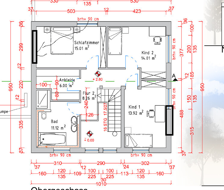

ᐅ Single-Family Home Floor Plan Design, 130-140 m²
Created on: 23 Nov 2019 09:35
hegi___
Plot size = 600 m² (6458 sq ft)
Number of floors = 2
Roof type = Gable
2 children’s bedrooms
1 office
1 walk-in closet
1 bedroom
Guest toilet and bathroom
Open-plan kitchen and living area
1 utility room
Double garage with storage area
Found on the internet
Why is the design like it is now?
Plan currently fits best
Utility room and office swapped due to door leading to garage
Dislike the large hallway on the first floor
The footprint of 9.5 x 9.5 m (31 x 31 ft) should be maintained
Layout should be as simple and cost-effective as possible
No unnecessary features
More elegant solutions with less hallway space loss?
Technical drawings: side view, isometric of houses on plot, floor plan with dimensions
Floor plan of upper floor with hallway, master bedroom, walk-in closet, bathroom, and two children’s bedrooms.
House floor plan with terrace; living/dining area, kitchen, office, WC, hallway.

Was symmetrical window arrangements really that important to the homeowner?
Having the toilet positioned under the windowsill with the user facing outside must be part of a certain life philosophy to find that appealing.
17 Jan 2020 21:21
I would place the kitchen there instead of the office... rotate the rooms slightly considering the western sun... office at the top left of the plan, but that means a different layout, as the staircase would no longer fit.

hegi___
18 Jan 2020 09:37
kaho674 schrieb:
Unbelievable.
Which side is the south side of the bedroom?
Any exterior views available?
I’m just annoyed that I bothered. I confused you with someone else who cares about how the house looks from the outside. You really shouldn’t read too many threads at once.
Attached is the image with the changes.
So my priorities are as follows:
1. Stick to the budget
2. Functionality
3. Appearance
Of course, I appreciate the effort you put in. In the end, we will implement some of the ideas.
chrisw81 schrieb:
Let me say something about that..
I think the window on the north side in the sofa area is clearly too small. We have a similar window (1.76 x 1.38 meters (5.8 x 4.5 feet)), and for the large space you have there, it will look too small! Even if there is a floor-to-ceiling window further east, it’s too far away to provide natural light for the sofa area. If the furniture layout allows, I would definitely install a floor-to-ceiling window there and maybe make it larger, around 2.5–3 meters (8.2–9.8 feet).
You will be rewarded with a great view!
So I did some calculations:
Schüco window including roller shutter 2000 x 1350 millimeters (78.7 x 53.1 inches) = €1100
1.8 m² (19.4 ft²) exterior wall = €180
Interior and exterior plastering 1.8 m² (19.4 ft²) = €60
Window sill inside and outside: €150
Total: €1490
Floor-to-ceiling Schüco window 2000 x 2000 millimeters (78.7 x 78.7 inches)
Total: €1500
I didn’t expect that at first. Then we’ll definitely add another floor-to-ceiling window to the living room.
Is that so?
Maybe you’re saving on the controlled ventilation system, then you could just open windows?!
And there will definitely be situations (putting things away in the closet, cleaning) when you want daylight.
Also, a chair usually likes to be placed under a window
I’m still not convinced. But we’ll see how the budget looks once I have offers for windows, the shell construction, and the roof. We’ll review everything then.
At least we currently have quotes for the earthworks that are about €10,000 cheaper than originally offered by the shell builder.
The controlled ventilation system will definitely not be cut; it’s priority 1 because my partner keeps the windows open all day long...
I would put the kitchen there instead of the office... rotate the rooms a bit considering the western sun... the office upstairs left, but that means a different floor plan because the staircase won’t fit then.
We’ve discussed that before... the floor plan stays as it is now.
Between the living room and gallery there will be a large glass door that lets some of the western sunlight into the living room.
ltenzer schrieb:
Was symmetrical window arrangement very important to the client?
If symmetry doesn’t restrict priorities 1 and 2, then yes.
kaho674 schrieb:
No, the window has to stay – otherwise the exterior view is ruined. I’d rather skip the walk-in shower and install an equally nice floor-level corner shower instead.
Or a walk-in with glass wall and a small corner bathtub:
I’m still open to discussions about the bathroom.
A walk-in shower without a shower enclosure of about 1 x 1.5 meters (3.3 x 4.9 feet) is a must.
Because of water splashes, I want an L-shape. This is not possible with your layout.
I don’t really need the window above the toilet but I could imagine a skylight there.
2D floor plan of the upper floor with bedroom, two children’s rooms, bathroom and hallway
