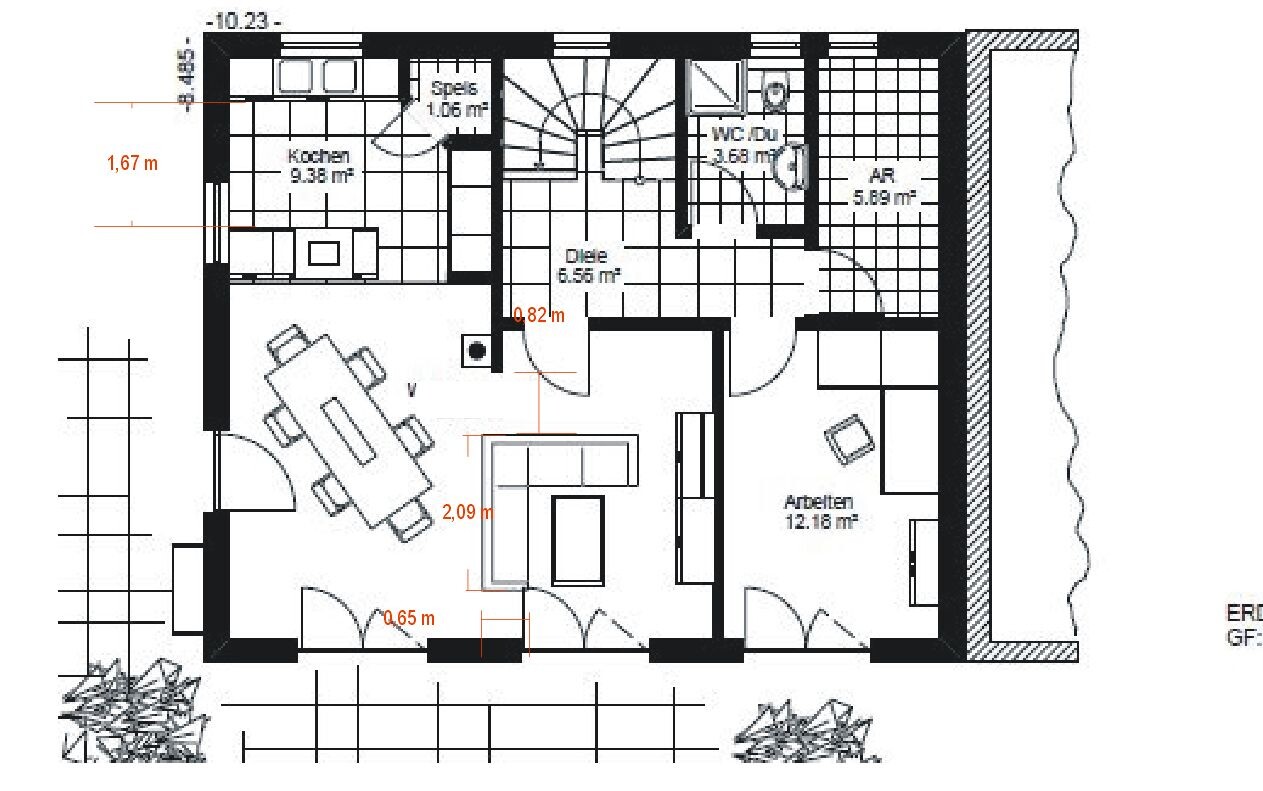

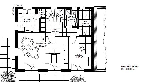

We would also like to present a floor plan. We received an offer from a homebuilding company with a finalized floor plan. We think it’s not bad, but we would really appreciate additional feedback, criticism, and suggestions for improvement.
A few facts:
- Semi-detached house in timber frame construction, 8.48 x 10.23 m (28 x 34 ft)
- The house is located in a newly developed residential area
- The house will be built into a slope approximately 2 m (6.5 ft) high (so that the entrance is at the basement level, but the ground floor leads out to the southwest-facing garden)
- The neighboring semi-detached unit is not yet built (but we can still proceed with construction)
- The pitched roof may only be 7.5 m (24.6 ft) high, with a roof pitch of 30 degrees

Yes, our biggest concern is the relatively small living room. In addition, there is a patio door and three large floor-to-ceiling windows. This means we can hardly place furniture against the walls, so the already small room feels even more crowded. On the other side of the room, there is supposed to be a stove by the fireplace, which also requires some clearance, making the room feel tighter than expected. Our possible solutions might be to widen the house (which we probably cannot afford) or replace the large floor-to-ceiling windows with smaller ones, under which we could place a sideboard or a couch. Maybe the study could be made smaller as well (we need a proper study since my wife will be working from home a lot – the suggestion of a sliding door was very helpful).
Sivolefe schrieb:
Thanks for the suggestion about the tall cabinet in the kitchen. Having a pantry was our wish – mainly because we aren’t the tidiest, and this way the pantry can be a bit messy without it showing. But we’re not sure if it will make the kitchen too cramped. Carrying groceries is something we’re used to – if we’re lucky, our car is currently parked about 30 meters (100 feet) from our current home, which also has four floors to climb.
You could design the middle window with a lower wall section (a knee wall or half wall), which would give you more options for placing furniture.

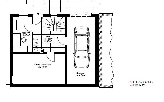

What about the office in the basement? Is that enough space for your wife’s needs – files, desk, and computer?
I would consider dividing the large basement room with a half wall to separate the technical room (enclosed area) from a storage area at the front.
Still, I think it will be quite tight to enter the kitchen from the living room after coming home, navigating between couch, dining chairs, and the fireplace. That’s why the idea of a door to the kitchen is useful. Your storage room on the ground floor should be able to accommodate your pantry needs; usually a 1-meter (3-foot) shelf is enough for various food supplies and kitchen appliances. I would also run the kitchen units under the window on the left side of the plan.

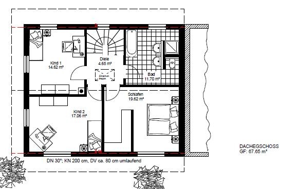

We are also wondering where to fit a bathroom cabinet in the bathroom (attic floor). We like the “T-layout” but are open to ideas... what could be a smarter solution? And where can we find a good bathroom planner?
I’m not a fan of the T-layout as it takes away space within the room. With the generous knee wall height, almost anything is possible. Try searching online for bathroom planners and experiment a bit. We can help you with specific advice as well.
Storage is generally placed under the sink. I personally like shelves about 40 cm (16 inches) below the ceiling on the wall, where you can stack towels and store boxes with toiletries. This looks quite elegant over a whole wall if the colors match well.
If you move away from the T-layout, you may gain options for a dresser or cabinet.

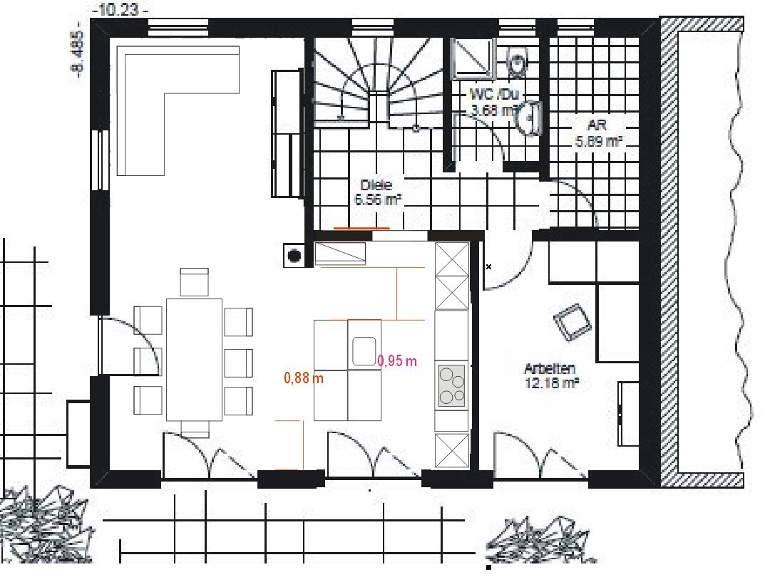

I also noticed the distance between a potential fireplace and the dining area. You always have to go around the corner to get to the kitchen area.
The sofa in the architect’s plan is also drawn quite small... I have illustrated this here:
Floor plan of a house: kitchen, pantry, hallway, WC, storage room, study; dining table and sofa.
My suggestion would be to swap the kitchen and living areas. This also has the advantage that when teenage children have visitors and briefly take over the kitchen, you can still have privacy in the living area. From the sofa, you would also have a nice view of the fireplace.
The sofa is now drawn with somewhat more realistic dimensions, kitchen as a single-wall layout with an island.
Floor plan: open living-dining room with kitchen, study, hallway, and WC
I would also suggest a sliding door from the hallway. It could be a nice glass door.
