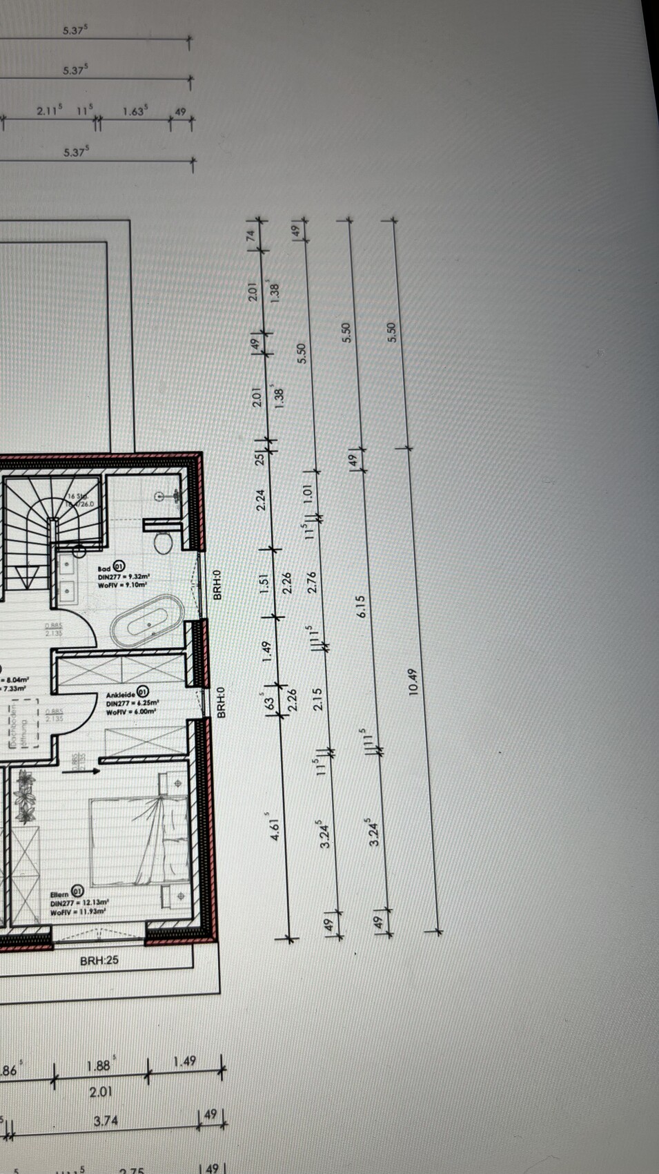

we have had our floor plan designed and are satisfied with almost everything except the bathroom. The layout of the bathroom cannot be changed, but maybe the arrangement can be adjusted.
Our request: a walk-in shower (without glass) and a bathtub.
In the current plan (see photo), the toilet is located right next to the floor-to-ceiling window, which I think would really bother me. Furthermore, the shown shower is not a proper walk-in shower because the wall is only 1 meter (3 feet) long, which may not provide enough splash protection. Would a glass door need to be installed there?
I’m quite frustrated and have been going back and forth in my thoughts but can’t come to a solution. Maybe someone has a good tip.
Thank you!

K a t j a21 Oct 2023 20:10
Without measurements, you probably won’t get any advice.
Does the floor-to-ceiling window only bother you when using the toilet? Otherwise, are you okay with everyone seeing you naked? That’s very generous. Does someone live opposite? 😀

That won’t be possible otherwise, and given the requirements, it is well handled.

Floor plan of a residential house: staircase, bathroom with bathtub, master bedroom, hallways, dimensions.

That would all feel too cramped for me, just to tick off the must-haves of the time. That narrow corridor as an access to the walk-in closet wouldn’t be my thing at all. I would rather plan a spacious bedroom and a more spacious bathroom instead of such cluttered small rooms.
K a t j a21 Oct 2023 21:19
Not helping the woman. The bathroom dimensions are not fully visible.
It's like pulling teeth.
