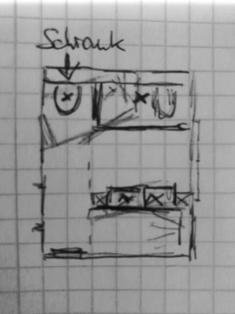

We are currently in the middle of the final design phase and have not yet agreed on the main bathroom on the upper floor.
Attached are part of the floor plan and the current layout as well as an alternative draft.
We want two sinks or a double sink (this will be finalized during material selection), a bathtub, a toilet, a towel radiator, and a walk-in shower. We would prefer the shower to be built with masonry and without a door. However, if space does not allow, we would consider other options.
Our issue with the two drafts is that there is very little space left for additional cabinets or shelves. Unfortunately, we are unsure how to solve this. We are also uncertain whether the sinks positioned on this wall are practical and if noise will be a problem in the bedroom when they are in use. Although the plumbing will be installed within stud walls, we remain skeptical. We are considering swapping the sinks and the bathtub, but this does not seem to provide any additional space either.
Do you have any suggestions for improvements or perhaps completely new ideas?
Then you should reconsider the location of the toilet—especially because if someone uses it, it would block easy access to the washbasin. Even then, there is still enough space to comfortably walk past. Usually, the toilet is used when you are alone in the room, and besides, there is a second one downstairs.
But as I said, we will first discuss this with the bathroom planner and see what comes of it. The drain pipe is still a concern for me, but the architect said it wouldn’t be a problem.

Your last version seems to lack structure to me. Your argument that the neighbors can see inside actually mainly applies to the toilet, so some kind of privacy screen is necessary there regardless.
In your version, the heated towel rail is not accessible from the shower user.

No, since the neighbors are northeast (as seen from the drawing). They don’t see the toilet, but of course they do see the bathtub. Also, your version lacks additional floor space for another cabinet.Well, maybe you should check your scale. While this sketch is drawn quite roughly, as components like tiles, plaster, and so on are not dimensioned, you draw minimal objects in the corners (bathtub) to make sure there is enough space for your three cubes.
That space is definitely also shown in the sketch, for example to the left of the door, but the sketch needs to be drawn consistently.
But anyway: everyone has to decide for themselves how to design their bathroom.
Anyone can also calculate that a bathroom for four people needs to function differently than one for two. But even two people share the bathroom.
And the biorhythm for bathroom use times can be influenced through training as well … it’s overrated anyway.
I don’t understand the whole craze about hiding the toilet as much as possible. These units often end up in dark corners and feel quite uncomfortable. I actually spend more time there than in the shower, and probably even more than in the bathtub.
However, making the toilet the centerpiece of the room goes too far for me. Additionally, the washbasin, which is used practically every time you visit the bathroom, is located furthest from the door—resulting in unnecessary walking. This also means that anyone in the bathroom always has to walk past the toilet.
The cabinets are also located farthest from the washbasin and are too distant from all the other fixtures. Whether items are stored there, in the hallway, or in the bedroom wouldn’t make a difference to me. You end up with cabinets that don’t really serve a purpose (unless all other rooms are so full that nothing else fits).
The towel holder being unreachable from the shower has already been mentioned.
I also find the bathtub visible to the neighbors unattractive (bathing with the blinds closed???). Moreover, it is placed partially under the window, which is not visually appealing either. You cleverly didn’t show that on your 3D rendering. Furthermore, the shower is relatively large and is directly visible from the entrance.
My toilet area is usually tidy, but there are often water spots on the wall and floor in the shower, plus all the shower gels, shampoos, foams, razors, etc. (with 4 people, that definitely adds up). I don’t find that very visually appealing, and in your layout, it’s visible right when you enter. The big advantage of T- and L-shaped layouts, in my opinion, is that you have an open shower but not everyone can see inside directly. This is especially interesting if you want to use the bathroom simultaneously with several people. Mom is showering, son is on the toilet, and daughter is quickly putting on makeup. With this layout, it’s a total disaster.
