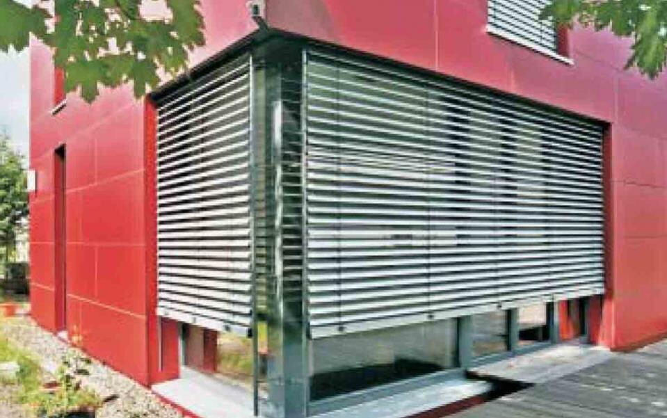

That is true. However, I’ve attached a picture of an external blind – I think it fits perfectly with the Bauhaus style.
Kind regards

That’s true I’ve still attached a picture of an external venetian blind – I think it fits perfectly with the Bauhaus style.
Best regards That’s not what I understand by an external louver system. It will look exactly like in the picture, except our walls will be finished with white plaster.
By external, I mean those awful boxes that are fixed onto the outside wall (on top of it).
It should look like it does in the picture.
