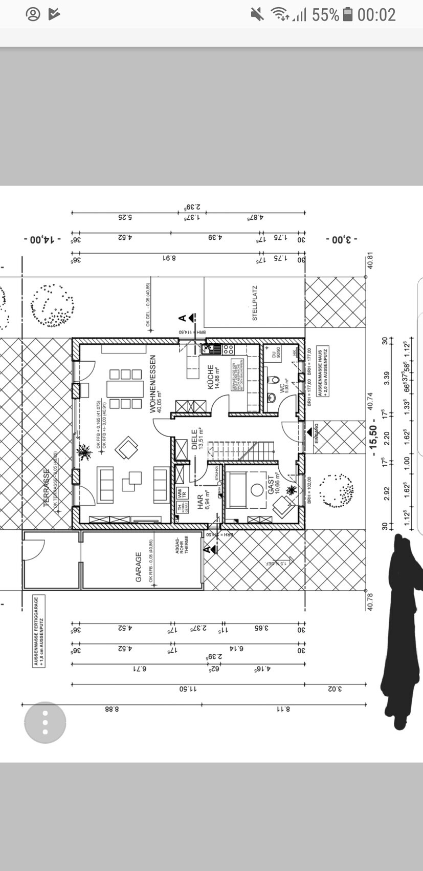

KingSong19 Feb 2018 21:44
A silly question: how can the windows have a clear height of 335 cm (132 inches) when the room only has a clear height of 260 cm (102 inches)? I don’t quite understand...
19 Feb 2018 21:44
Christian NW schrieb:
The living area features a fairly wide window frontage facing south. These patio doors all have a clear height of 335 cm (132 inches) — two doors each 112 cm (44 inches) wide, plus a lift-and-slide door that is 350 cm (138 inches) wide. I hope this helps you get a better idea of the rooms.
We currently have a clear ceiling height of 260 cm (102 inches) planned; the architect mentioned it might possibly be 259 cm (102 inches).
Window height 335 cm, room 260 cm?
Please share the room design including the window details. It doesn’t look excessively high...

I guess it's a typo, 235, it should be the 25cm (10 inches) lintel.

Christian NW
19 Feb 2018 23:55
Window height of 335 cm (131.9 inches), room 260 cm (102.4 inches)?
Please share the room layout including the window and so on.
It doesn’t look too high to me...
The windows are 235 cm (92.5 inches) high. So far, I only have the preliminary draft, so the window height measurements are not yet final...
