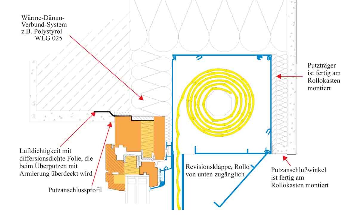

I still owe you this; this is how the roller shutters were installed at the construction site.
Cross-section of ETICS with insulation boards, plaster carrier, inspection hatch, and roller shutter box installation.
