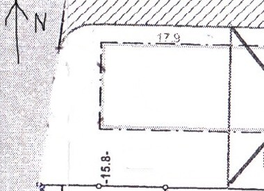

The plot measures 550 m² (5,920 sq ft), with a building envelope 17.9 m (59 ft) wide and 12 m (39 ft) deep.

Additional information about the plot/development plan:
- Not a sloped site
- Site coverage ratio 0.4
- Floor area ratio 0.6
- Corner plot
- Building envelope is set 2.5 m (8 ft) behind the street
- Orientation to the south
- No other restrictions; the storage room behind the garage may extend beyond the building envelope

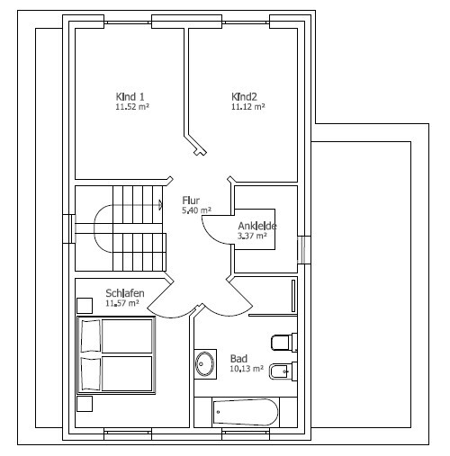

- Since the recessed upper floor is planned with a maximum of 50-60 m² (540-645 sq ft), there will be no large hallway, just the essentials

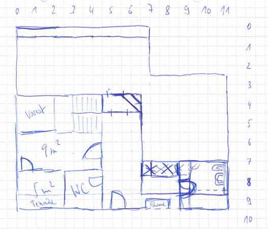

I have already drawn the concept for the dining and living area with terrace, but I am still missing ideas for the entrance area and room layout. The floor plan attached was the first idea, but I have since enlarged the living room (see sketch). Please do not evaluate the doors in the floor plan, as they were inserted provisionally.
As mentioned, the upper part of the ground floor (kitchen, dining room, living room) is almost fixed for me. Only the entrance area with hallway, wardrobe, utility room, home office, and staircase do not yet satisfy me. It would also be nice to highlight the staircase a bit.
I want to plan the upper floor towards the end once I know how many square meters I will have available. The ground floor should have 90-100 m² (970-1,080 sq ft). The shape of the ground floor can still vary depending on the design. Due to the long terrace front in the living room, the house will now be more rectangular. The house/garage should be built directly on the front left property boundary.

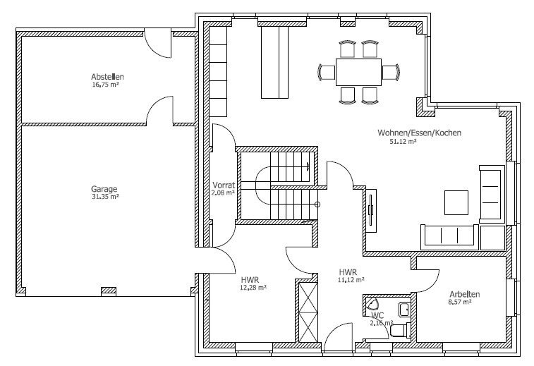

Traumfaenger8 Jul 2017 21:48Regarding your ground floor:
Does the utility room at the bottom left really need to have three doors? Each door takes up wall space, and without a basement, you don’t have much storage area in my opinion. The space under the stairs should definitely be used; this has already been mentioned somewhere here.
The entrance hall seems quite awkwardly shaped and wastes space in my view. Also, for a Bauhaus-style house, I would expect a more open and generous area, meaning no door between the living space and the hall/staircase. The staircase is often a design feature in Bauhaus architecture and can be integrated into the living area, allowing you to omit the door to the stairs and hallway. Overall, I would shorten the hall; you have a narrow corridor going north and another to the right, which just takes up unnecessary space.
The home office looks a bit small for my taste, but if you integrate the staircase into the living/dining area, you might be able to move the wall between the office and living room slightly northward. You gain space by removing the narrow section of the hallway.
I would completely redesign the upper floor, as it looks quite complicated and does not reflect the straightforwardness typical of the Bauhaus style. But I assume the upper floor will be finalized once the ground floor is more clearly planned?

I met with our architect again. We are now planning a slightly more open design for the living area (keyword: staircase). We have also revised the entrance area. The staircase is moving more towards the center, which means the upper floor will be completely redesigned as well.
As soon as I receive the new plans, I will upload them.
