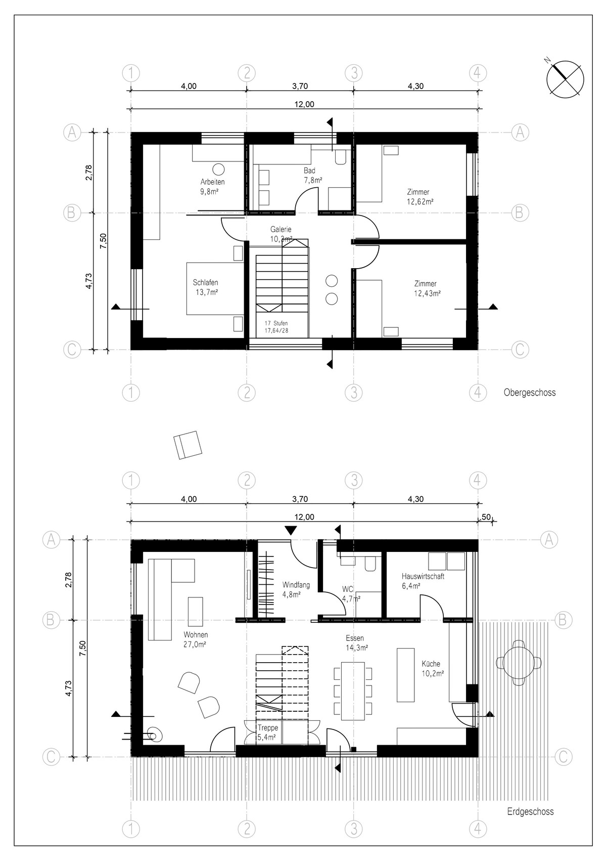

Dear forum members,
We bought a plot of land last autumn and are currently deep into the floor plan design. We would like to share our current draft with you and welcome any comments and opinions.
[F]irst some preliminary information about the plot and its buildability:[/F]
  • 1000 m² (10,764 sq ft) rear plot, southwest facing (so southwest is on the left side of the site plan)
  • Building boundary up to approx. 16 m (52 ft) behind the property line (up to the dashed line on the site plan)
  • No zoning plan (construction according to § 34 of the Building Code)
  • Groundwater at surface level and peaty soil (exact geotechnical report pending), so piled foundation required and no basement
Our requirements were and still are:
  • Affordable! (Our maximum budget for the house including foundation slab is €230,000)
  • Country house style
  • Bright, large windows facing south/garden
  • Open living/dining/kitchen area
  • Family of four, 1 bedroom and 2 children’s rooms
  • Not oversized, max 150 m² (1,615 sq ft), preferably less
House design:
  • Solid construction using Ytong blocks (for us the most cost-effective option, although we would have liked to build with wood as well).
  • Developed ourselves after studying various floor plans (including from the book "Affordable Building with a Small Budget" by Achim Linhardt) with support from architect friends and our planner (an independent civil engineer).
  • Dimensions 12.50 x 7.50 m (41 x 25 ft) (the measurements shown on the site plan are from an earlier draft).
  • What we like: open living area, all main rooms have large windows facing the garden, efficient size, although the children’s and bedroom could be smaller, sewing/work nook behind the stairs upstairs, plenty of wall space for large wardrobes in the upstairs bedroom and hallway on the ground floor, light shaft in the stairwell, staircase (we originally wanted a straight run staircase but it would have taken too much space; the one with three quarter turns is also fine with us).
  • What we don’t like 100% yet: the height of the house from the outside. It is currently planned as a two-story house with an eaves height of 6.2 m (20 ft), with the ground floor 2.84 m (9 ft 4 in) high and the upper floor 2.60 m (8 ft 6 in) high. The gable roof will be an uninsulated, unfinished cold roof, mainly because of the economical prefabricated truss construction method. This is a bit disappointing because I really like sloped ceilings and did not want the character of a townhouse. Lowering the roof with a knee wall of about 1.90 m (6 ft 3 in) and an insulated roof with open sloped ceilings would probably be more expensive due to the rafter/beam construction. We would also lose the garden view through the floor-to-ceiling bedroom windows.
Now for our questions:
  • Simple: What do you think about the floor plan?
  • Can you still imagine the relatively tall two-story house having a country house character? Maybe it depends on the facade design and choice of materials? Do you think it looks too “blocky,” especially from the front entrance side? Or would a lower eaves height with an attic conversion including a knee wall be preferable?
  • We are still unsure how to arrange the windows on the garden side. The drawing with the elevations shows two possible versions. We actually prefer it when the upper floor window is centered over the lower window front. However, this does not align the interior line of sight from the entrance door to the garden/patio door (see ground floor plan). This represents version two; for version one, the window front would have to be shifted about one window width to the right, so that the patio door is behind the dining table. With the window front shifted left, the interior looks better to us, but from the outside it looks strange if it is offset from the upper floor window, right? What do you think?
That’s it for now regarding our project. We really look forward to all your opinions!
Floor plan of an apartment: three bedrooms, bathroom, hallway, stairwell and furniture.
Floor plan of an open living and dining area with kitchen on the left, sofa on the right, stairs.
Two sketches of a two-story building with balconies, windows and doors.
Modern two-story house with white walls, gray roof, balconies and purple side wall.
3D model of a two-story house: white main part, purple extension on the right, roof and windows.
Site plan: large blue building, carport and shed on the right; subplot 2 1000 m² (10,764 sq ft)

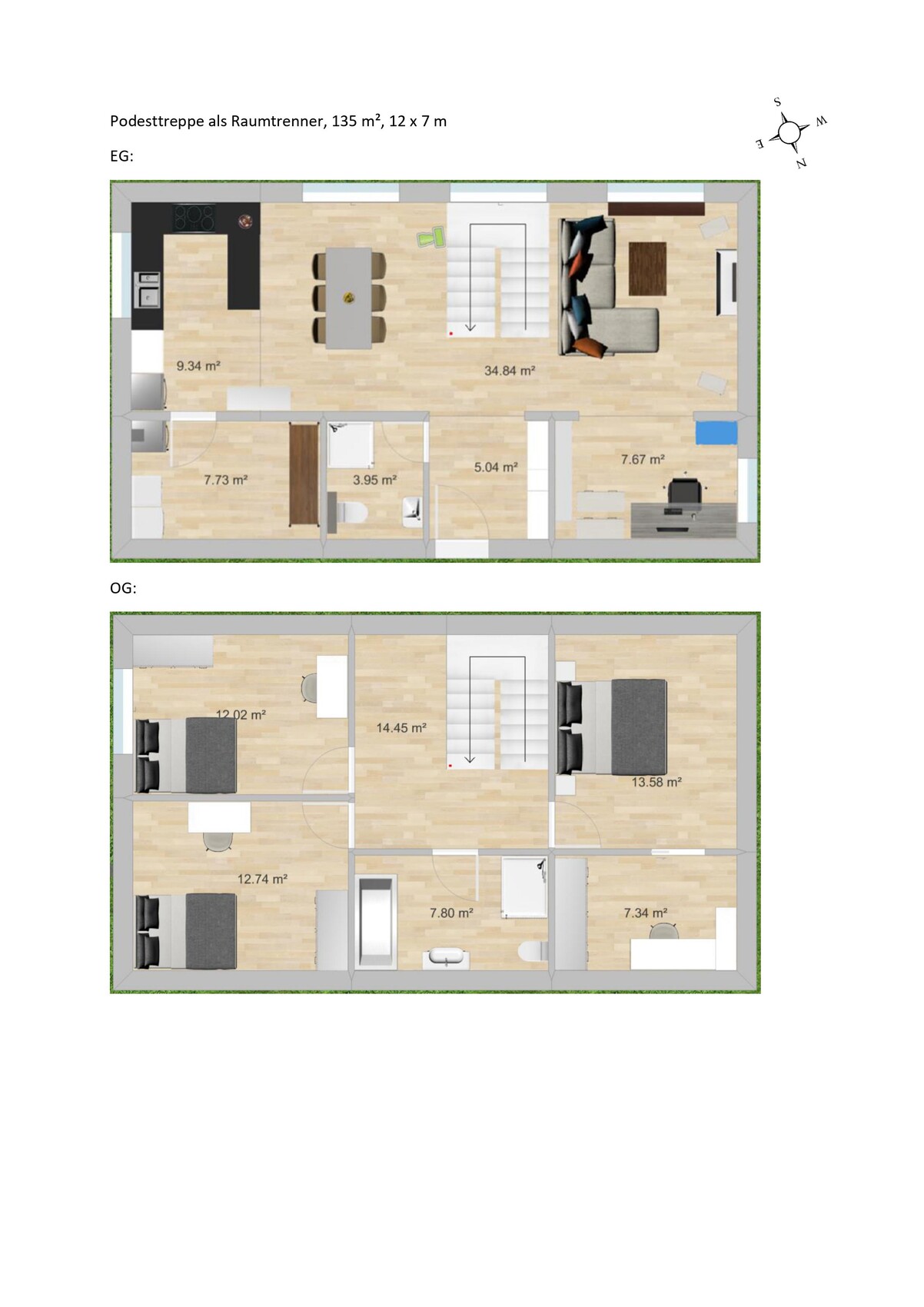

la.schnute13 Mar 2020 11:22
Oops, forgot the attachment. This time with a north arrow as well.
Floor plan of a two-story house: ground floor and upper floor with room sizes in m².
Floor plan: ground floor living room, kitchen, dining area; upper floor bedrooms, study, bathroom, room.
Matthew03
13 Mar 2020 11:26
la.schnute schrieb:
because of its sound system
Was there a more detailed explanation about this in the previous 41 pages? That makes the openness even more questionable.
Tamstar
13 Mar 2020 11:51
la.schnute schrieb:
OOPS, forgot the attachment. This time with a north arrow, by the way
I think it’s better this way. Originally, I considered mirroring the upper floor so the kids would have the southwest side, but that would complicate the staircase again.
I can’t really assess the objection regarding the sound system or whether it’s justified.
Pinky030113 Mar 2020 12:04
Could you please explain that? From my experience with sound systems, there are usually speakers placed behind the sofa. In that case, having a wall or staircase there would actually be an advantage.
la.schnute13 Mar 2020 16:02
Matthew03 schrieb:
Was there a more detailed explanation about this in the previous 41 pages? That does make the openness a bit more questionable.
Pinky0301 schrieb:
Can you explain that? I’m familiar with sound systems where speakers are placed behind the sofa. In that case, having a wall or stairs there would actually be beneficial.
I’m not very familiar with this, but my boyfriend says he needs to install two small speakers about 1 m (3 feet) behind the sofa. Apparently, they can’t be placed directly against a wall behind the sofa (please don’t ask me why). He’s an acoustical engineer at Teufel and isn’t very willing to compromise on this. It’s really his big passion, so to speak.
