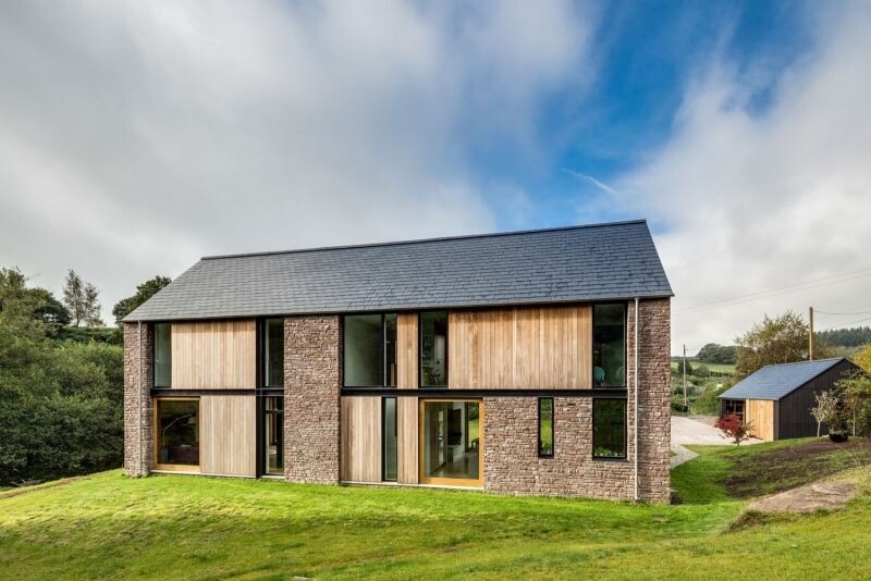

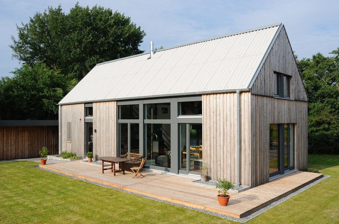

I also mentioned at one point that I’m not entirely sure whether "country house" is the right term, as the word often brings to mind much “cuter” houses (in the sense of being more ornate), as you said. What I mean is a modern interpretation of a country house, so I’ve attached two photos for illustration. And yes: I pretty much know what I want. Which I consider a good thing.
That’s why my main focus in this forum has been on detailed questions, exactly. Not on the overall concept.
If it’s going to be achievable within our financially tight budget, you are welcome to express concerns. The good thing is that by managing the construction ourselves (but still buying materials at wholesale prices) we can adapt the planning during the build and stay relatively flexible. So if we can’t afford tile A or toilet B, we’ll just opt for cheaper versions. I have also mentioned several times that in an emergency we can get a financial boost from family, but that won’t initially be considered within the €230,000 (230,000 euros) budget.
You are especially encouraged to raise CONCRETE budget concerns, meaning regarding the design of specific areas. It won’t be missing walls in the open-plan ground floor, nor the comparatively small floor area, the rectangular building shape, or the fact that it should look "modern." Modern does not automatically mean expensive; sometimes it means reduced and simple. It might be the windows. So I asked for concrete suggestions about them. Where would you save? How would you arrange them? And yes, I hoped and still hope for suggestions that retain the basic idea, like @Nordlys, @chrisw81, @11ant, and a few others have done. Thanks again for that!!! By the way, the Lokstedt house cost €250,000 (250,000 euros), which I think is a very good price for a 2016 build. Honestly, I would have guessed higher.
What bothers me about the facades is just the rigid rhythm of the windows in a Hanseatic style (and the numerical overdosing of the floor-to-ceiling windows).
Yes, you mentioned something similar at the beginning. How would you loosen that rigid rhythm? I’m really running out of ideas… Floor-to-ceiling windows, sure—we can do half-height windows upstairs. That will definitely be on our cut list if it becomes too expensive—not at the very top but not at the bottom either. I will also consult my architect friend in the next few days about window arrangement (and possibly savings), if we can find time to meet before any possible curfew.

Climbee17 Mar 2020 07:43
Saving money: I remember an episode from the series "Dream Houses" on BR, where the homeowner, because she also needed to save, chose an industrial roof. Maybe worth checking out?
