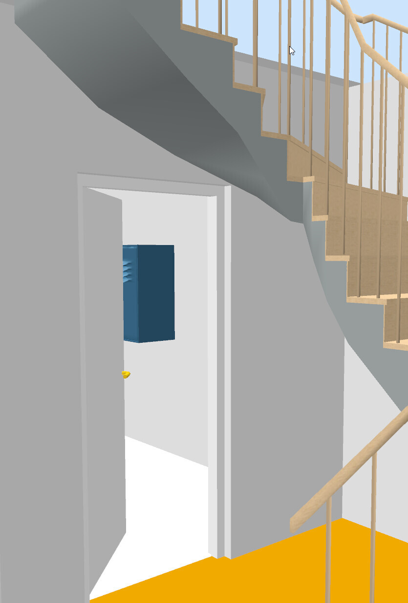

kbt09 schrieb:
The door to the utility room won’t fit under the stairs.
Maybe the software is lying...

Stairwell scene: white door, blue cabinet behind; stairs with railing; orange floor
Tolentino12 Mar 2020 21:22
Oh, HAR is located in the north and close to the street to keep the pipe runs as short as possible.
