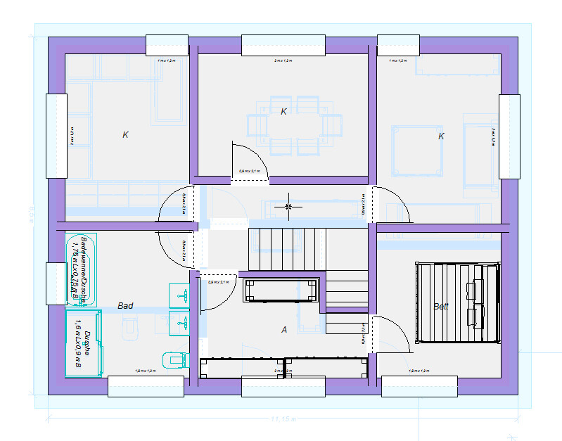

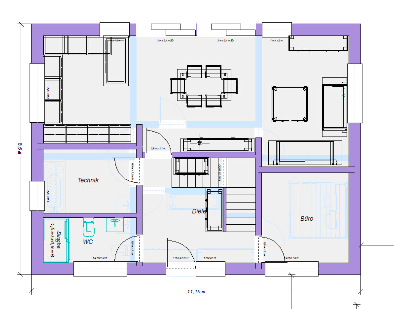

But even if you follow this suggestion, I wonder if a more square floor plan (-> town villa style) would be better?
Like this, for example:
Then parking space might be tricky, right?

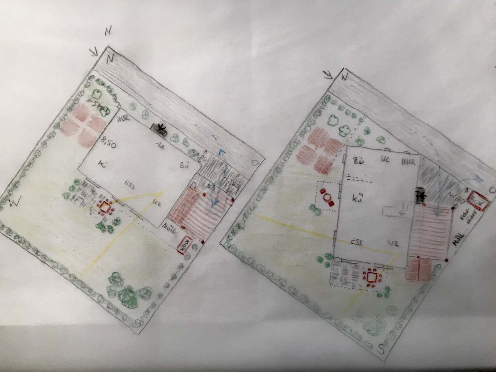

To be honest, it would really suit my nature to position the house at an angle. For example, my desk in my office is also angled. So it’s not that I want to avoid conventions (although the building permit/planning permission for a diagonally positioned house might still be an issue to discuss).Why worry about conventions? Just because many don’t feel the need, or aren’t creative, or often the local development plan/planning regulations (roof ridge orientation, building line, etc.) get in the way? Take a look at your Google site plan you posted earlier: half of the houses in the neighborhood are similarly angled.Tolentino schrieb:
But from my perspective, what’s really unacceptable is the restriction on available space.But you don’t actually have that issue. Look, I got a little creative
I won’t comment on the design quality here. The point is your concern about losing part of the plot or garden... Both have their pros and cons and could be improved.

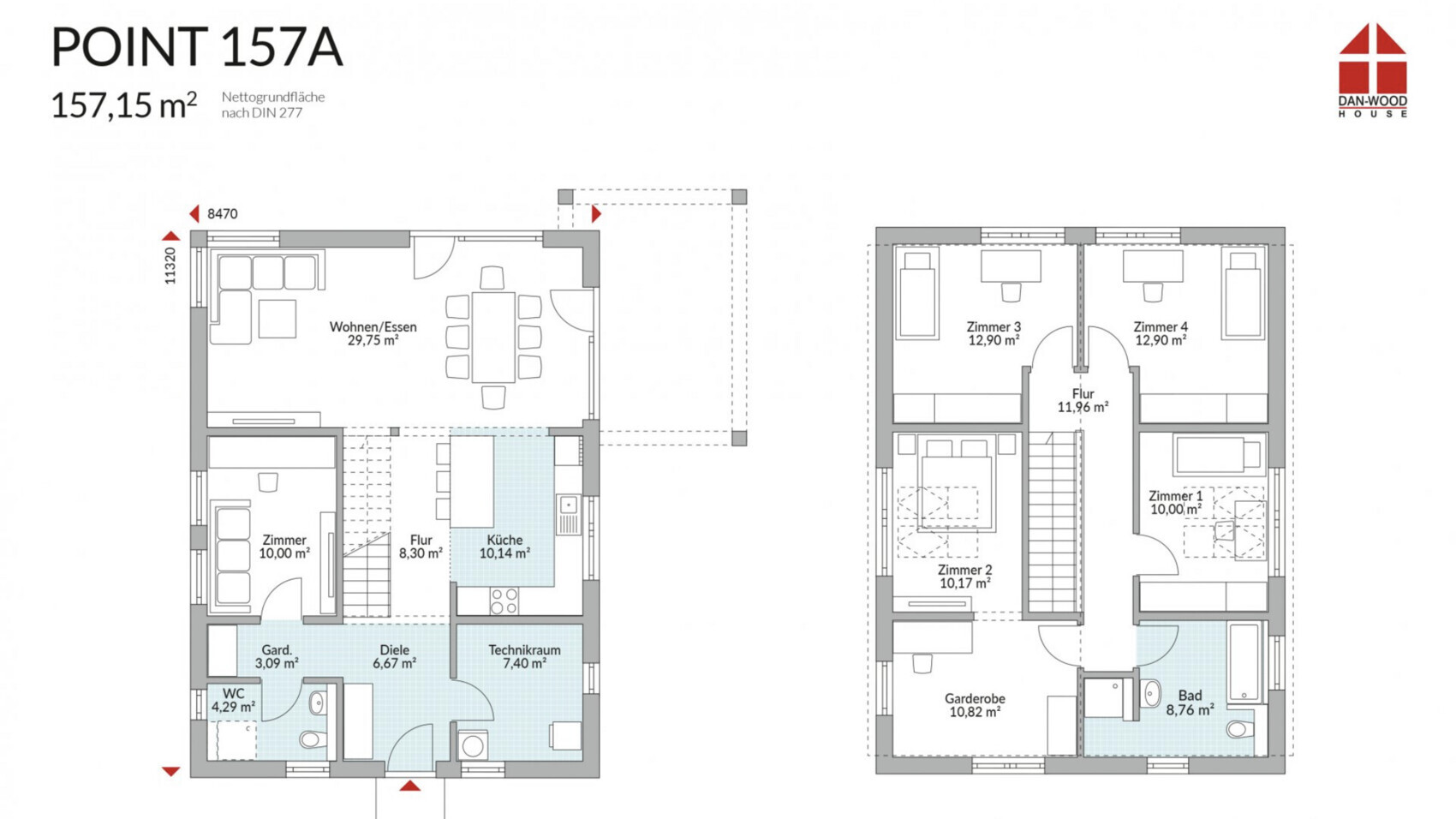

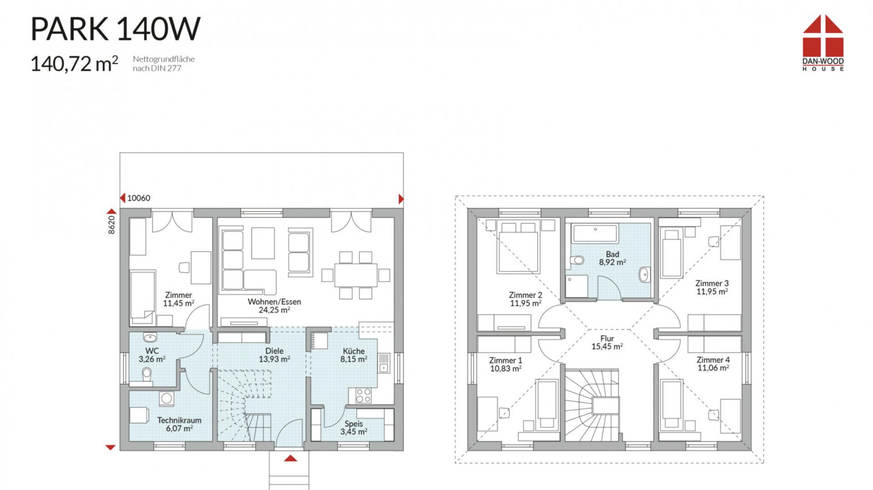

I was referring to the Scan SH 142 XXL model. It is a single-story, but there’s no problem making it two stories. However, I should note that the budget probably won’t cover a two-story house. But of course, you can do a lot yourself.
Here is the floor plan, plus some from Danwood with a somewhat blocky aspect ratio:
I think these give you some inspiration. By the way, you could also position the house rotated the other way, parking the car in the resulting “triangle” between the house and the 5-meter (16 feet) property boundary. Since your south-facing orientation is at the narrow end of the plot, you will benefit from good sunlight, a garden, and a terrace, provided you can see the potential in positioning the house diagonally.

I also like the evening sun. Exactly. In summer (June), the sun sets in the northwest. Only by September does it set in the west. You would have both, and any attentive reader here knows that south-facing gardens are overrated. Often too large. Try using a sun position simulator like Sonnenstand dot de or similar to visualize it.
Also: you can turn the car around. If everything is arranged cleverly, a visitor might even park there. In the north of the house, in the triangular area, you could create an emergency bay. No one will really measure later on as long as you stay within 5 meters (16 feet).
By the way, you could also position the house diagonally the other way and place the car in the triangular space created between the house and the 5-meter (16 feet) boundary. Since you have a south-facing orientation at the narrow end of the plot, you would still benefit from the terrace, garden, and natural light. Provided you recognize the potential of the diagonal layout That sounds interesting, especially since the house and terrace wouldn’t face the street, which is a key point for me.kaho674 schrieb:

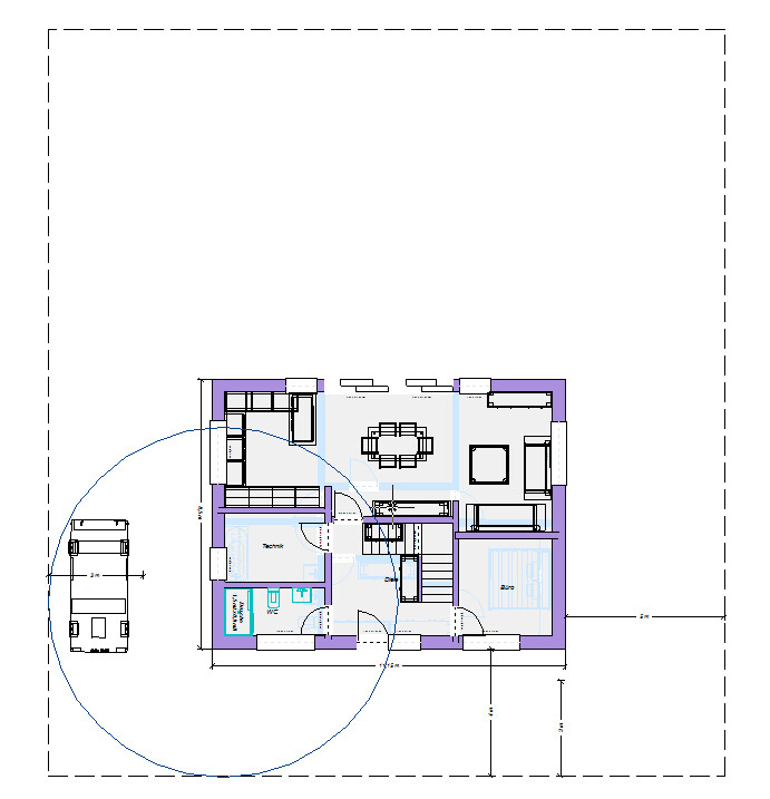

You can’t expect to park at a 90-degree angle on a 3-meter (10 feet) wide street. That’s not possible unless you add another meter (3 feet) and take 5 minutes each time to maneuver. Or use a crane.
However, I don’t understand why you insist on a square shape: it’s easier to fit three kids’ bedrooms in a more elongated layout, and that’s easily achievable here without any strain. Already pointed that out back then!!!

Another one in landscape format. If the turning radius gets too tight, I would plan for 5m (16 feet) to the property line at the bottom of the plan. It currently shows 4m (13 feet).
(The staircase is not a landing)
