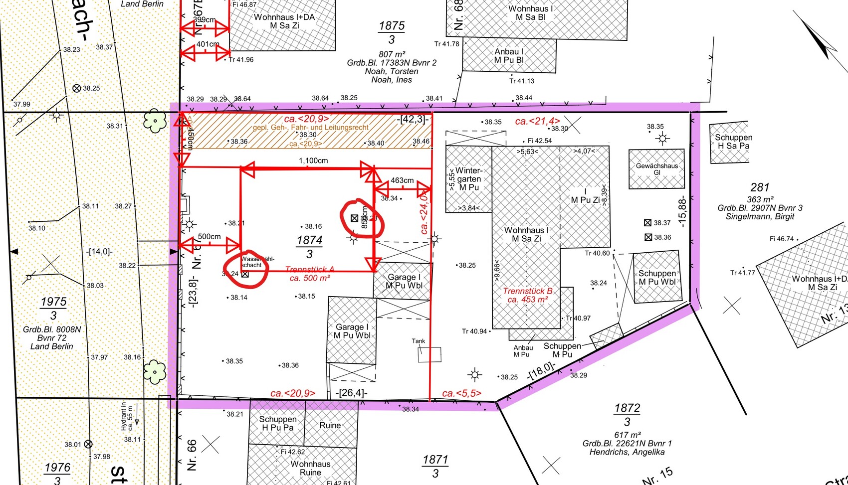

Hello, dear everyone!
I hope you are all doing well these days.
So, unfortunately, the angled orientation is off the table again after an initial planning meeting with the builder. He (i.e., the managing director and our site manager from the construction company, who has connections with the building authority) said we most likely won’t get approval for it. Although there is no official zoning plan, the neighborhood’s building alignment generally follows the adjacent street/property boundary within about plus or minus 5°. Our proposed angle is more like 20–30°, so that won’t be approved.
Back to parallel with the property boundaries, then. I actually liked the last plan from @kaho674 quite a bit because it incorporates many of our wishes in terms of space. The only thing that still bothers me is that the entrance isn’t on the parking side (which might become a carport later). Is there any way you could work some magic here?
I also have another question.
On the attached preliminary survey plan from the surveyor, you can see (circled in red) two existing shafts. The one closer to the street is a potable water transfer shaft, and the one further away is a well.
Is there any way to make use of these at the planned house location? Or would they have to be removed and rebuilt?
Good luck, stay healthy!

He (i.e., the managing director and our construction manager of the house building company with connections to the building authorities) said that we most likely won’t get approval. Although there is no official zoning plan, the neighboring buildings are always aligned with the adjacent street/property boundary within +/- 5°. Our angled orientation is more like 20-30°, and that won’t be approved as is.Then he should explain to you the other houses with angled orientations. Honestly, I wouldn’t arrange this with that guy, but rather with the building authorities—assuming you want to proceed.@ypg: He cleared this with his contact at the building authority. I actually find the angled positioning quite appealing despite initial concerns, but after the informal check, I don’t think a paid building inquiry is worth it for me. And definitely not a rejected building permit application.
And take a look—there really are no angled houses in the neighborhood. They are all aligned parallel to the property boundaries of their parcels, the street they belong to. Deviations are at most about 5° and only in one or two houses in the next block.

You can discuss such an "unusual" request with the building authority in a short appointment. You don’t need to prepare all the documents right away. A hand-drawn sketch is sufficient, along with a reasonable explanation—such as the difficulty of parking and maneuvering. Everything should be clearly sketched and presented in an understandable way. If that’s what you want, I would prefer to see it for myself rather than assume otherwise. It only takes a bit of time.
Maybe I should have written this in more detail, but I had already discussed everything exactly like this with the site manager and his contact person.
I mean, they talk regularly; they studied together. The head of the authority and my site manager...
So, I don't really see much point in it now, except that my site manager might consider me a "difficult customer."
