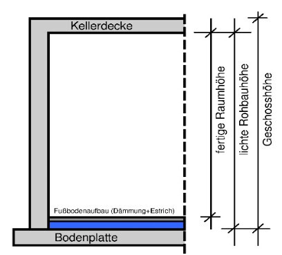

Tolentino schrieb:
You asked about a structural height of 2.75 m (9 ft). Structural height is different from floor-to-floor height.
There is floor-to-floor height:
This is the distance from the unfinished subfloor of one level to the unfinished subfloor of the level above. Floor-to-floor height covers the complete height of a story, including the entire ceiling thickness and the floor structure.
Structural height and clear room height:
It is important to distinguish the clear room height from structural height, which is defined as the distance between the top of the unfinished subfloor and the underside of the unfinished ceiling—meaning without including the floor structure and the ceiling plaster. The final clear room height is determined after subtracting the height of the floor structure and the ceiling plaster.
Source: Wilms Haus AG
And a staircase always needs to cover the floor-to-floor height.
@kbt09: Thank you for the clear explanation and the picture. Ok. So, we never discussed floor-to-floor height with the site manager. In my opinion, it was about the difference between the clear shell construction height and the finished room height. Here, he mentioned 20-25cm (floor construction in the ground floor) (8-10 inches). Is that realistic?
