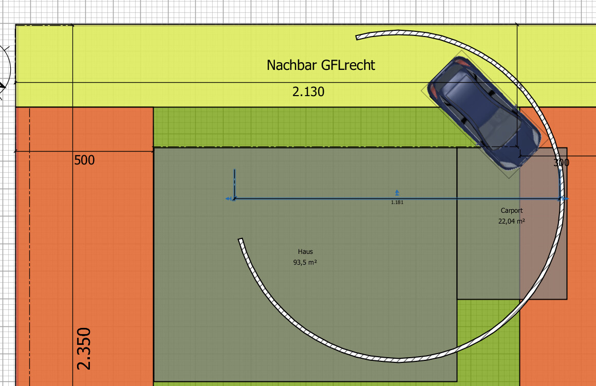

If you look up “turning circle” on Wikipedia, it is explained there.
Based on that, I added a curved wall using the turning circle to the site plan. This should be correct and shows that it works.
It’s not really very convenient, though.
Maybe I’ll just make the carport, which will be added later anyway, larger—it is allowed to be built right up to the boundary. Until then, it’s not a big problem for me.
For your information about why there is no parking space in front: I am really not allowed to put an auxiliary building or parking space there. That’s why I would have had to mark the 5m (16 feet) strip in front in dark red.

Are there any standard turning circle measurements for average cars anywhere?Even a Smart needs 9.1 meters (30 feet), so about half, 4.5 meters (15 feet).kaho674 schrieb:

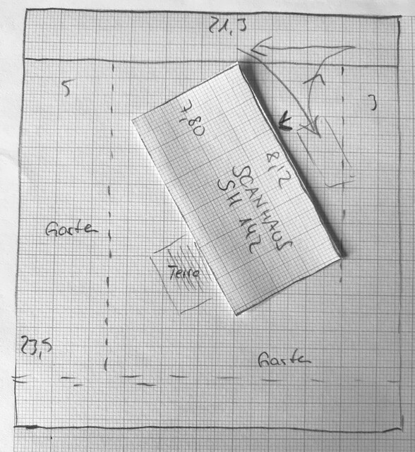

I’d probably set the house even further back. Parking out would be a pretty long reverse drive, wouldn’t it?Then there would be no garden left.Tolentino schrieb:
Sorry, but I already showed this in the sketch above. It needs to be more square because otherwise it doesn’t fit inside the building boundaries (building permit / planning permission).No. I prepared something: the Scanhaus Marlow Marlow with 3 children’s bedrooms on the upper floor, office and utility room... I’m not saying it’s the perfect house, but it illustrates that you need to extend more in length rather than width if you want to fit in more rooms, even if they are small.
Tolentino schrieb:
It’s understandable because the diagonal, which is always longer than the longest side, hits the shorter side of the building envelope.That’s clear. Tolentino schrieb:
I feel that with your idea I’d have much more area facing the neighbors’ property line, where I certainly wouldn’t sit in a deck chair if neighbors or their families walk by at any time.So what? A plot must offer more than just space for a deck chair. That’s really the least of it. Ideally, a plot should also function as a yard or courtyard.Tolentino schrieb:
Yes, a long reverse drive would always be necessary either when parking in or out.
Standard turning radius is 10–12 meters (33–39 feet).Exactly. Tolentino schrieb:
Following this, I added a curved wall with the turning circle into the site plan. It should be correct and shows that it works.Good luck with daily maneuvering! Tolentino schrieb:
There’s also space behind the carport for all the kids’ stuff.The carport is off the table: the posts will make maneuvering even more difficult.With the angled position, your windows won’t be right up against the hedge...
You’ll gain space and multiple functional areas on the plot.

For me, that means the longer side needs to be shortened while the other side is lengthened to maintain the floor area—making it more square.
I never claimed that a square house is better.
That’s exactly why I chose an unequal rectangle from the start.

Have fun maneuvering every day! I think my model shows you don’t have to maneuver. You drive straight in, turn fully, and drive straight out again. Even with a Touran.
Reversing 16m (52.5 feet) in a straight line is more likely the challenge.
Carport is off the table: the posts make maneuvering even harder for you. A carport can be built as a border construction and be recessed behind the house edge. I don’t think it’s as bad as you imagine.
With the angled positioning, your windows won’t be right next to the hedge...
You gain space and several functional areas on the plot.
I’ll stop now; I don’t want to persuade anyone of something that’s obvious.
You’ll figure it out. It’s not that obvious to me. Others don’t see it as ideal either.
Honestly, I would actually be fine with the angled orientation. My desk in the office, for example, is also angled.
So it’s not that I want to avoid breaking conventions (although the building permit / planning permission for an angled house might be another topic).
What I can’t accept is the limitation on floor area. The maximum possible area is definitely smaller than with a straight alignment. Besides, I already consider the area north(northeast) of the house lost because I’d have to give up space in the south...
