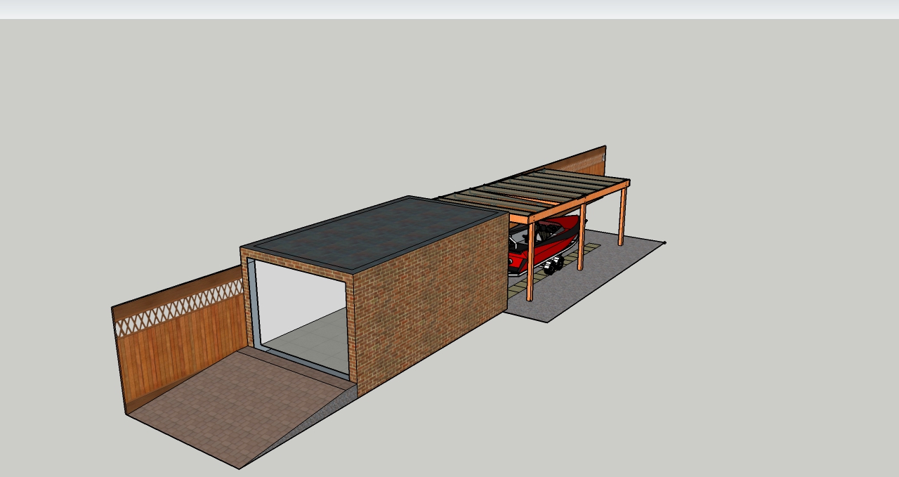

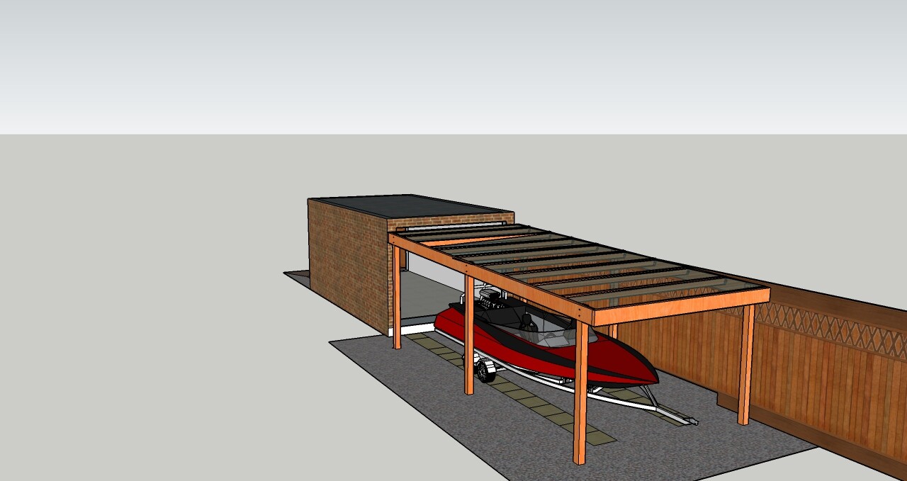

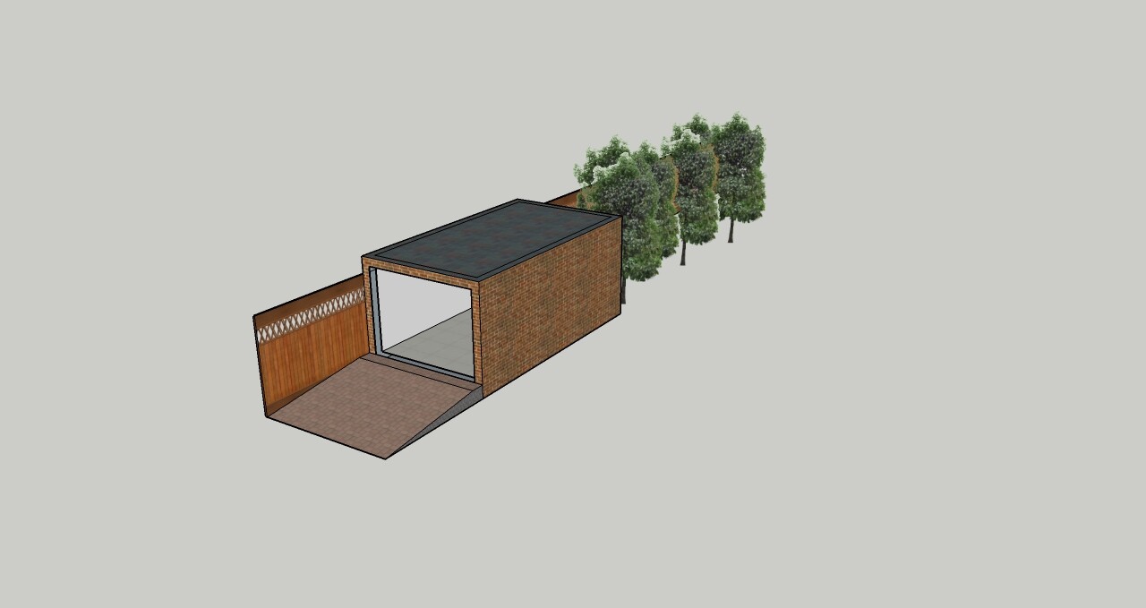

To clarify, I have created some sketches:
Current situation: neighbor’s garden borders behind the fence
Plan with the carport behind the garage:
Rear view:
Rear view:

Just search for boundary construction regulations in NRW.
You are allowed to build up to 15 meters (49 feet) along the property boundaries, with a maximum of 9 meters (30 feet) in a continuous section.
You already have a carport of 6 meters (20 feet) and a garage of 5.60 meters (18 feet 4 inches), which adds up to 11.60 meters (38 feet 1 inch).
So you can still extend by 3.40 meters (11 feet 2 inches) on one side or the other.
alphawave schrieb:
I will probably need a building permit / planning permission for the carport as well. But no (written/official) consent from the neighbor, right? I think the maximum length of 9m (30 feet) applies to a "continuous" garage? The regulation does not apply to individual components but to the boundary of the building plot. Therefore, the lengths are added together; otherwise, the rule would make no sense, because everyone could fully develop their plot with components each up to 9m (30 feet) long.
So unless the building authority is completely inattentive, you will need a corresponding easement from the neighbor for the project. If the other separate garage is 6m (20 feet) long, the boundary development adds up to 6m (20 feet) existing + 5.6m (18 feet) existing + 6m (20 feet) new carport = 17.6m (58 feet). The allowed length is 15m (49 feet), so you will need an easement on the neighboring property, adjustable within the old/new boundary development, measuring L x W = 2.6m x 3m (8.5 feet x 10 feet).
