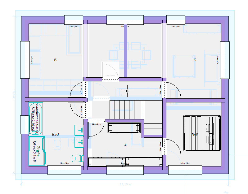

Hello again,
I wanted to share the floor plans here for your consideration.
Variant 4 is essentially based on the version from @kaho674, but adjusted to fit the furniture layout we are planning.
Variant 3 is my attempt to place the entrance on the parking side.
I think both options have their pros and cons.
I have also uploaded the preliminary site plan from the surveyor again.
Key questions have been answered in post #79.
Thank you very much for your contributions...

Regarding option 4 kuckmada: https://www.hausbau-forum.de/threads/efh-Flachdach-waldrandlage-175-qm.30201/page-15#post-390926 – recently, @kbt09 illustrated the issue of headroom problems with stair landings that are partially built over.
Tolentino schrieb:
If I can’t park there, I’ll just put the parking space somewhere else. The neighbors do the same, either in front of or next to their houses.
Huh? I thought parking in front of the house was prohibited, forbidden, illegal, against regulations, off-limits, not allowed, irregular, unwanted, etc.? Could it be possible after all?
illustrating the head clearance issue at built-over stair landings.I can’t speak for the original poster’s designs. But I did calculate it, of course. (I’m a bit disappointed now—what do you think of me? ) The ceiling height / story height is assumed to be 2.60m / 2.90m (8 ft 6 in / 9 ft 6 in) and the head clearance is over 2.10m (6 ft 11 in).What I don’t quite understand: You insisted on having 3 children’s rooms, but now you’re building only 2 that can be separated later?
If that’s what you want, it would be much more elegant to evenly divide the children’s rooms right from the start and add two walls later on. Disturbing windows could be split into two smaller ones instead of one large window. You just have to be careful how you install the electrical wiring and heating.
However, I think putting a closet in the upstairs hallway is nonsense. It’s already too tight there. All other changes don’t work for me either (obviously— ). Above all, the living room door has to open into the living room to avoid immediate door chaos. The coat rack can partly be placed under the stairs, etc.
I don’t like the entrance from the side at all—but maybe there are other solutions for that.
@kaho674 … this concerns the encroachment of the lower stair steps in the ground floor, which becomes necessary on the upper floor to access the master bedroom.
For people taller than 180 cm (5 ft 11 in), going downstairs there is uncomfortable. Therefore, especially with floor-to-floor heights up to 295 cm (9 ft 8 in), which usually corresponds to a clear ceiling height of around 260 cm (8 ft 6 in), it might be better not to include this already in the initial design sketches. From experience, more encroachment is usually required during detailed planning.
kbt09 schrieb:
@kaho674 ... this is about building over the lower steps on the ground floor, which is necessary in the upper floor to access the master bedroom.I understand. The plan would need detailed calculations anyway. In my sketch, I calculated 2.14m (7 feet) whereas you have 2.02m (6 feet 7.5 inches). I find that acceptable. If that is not enough, the house will just have to be made deeper. This probably involves only a few centimeters (inches).
