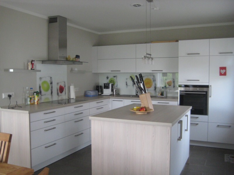

we have 10.5 sqm (113 sq ft) for our kitchen (also without a table), and it is really spacious and sufficient. Instead of a cooking island, we have a preparation island that measures 1 x 1.40 m (3.3 x 4.6 ft). A kitchen doesn’t need to be large, but there must be enough space to work comfortably.
