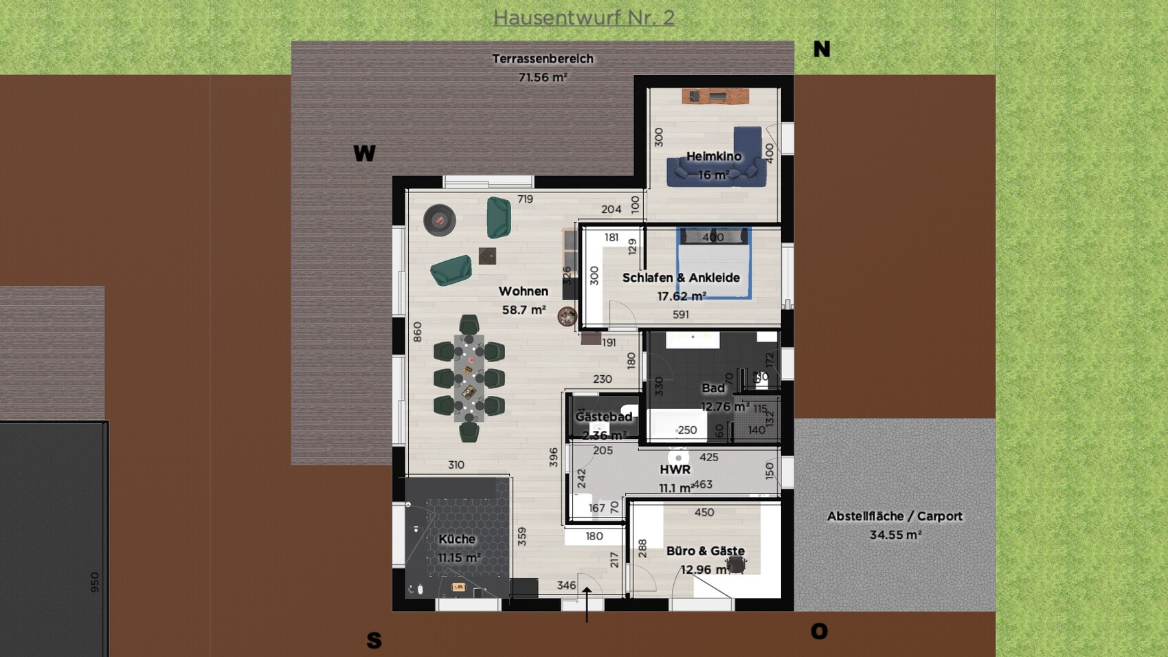

Sorrow87
17 Jan 2022 16:29
Gudeen. schrieb:
I would actually prefer a completely different layout for the rooms and the house itself—living areas more toward the south, home cinema somewhere on the north side, possibly not square with more garden/windows on the SW-SE side or similar... but that depends on the plot and surroundings.
Do yourselves a favor and orient it like this: the cinema in the NE, the kitchen in the light with at least 2 sqm (22 sq ft) of window area. If you have to cut back to 20 sqm (215 sq ft) for cost reasons, move the cinema into the attic. A gable roof allows for many possibilities.
Thanks again to everyone here for your replies. We have carefully read your ideas, critiques, suggestions, and improvements and tried to implement some of them in a second draft. The title should now state 143 m² (1,538 sq ft) instead of 172 m² (1,851 sq ft). We managed to remove almost 30 m² (323 sq ft) from the design. We are satisfied.
We would appreciate your honest opinion on this as well. The utility room is now narrow but quite long. The home cinema protrudes as an angle. I expect this will be discussed here too, since an angled corner is indeed more expensive. There is even a guest bathroom now, though it is very, very small. 😀 The entrance area is not separated. Some might not like that, but we actually find it nice to enter directly into the large room.
The design includes some placeholder elements. These are the cabinets in the dressing room (60 cm (24 inches) deep), the built-in closet for shoes, jackets, coats (60 cm (24 inches) deep) in the entrance area, and in the guest room a desk (70 cm (28 inches) deep), a pull-out sofa bed for guests (can be up to 2.0 m (6 ft 7 in) long), and shelf space 60 cm (24 inches) deep.
We are now planning with a gable roof. The carport should have enough space for 2 cars in this design.

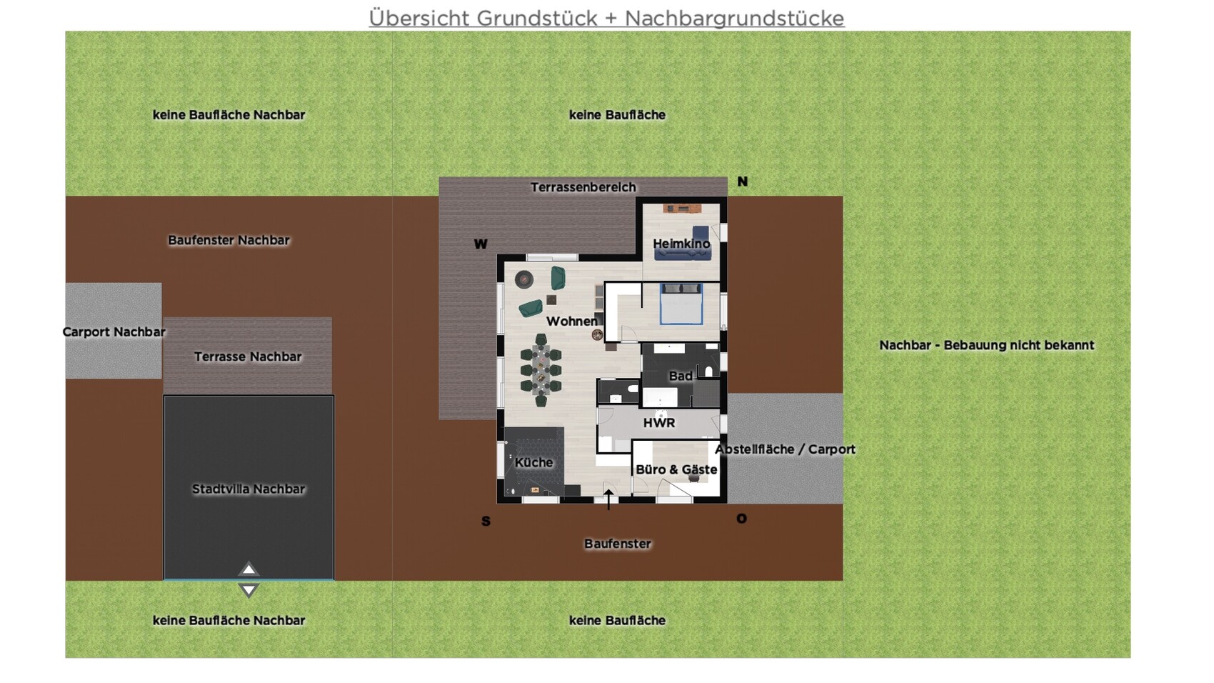

Additionally, there is an overview showing the neighboring plot, illustrating how the neighbor builds.
Thanks in advance for your feedback.
Floor plan: House design No. 2 with living room, kitchen, bedroom, bathroom, home cinema, utility room and terrace.
Site plan: House floor plan with living, kitchen, bathroom, utility room, office & guest room, terrace.
17 Jan 2022 18:09
Kreisrund schrieb:
This is definitely not true in general. We have a bedroom window facing directly east, and I wouldn’t want to miss that at all. We benefit from it almost all year round, except around June, either during the week or on weekends. Of course, how important this is depends on the individual.
That’s why I asked the original poster about their reasons. Maybe the kitchen table would be better placed on the east side?
Regarding the new plan: I find the approach... _approach_ clearly better.

Sorrow87 schrieb:
We are satisfied.
Look, that’s great. Not because you changed anything for others, but because you kept an open mind. Don’t lock yourself unnecessarily into a roof shape or other things. Make sure you find exactly your floor plan that includes the sensible points mentioned here. Then there’s still plenty of room for attractive individuality, which I really like, given all the blandness nowadays.
Sorrow87 schrieb:
There is now even a guest bathroom. But it’s very, very small.
That’s enough.
Sorrow87 schrieb:
The entrance area is not separated. Some might not like that. We actually quite like entering directly into the large room.
We have the same; the entrance is part of the living space, and we like it.
If I’m reading correctly, you have nearly 70sqm (750 sq ft) of area including the kitchen for the so-called open-plan living space; I would prefer an open or semi-open kitchen so you really feel right in the middle of that beautiful, large room.
I believe a planner or someone here could help undo the boxed-in feeling around the bathroom/toilet/bed area. Somehow, I think the utility room would also be better placed near the front, and perhaps the much-discussed extra toilet could even be en-suite with the guest room, reducing the number of doors or toilet accesses opening directly into the dining area.
Würfel*
17 Jan 2022 19:43
I would approach it quite differently:
Position the bungalow as far to the right as possible to create some distance from the neighbor to the southwest, so they don’t block your sunlight. Place a carport to the right of the house. If you need an additional parking space, put it in front of (planunters) the carport or as an uncovered spot to the left of the house. Then, orient the living areas toward the garden to catch the southeast sunlight from above or behind, for example with a staggered shed roof featuring windows facing southeast or other roof windows.
Alternatively, consider the typical L-shaped bungalow, where the upper part of the (mirrored) L further distances you from the southwest neighbor.
Why? For me personally, the view is very important. Feeling comfortable includes being able to look out at a nicely landscaped garden, especially when there are no neighbors directly opposite!
A terrace depth of 3 meters (10 feet) is borderline; I’d prefer 3.5 meters (11.5 feet), otherwise you won’t be able to walk behind the chairs if you have a table with a depth of 1 meter (3 feet). I wouldn’t make it that long, though. You’re not going to fit three tables on it, right?
Sorrow87
17 Jan 2022 22:31
That’s why I also asked the original poster what arguments they have. Maybe the kitchen table would be better placed in the east?
We also agree with the argument from @Kreisrund.
Regarding the new plan: I find the approach... _approach_ much better.
Concerning the bathroom locations, I would like to point to this thread:
Thank you very much. What do you mean by "approach... _approach_" 😀
So there’s still a lot of room for improvement?
Thanks for pointing out the bathroom positions and the reference to the thread. Apart from the fact that the thread was a bit rough to read, it is extremely helpful. Not just regarding the toilet location... 😀
One idea would be to extend the wall from the dressing room straight down to the utility room to clearly separate the entrance area toilets. Would that make sense? I just don’t want the southwest area to feel like a narrow corridor. With a length of 13 meters (43 feet), what would be a minimum width for the living area? I quite like the room arrangement in the northeast, but somehow I feel there is still potential to improve it further. Somehow, though, I can’t quite solve this Tetris level with extra stars 😀
Sorrow87
17 Jan 2022 22:43
pagoni2020 schrieb:
We have it the same way; the entrance is part of the living area, and we like that.
If I’m seeing it correctly, you have just under 70 m² (750 sq ft) for the so-called open-plan living space including the kitchen; I would personally prefer an open or semi-open kitchen so you really feel right in the middle of that beautiful, large room.
I think a designer or someone here could probably help break up the box-like layout of the bathroom/toilet/bedroom area a bit. Somehow I would also prefer the utility room closer to the front, and maybe I’d take the much-discussed extra toilet as an en-suite with the guest room, which would reduce the number of doors/toilet accesses from the dining area.
Thanks for the detailed input.
We also really like the open entrance concept. The kitchen as it is now isn’t ideal yet. It feels a bit narrow with the fridge placed at the bottom. I would just like to have the windows here to let in the south-southwest sun.
This boxed-in layout remains the biggest challenge. We’re still waiting for a creative spark on that.
