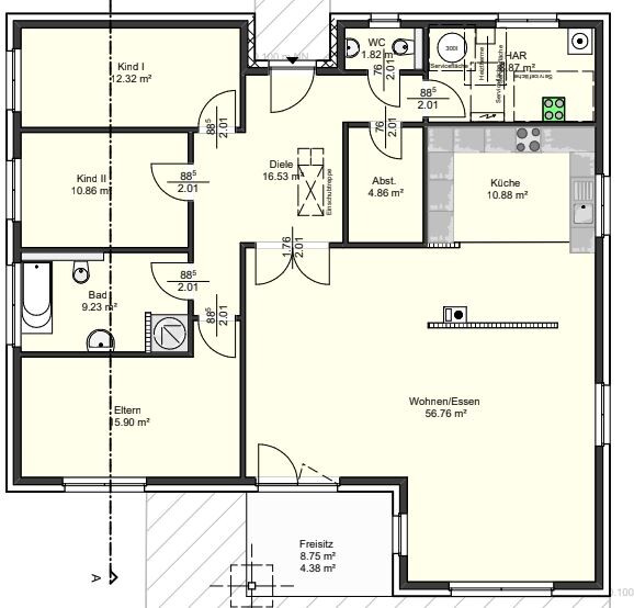

finally, we have reached an important step… the plot is signed for.
We want to build with an architect and already have some ideas about what we like and what we don’t.
We definitely want to give the architect the opportunity to apply their expertise regarding the floor plan… maybe they can convince us.
But if not, we are currently (almost) quite happy with this self-drawn floor plan.
A few key facts…
Plot size: 660 sqm (about 7100 sq ft), floor area ratio 0.4, no slope, approximately 26m x 25m (85 ft x 82 ft)
Longest building side allowed: max. 15m (about 49 ft)
L-shaped bungalow with covered terrace (southwest side)
We want to build with a basement. This should have windows with natural daylight behind the garage on the east side. There will be 2–3 living rooms down there (playroom, hobby room, later for the kids or grandparents if necessary).
The roof will not be converted into a living space — 20-22° (degrees) pitch, hip roof, for aesthetic reasons.
We know that a basement is more expensive than a second floor, etc. The budget is roughly 650,000–700,000 (currency).
Utility room, laundry room, sauna, etc. will all be located in the basement since there is enough space. 🙂
Now to the floor plan:
We like an open design with a large entrance area.
What we like about this floor plan:
Children’s area separated from parents
Connection from the garage with access to the storage room and basement
Access from kitchen and living room to the terrace possible
Master bedroom with direct view of the garden on the southeast side (in summer the shutters are closed anyway)
Children’s rooms with windows facing west, slightly southwest.
Open questions…
Are the children’s rooms too narrow at almost 3m (about 10 ft)?
Is the living room too narrow at almost 4.5m (about 15 ft)?
The L-shape at the terrace is about 3m (10 ft) deep — here we could possibly adjust a bit to enlarge the children’s rooms.
My wife doesn’t like that the kitchen is visible directly from the entrance area.
(I prefer the kitchen visibility over the living room couch). What do you think is better or worse?
The kitchen window is on the south side, possibly too much sun… maybe we should add an awning if needed.
I can’t fit a second toilet elsewhere without making the children’s rooms even smaller… so it will remain a guest toilet for the parents.
Is a door between the entrance area and the living area for a windbreak useful, or unnecessary? (We have underfloor heating.)
(Maybe a hidden interior door, but I’m unsure what happens if it gets damaged.)
The floor area ratio will be tight… 15m x 15m = 225 sqm (about 11,200 sq ft) + garage + driveway… we might need to reduce the width a bit.
660 sqm x 0.4 = 264 sqm (about 2,840 sq ft).
I have seen many floor plans here… wishes and practicality have to match somewhere.
I’m really curious about the experts’ opinions…
Is it rubbish or usable?
Thanks

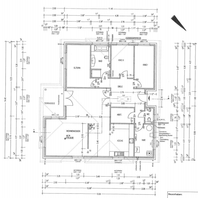

Ah, I love topics about bungalows.
We also have a bungalow (I’m attaching the floor plan). My lessons learned:
1. Separate children’s area: Forget about that in a bungalow! With the single-story design, you’ll never manage to separate it effectively. The rooms are simply within calling distance. And I must admit, especially with young children, I actually love that. My kids learned to play alone in their rooms from as early as one year old because they could see me moving around the house. Plus, there’s the advantage that you can easily call out from the kitchen later on. However, since we don’t want the kids to hear when we’re active in bed, we placed the bathroom in between.
2. In a bungalow, never place the main bathroom within sight of the living room door. When my husband has guests, I want to be able to slip into the bathroom unseen, even in a bra. We weren’t so considerate with the kids’ bathroom, but that was a selfish choice.
3. Basement: I get it, but really consider whether it might be better to finish the attic instead (we have a half-hipped roof). You get storage space, can move a child’s room there if needed, guests can sleep there, and so on. So in the end, you’re basically building a single-family home the classic way. You can separate the upper floor from the rest of the house just like you can a basement.
4. Don’t make the hallway too narrow, but also not too large. In a bungalow, I find the hallway quite important since all paths cross there. I don’t even know how many times a day I walk through the hallway. Since it’s so central, it should also feel “cozy.”
5. With most bungalows, you can remove walls as you like. For example, we don’t have a single load-bearing interior wall. Under the roof, we currently have our storage room and we climb up via a ladder. Once the kids move out, we’ll put in a proper staircase for one room and enlarge the other a bit. Then we’ll have a guest room and a staircase suitable for older age going upstairs. That means, if needed, you can add or move necessary walls and take out unnecessary ones.
I don’t like those maze-like bungalows. This type of house represents closeness and togetherness for me. You see everything, hear everything (to my son’s annoyance: “Mom, how did you know I was secretly watching the tablet?”). You need to want and like that. If you want to separate everything from each other, at least put the children’s rooms upstairs. That might be a bit inconvenient with very young kids, but by age three it’s no problem at all.

Wow, thank you very much for your input...
I actually really like your floor plan... What are the dimensions of the house? Or do you happen to have the floor plan with measurements?
Where is the TV placed in your home? We find 20DN visually interesting... which is why finishing the basement isn’t practical... The floor plan fits our ideas really well... Thanks for that... Do you have a fully covered terrace?
E
Evolith
16 Apr 2021 13:56
I actually like your floor plan a lot... What are the dimensions of the house? Or do you, Event, have the floor plan with measurements?
Where is the TV located in your home? We find the 20DN visually interesting... so an expansion isn’t really practical... The floor plan really fits our ideas quite well... Thanks for that... do you have a fully covered terrace?
Gladly. I have attached the complete plan.
The TV is mounted on the partition wall between the kitchen and living area. A small downside: during the day, the sun shines directly on it. That doesn’t bother me much, but my husband always lowers the roller blind on the large window. A good TV compensates for this quite well.
We initially wanted a low roof pitch. Due to a planning error (a hip roof was not permitted), we had to switch to a clipped hip roof, which required a significantly larger attic conversion. Now I have to say, I like it. We have “headroom” up there, and the house reminds me a bit of the reed-thatched coastal houses I really like.
The terrace is only about one-third covered. However, it is very large, measuring 5x9m (16x30 feet). In front of the bedroom window, we also plan to add a 5x5m (16x16 feet) covered area in the next few years.
What helped us a lot was to see a bungalow from the inside at least once. I still remember my grandparents’ bungalow—typical for the time with an endless hallway and very separated private areas. I always found that quite frustrating. If you ever travel through NRW, feel free to visit us 😉
