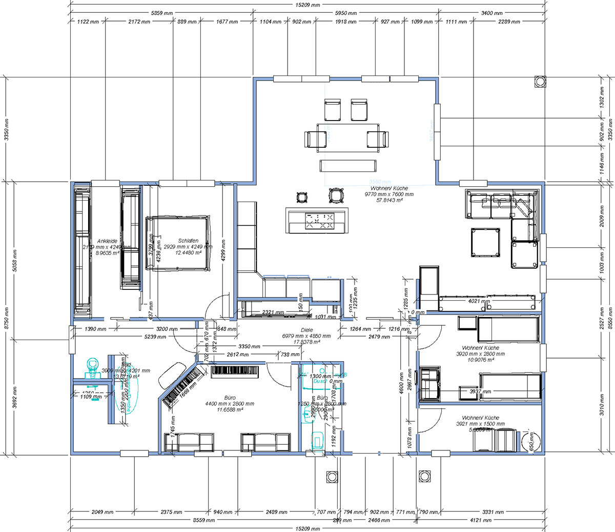

Floor plan is liked, are dimensions according to standards okay? Is the open space structurally feasible? Layout okay? Living area should be max. 140 m² (1,507 sq ft), which was challenging with 4 rooms.
Thanks in advance.

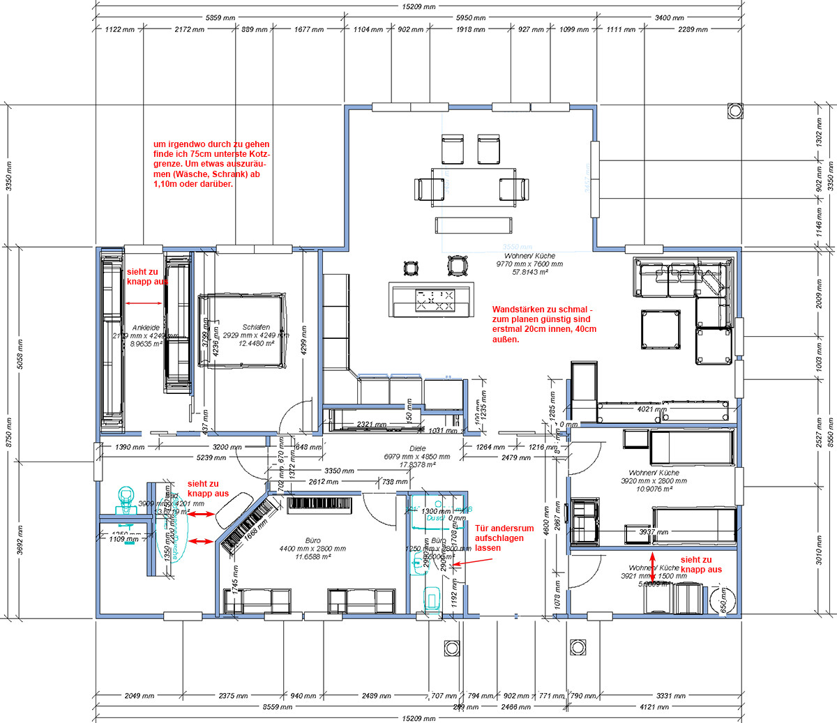

Notes see image.
Unfortunately, I can’t say much about the air space, but I have seen larger ones planned before – so why not?
I would probably remove the sloped ceiling in the office in favor of the bathroom. Maybe place the desks opposite each other in the middle of the office – that creates a really nice office atmosphere.

The program seems to use dimension lines more to confuse than to clarify – you can see distances from the corner of the room to the center of the window, but I couldn’t determine the thickness of the mobile home walls.

Hmm, what does east-west orientation mean? Having a north arrow on the floor plan and a floor plan sketch aligned as closely as possible to true north is always helpful.
4 rooms ...
- Bedroom
- Office
- Guest room?
- Living/Dining/Kitchen?
And adjust the dimensions.
For the kitchen, if the planned side-by-side refrigerator is placed as shown, the fridge section will be positioned inconveniently in relation to the kitchen.
