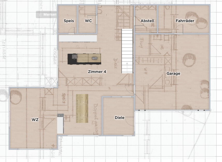

I tried to implement what I had criticized before. Naturally, with all the adjustments, the floor plan looks different. Also, the measurements don’t quite add up for me... if I use the tall cabinets as a reference, nothing fits properly at either end. It’s just a hand drawing, after all 😀 And the plot hasn’t been surveyed, so the sloped boundaries probably restrict it even more.
Still, I want to share the result. Maybe it will inspire some ideas. P.S. I drew the staircase as 1 x 4 meters (3.3 x 13.1 feet), and the table is 2.20 meters (7.2 feet) long.

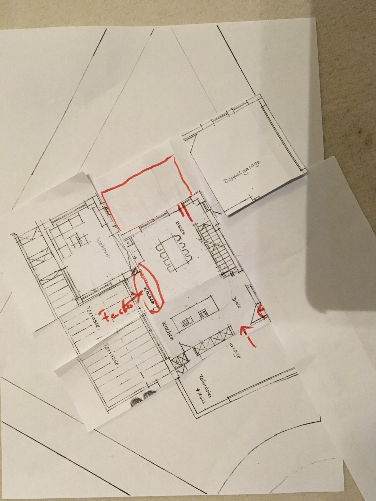

Preliminary remark:
The floor plan, @Jan2806, has sparked spontaneous enthusiasm in quite a few people (myself included). There are very specific reasons for this in the layout, and it’s important to be aware of them so they aren’t lost. For me, these are the points: the “flow” from the kitchen through the dining area to the sunken living room in the quiet rear part of the house – in my opinion, perfect! From the living room, there’s no direct view of pots and pans; there’s a strong connection between living and dining areas, and at the same time, the living room’s identity as a distinct, perceptible space was only established by the sunken floor (definitely keep this). Without the sunken area, the living room wouldn’t feel nearly as excellent. Great terrace layout, the straight staircase fits perfectly and here actually saves space on the ground floor instead of wasting it. No pointless 20m² (215 sq ft) entrance area. Very harmonious connection between ground and upper floors; children’s rooms facing south. Roof terrace accessible via the garage, parents connected via the living room as well. The living room is located on the sloping part of the plot, where a sunken floor is probably a sensible design choice anyway.
I find all of this top quality—it creates a strong “want to live there” feeling. Definitely preserve it.
So why am I writing at all?
Because of the two points raised by [USER=12491]@ypg: the garage acting as an unwelcoming first impression and blocking light, and the dining area receiving only northern light. I can’t say if and how these could be changed without losing the benefits, but regarding these two issues, I would definitely run through the options again with the architect. One you yourself mentioned was narrowing the garage, which helps a little but doesn’t solve the root problem.
A possible approach, described in words:
1. mentally cut off the living room, the dining area and the rest of the house drop about 1.8–2.5m (6–8 ft) down to overlap with the living room. The overlap between living and dining remains but is reduced by half. This creates a new terrace door for the dining area with its own light source.
2. if possible, shift the right-side service areas (storage/toilet) into the new open space north of the dining area = east of the living room. Then there would be room on the east side (right side on the plan) of the house for a garage (its size is hard to estimate since no dimensions are provided).
A rough cut-out exercise as a photo, with the living room and terrace in their original positions; entrance with cloakroom in the southeast still needs to be added…
