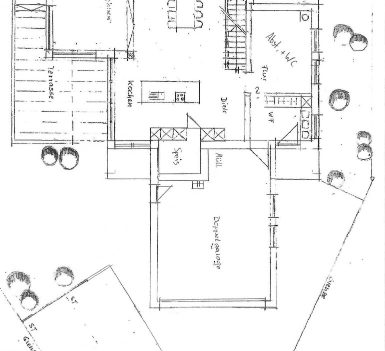

This year we purchased a plot in a new development area and have been planning our house since then.
We have already revised the preliminary draft from our architect several times, and before we proceed towards obtaining the building permit / planning permission, we would like to gather opinions and suggestions for improvements from this great forum.
Plot size: 593m² (6369 ft²) (potentially we can use an additional 100m² (1076 ft²) on the north side from the municipality, but not build on it)
Slope: no (however, the land slopes steeply down behind the plot)
Site coverage ratio: 0.35

- individual wishes realized, e.g., as open a ground floor as possible
- since the plot slopes slightly to the north, we wanted a second "level" (we are aware this is not age-friendly). This was implemented in the living room (as shown in the example image). There are also stairs in the garden, and the basement windows correspondingly receive natural light.
What have we overlooked?
Or, what do you think is not planned sensibly?
Thank you 🙂

I wouldn’t recommend having steps in the living room. While age is one factor, even when you’re young, illness or accidents can suddenly mean you or a child need a wheelchair. That becomes really inconvenient. My daughter’s best friend is now in a wheelchair after an accident. Their family lives in a split-level house and now has to look for something else.
Regarding the fireplace: we live in a KfW 75 house. We absolutely don’t need a fireplace. But we do get smoke from neighbors. I don’t understand why almost everyone builds with wood stoves nowadays. There is a "worst-case scenario" argument against every idea; thousands of other things can happen in life. I prepare for one case, and another one occurs...
The original poster is young, looking ahead positively, and wants to build a beautiful house. It will probably be a beautiful house.
At 60, I’m building again with stairs in the open-plan living area and a fireplace.
Similar to @ypg... because, in my opinion, it looks stylish and I’ll enjoy it every day.
If it eventually doesn’t work out as well, we’ll have to manage... and make decisions... that’s life.
We still need to carefully consider the shower on the ground floor. Waiting in line for the bathroom in the morning can definitely be annoying.
We won’t be making any changes to the steps leading into the living room; combined with the fireplace, it’s meant to be a highlight of the house.
As I said, you never know what life will bring, but it’s "only" the living room after all.
I just made some adjustments to the garage using Paint and a pencil. This would at least bring in a bit more light from the south into the kitchen area. Of course, there would be less space in front of the garage, but I’d be willing to make that compromise. We still have parking spaces available. What do you think? 🙂
The vestibule, WC, and other areas would still need to be adjusted accordingly.
pagoni202021 Dec 2020 08:42Jan2806 schrieb:
We still need to carefully consider having a shower on the ground floor. Waiting in line for the bathroom in the morning can definitely be annoying.I would recommend this from personal experience—I would also put it in the basement, even if in a simple and inexpensive way. Many things actually change as children grow older (including yourself) and their lifestyle. Sometimes children don’t get along well, have guests, one is sick and needs space, and another urgently has to leave, etc. It simply offers more privacy and brings peace to the house. There are two of us, and even we have two bathrooms—one for her and one for him (without a bathtub); this isn’t strictly necessary, but depending on the daily routine, it’s comfortable. You also change over time, and suddenly you prefer to sleep in the guest room because someone snores or the other person goes to bed two hours later. These are things you can’t foresee but can react to if you have planned accordingly.We used to have a family bathroom and a shower bathroom in the basement. At our first renovation, we changed that and split the family bathroom into two; the smaller part became an en suite bathroom with shower and washbasin accessible from the bedroom.
Since you have an office in the basement, I would also at least consider providing a bathroom there if possible, because the use of that space can change over time. The layout would allow this since the rooms are stacked.
When we were 30 with two children, we didn’t really plan ahead much, which is why we had to make several changes later; it’s always more difficult with wet rooms.
pagoni202021 Dec 2020 08:44Jan2806 schrieb:
We won’t make any more changes to the steps leading into the living room. Together with the fireplace, this should be a highlight of the house.Exactly, I see it the same way!Jan2806 schrieb:
We still really need to think about the shower on the ground floor.Please! 🙂Similar topics
