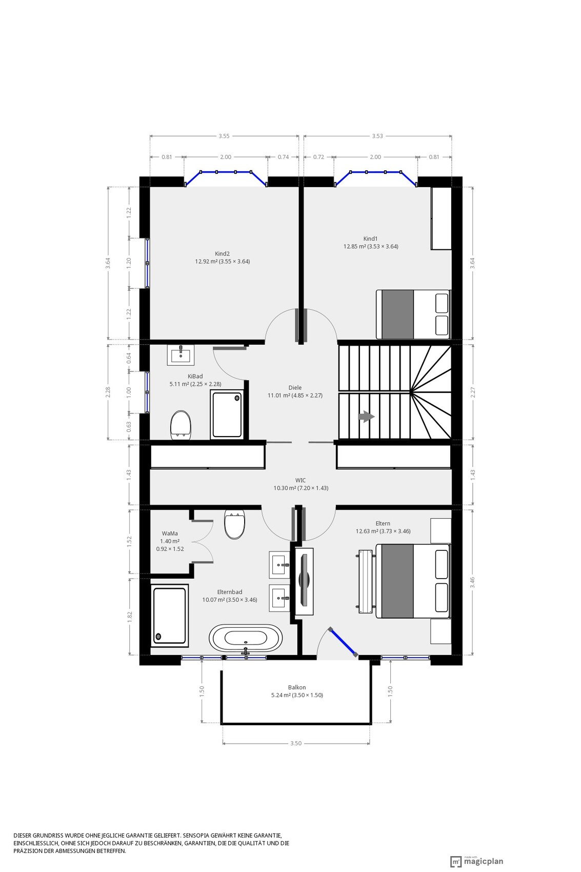

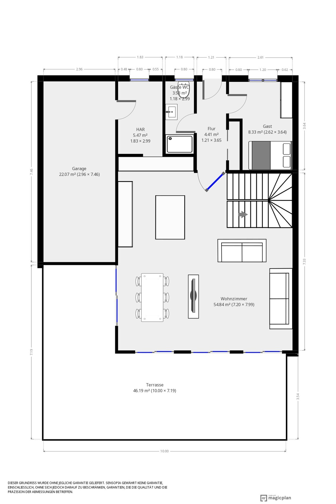

What do you like most? Why?
- Garage access through utility room
- Few hallway areas but still with a wardrobe
- Open living concept and straight staircase (platform stairs couldn’t be depicted)
- Separate bathroom for kids
- Spacious walk-in closet
- Laundry room on upper floor
- Access through bedroom/bath to walk-in closet
What don’t you like? Why?
- No pantry on the ground floor
- Kids’ rooms on the north side
- Having to enter the parents’ walk-in closet first – would prefer two wall closets like houses in America
- Upper floor hallway very narrow and access to kids’ room 1 hardly feasible – on the other hand, I don’t like wasted space and enlarging the hallway would reduce kids’ room sizes. Any solutions?
- I find the garage quite practical but it takes away window area – will the ground floor be too dark, and should we rather go with a carport?
Why did the design turn out as it is now?
We wanted an open floor plan because we have a lot of visitors, and I always find it a shame to disappear into the kitchen while everything is happening in the living area. It was also important for us to have a separate parents’ area for complete privacy and a balcony for drying laundry in summer. A guest shower on the ground floor was needed, and it is important to me to do laundry on the upper floor (where the laundry is generated).
- General opinion on the floor plan
- See “what I don’t like” – suggestions for improvements welcome
Note:
The windows are just placed approximately. I also don’t know how to view the exterior – of course, we will position the windows accordingly.
saralina8728 Apr 2020 14:42A small pantry could theoretically fit under the stairs, which is how we are doing it now. We are building with similar dimensions.
Are you sure there is enough space for the utility room?
What you need to consider: very quickly, many people will be asking for storage space here – have you thought about that?
Curly schrieb:
How is it supposed to work in the living room with the cables for the TV, game consoles, DVD player, etc., and how does it look from the dining table?
Sabine Thanks for your question.
We were thinking of a wall about 1.80 m (6 feet) wide with a ceiling height that includes a fireplace and the TV—a kind of room divider.
But it’s not a must—we could also place the TV on the opposite wall if necessary. However, we quite like the idea of creating a small separation between the areas that still feels open.
saralina87 schrieb:
A small pantry could theoretically fit under the stairs, that's how we are doing it now. We are building with similar dimensions.
Are you sure the space for the utility room is sufficient?
What you should expect: very soon, many people will be asking for more storage space – have you thought about that? Yes, there should also be a storage room under the stairs, forgot to mention that. But I would also like to have something exclusively for food supplies.
Do you have your floor plan ready?
Although it probably won’t help us much, as the semi-detached house setup is rather complicated for us. If we were building a detached house, we probably would have chosen a side entrance.
I’d still be interested, maybe I can get some ideas.
And yes, you are definitely right about that – which is why I would prefer the garage, solely for additional storage space.
Regarding the technical room: yes, it should be enough, since it will only house the technical equipment, no storage or laundry area etc.
