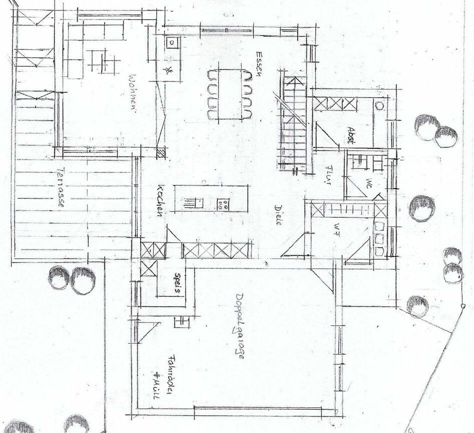

Jan2806Hello everyone,
This year we purchased a plot in a new development area and have been planning our house since then.
We have already revised the preliminary draft from our architect several times, and before we proceed towards obtaining the building permit / planning permission, we would like to gather opinions and suggestions for improvements from this great forum.

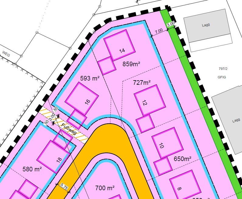

Plot size: 593m² (6369 ft²) (potentially we can use an additional 100m² (1076 ft²) on the north side from the municipality, but not build on it)
Slope: no (however, the land slopes steeply down behind the plot)
Site coverage ratio: 0.35
Floor area ratio
Edge development
Number of parking spaces: two per housing unit
Number of stories: max. two full floors
Roof style: free choice
Architectural style: free choice
Orientation
Maximum heights / limits: max. 6.5m (21 ft 4 in) building height with flat roof
Additional requirements
Architectural style, roof form, building type: modern, flat roof
Basement, floors: two floors + basement
Number of occupants, ages: two adults in early 30s and two children
Office: family use or home office: home office necessary about 2 days per week
Guest bedrooms per year
Open or closed architecture: ground floor open plan
Open kitchen, cooking island: yes
Number of dining seats
Fireplace: yes
Music / stereo wall
Balcony, roof terrace: yes
Other wishes/features/daily routine, also reasons why some options are included or excluded
Planning by: architect (preliminary draft)
Cost estimate according to architect/planner: construction costs approx. 500,000€
Personal budget limit for house including fittings: 600,000€
If you had to give up, which details/finishes
- could you give up:
- could not give up:
Why is the design the way it is now?, for example:
- individual wishes realized, e.g., as open a ground floor as possible
- since the plot slopes slightly to the north, we wanted a second "level" (we are aware this is not age-friendly). This was implemented in the living room (as shown in the example image). There are also stairs in the garden, and the basement windows correspondingly receive natural light.
What have we overlooked?
Or, what do you think is not planned sensibly?
Thank you 🙂

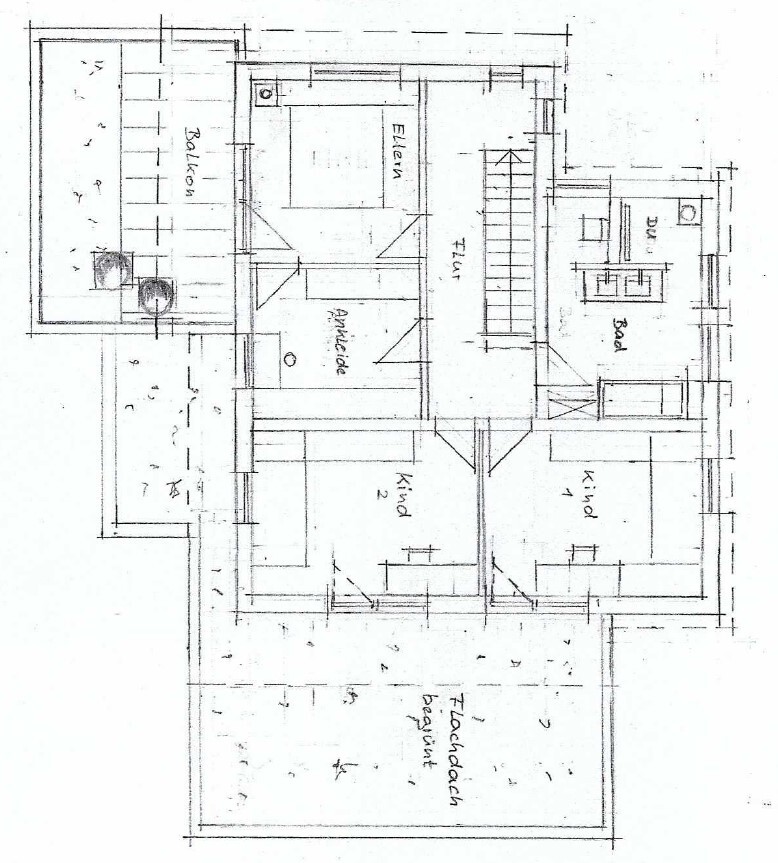

I like it too 🙂 I’m just not so keen on the master bedroom. If I’m not mistaken (I’m really not sure), then the headboard of the bed with the lettering is there, right? That means the person sleeping by the window can’t pass by the chimney flue? Maybe it would be enough to leave out the door to the hallway there..
I think it’s okay as well.

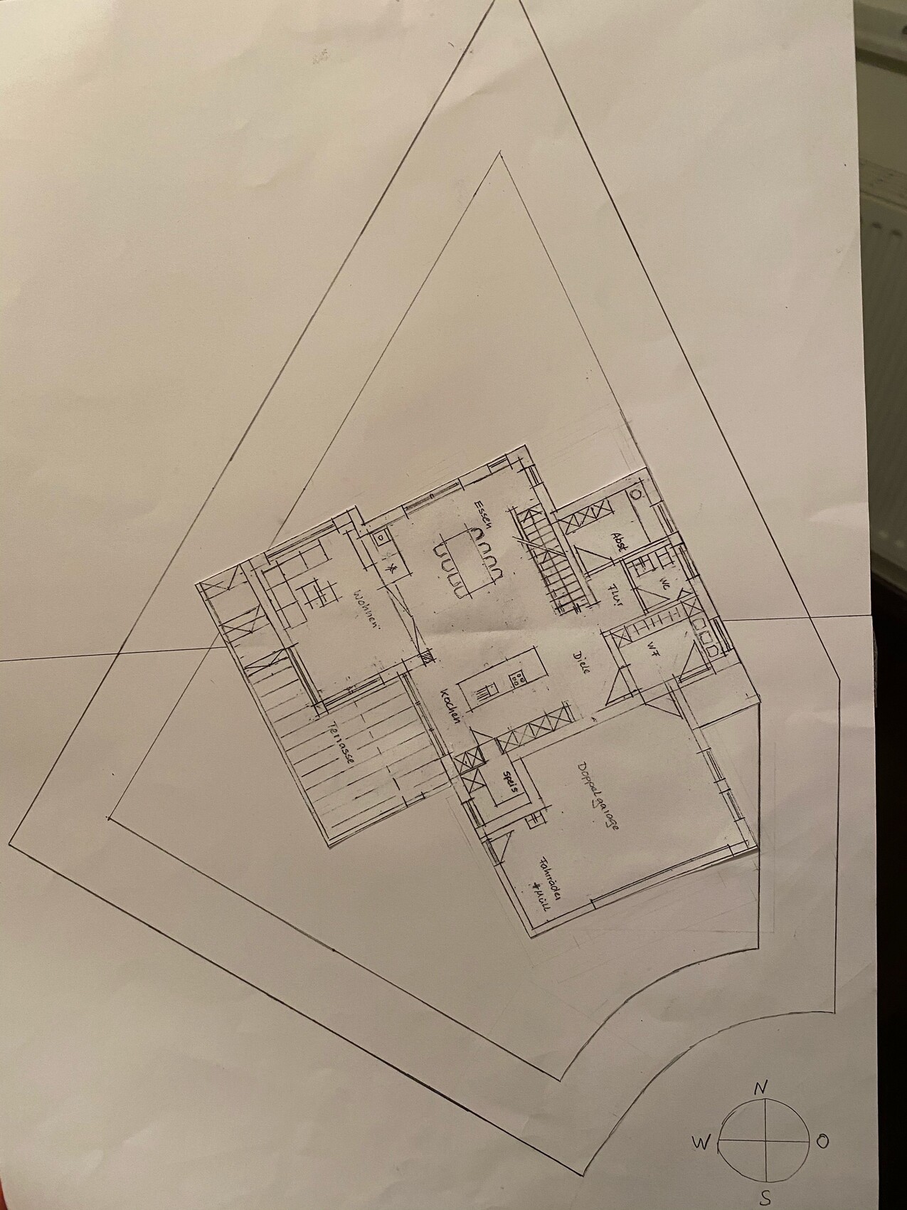

However, I definitely wouldn’t build it like that and place the garage on the south side of the house, which blocks many necessary windows.
Is there a reason why the garage wasn’t positioned as a boundary wall on the east side, so that there would at least be a south-facing window in the dining area?
By the way: I would move the door to the bathroom closer to the storage room, so that you don’t look directly at the toilet from the dining area. I mean more like mirror the layout of the room.
