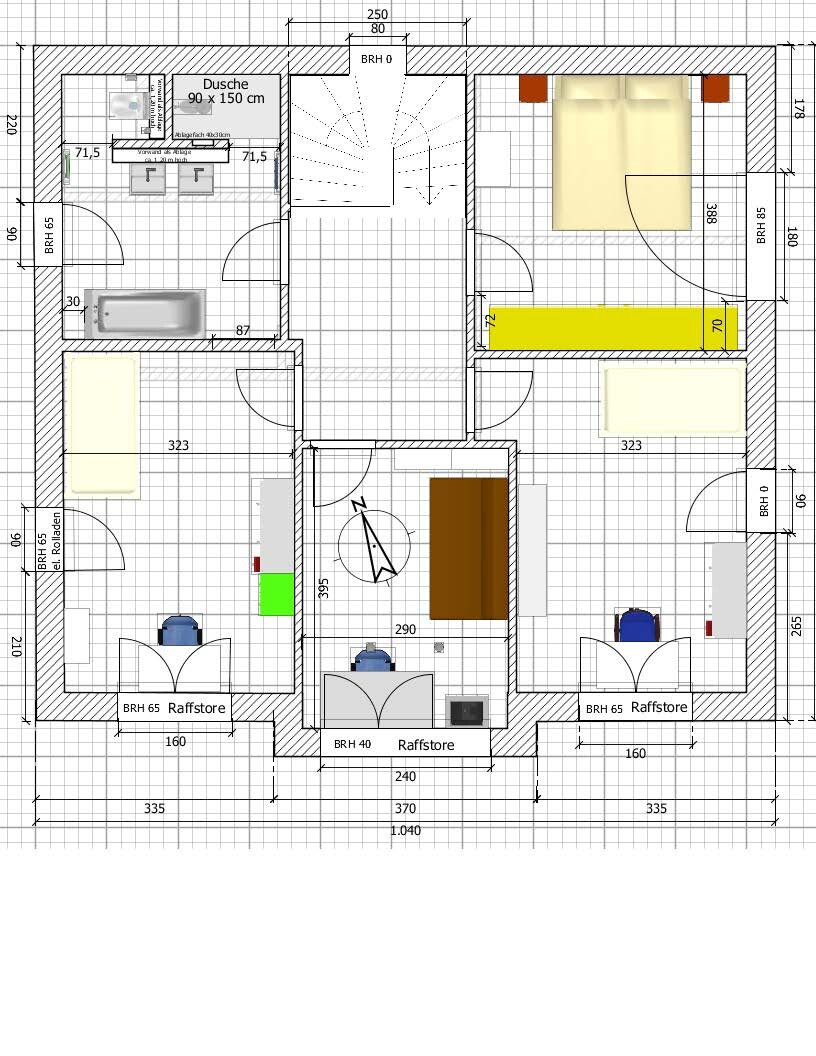

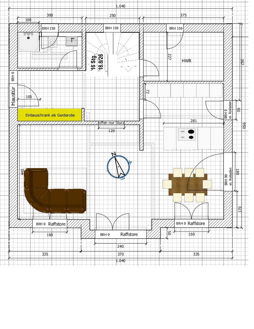

We have created the following floor plans. Do you see any potential for improvement or even major mistakes/misplanning in these layouts?

What do you particularly like? Spacious ground floor, large children’s rooms, large entrance area

kaho674 schrieb:
Sure, having an open space is nice, but with two kids who want to sleep while Mom and Dad are still watching TV, it’s always a problem.
Yes, in that case the children need to learn to sleep through noise downstairs. The sound transmission in open-plan houses is definitely a disadvantage. I came to this conclusion because there was no door planned before either, and then I thought "all or nothing"...
Also, the structural engineering for such an open room is not simple, and with standard ceiling heights, large rooms rarely look impressive.
11 Jun 2019 18:33
The offset alignment from the entrance to the door or an open corner is “not ideal.”
Why not swap the living room and kitchen and move the entrance to the open-plan area somewhere else? For example, the wardrobe could be placed opposite the staircase.
However, I would say that the staircase, in this cost-saving design, is not suitable for adding access to the utility room there. Also, the space under the stairs is needed to create a storage room.
Why is the utility room located “all the way back” there? Doesn’t that cause long distances for the supply lines?

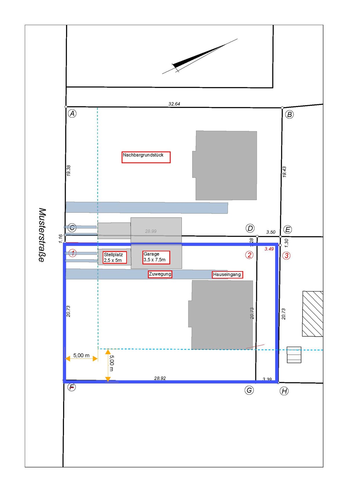

This can only be answered in connection with the overall property, garage or carport, and street connection, so please upload the site plan with the house drawn in, @bafische.

I won’t say anything without the site plan!
Because something doesn’t add up (living room as a passageway with a massive area, while no storage is available). To evaluate that, the site plan must be provided.
Nobody benefits from a living room door opposite the stairs – it would be different if the dining area were opened up.
attached is the site plan.
All utility connections (electricity, water/sewage) are located at point "B," which is the northeast corner of the plot, so the technical room is placed here, only 5m (16 feet) from all utilities.
There is no living room door opposite the stairs; there is only an opening with a lintel planned here.
Storage space consists of the garage/attic/wardrobe cupboard/laundry room and a large built-in wardrobe in the bedroom. I know storage space is always too little, but we currently have a 55sqm (592 sq ft) full basement filled to the top with stuff that hasn’t been touched in the last 10 years. That’s why our floor plan is not optimized for storage. However, we have carefully considered how much storage we actually need.

Please do not make the placement of the house on the plot part of this discussion; this is solely about the floor plan given the location and orientation of the house. Everything inside can still be changed. The circumstances are so varied that explaining them here would go beyond the scope.
Site plan of the plot showing property boundaries, building outlines, and planning lines.
Site plan of the property with garage, parking space, driveway, and house entrance on Musterstraße

kaho674 schrieb:

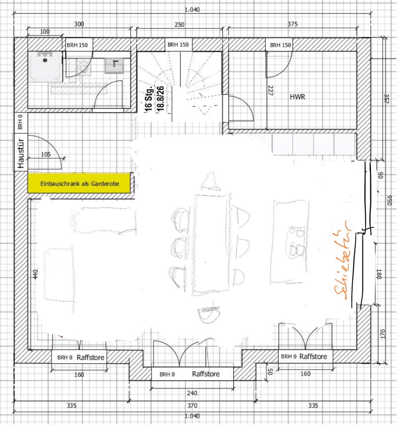

I think it’s quite okay. I would convert the kitchen door into a sliding door.
If the site plan from 11ant's link is correct, I find the garage really annoying. I don’t think I would attach it to the house but rather place it alone by the street. That would also allow for a living room window on the west side.
What about the utility room door under the stairs? Have you calculated the exact heights to make sure it fits? How wide is the door?
The elevations probably need to be refined.
Hi Kaho,
we also found the garage really annoying there, and having a window on the west side is definitely on our list.
The utility room door has been calculated; a 90cm (35 inch) wide and 2.13m (7 ft) high door fits underneath—just like all the other interior doors.
A sliding door for the kitchen has already been requested; it makes a lot of sense here.
We considered boxing in the area under the stairs but it looked rather poor in the simulation.
Which elevations do you mean? Windows? Which side?

hampshire schrieb:
This is a common misconception. Geometrically, you maximize the area for the same perimeter by making the shape square. In practice, however, this only creates unused space inside the house – see the living room entrance and hallway above. You definitely won’t gain any usable space that way.
I tend to think radically open, removing all walls to the kitchen and living room, leaving only the cloakroom. I place the dining table centrally and reorganize the kitchen... this creates a very special living area where the table becomes the heart of the home. Not for everyone, but an option for a family that spends a lot of time together.
Hampshire,
nice and calm, but we still can’t imagine a fully open concept.
The kitchen should at least be somewhat set back.
Open is great, but for our taste, by giving up the living room doors and opting for a semi-open living-dining area, we have already taken quite a risk.
Thanks for your suggestion.
